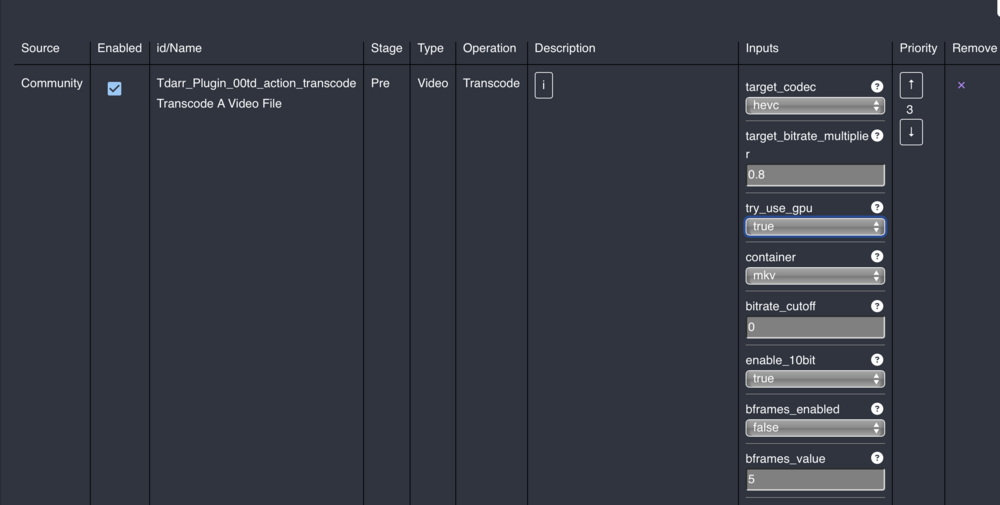

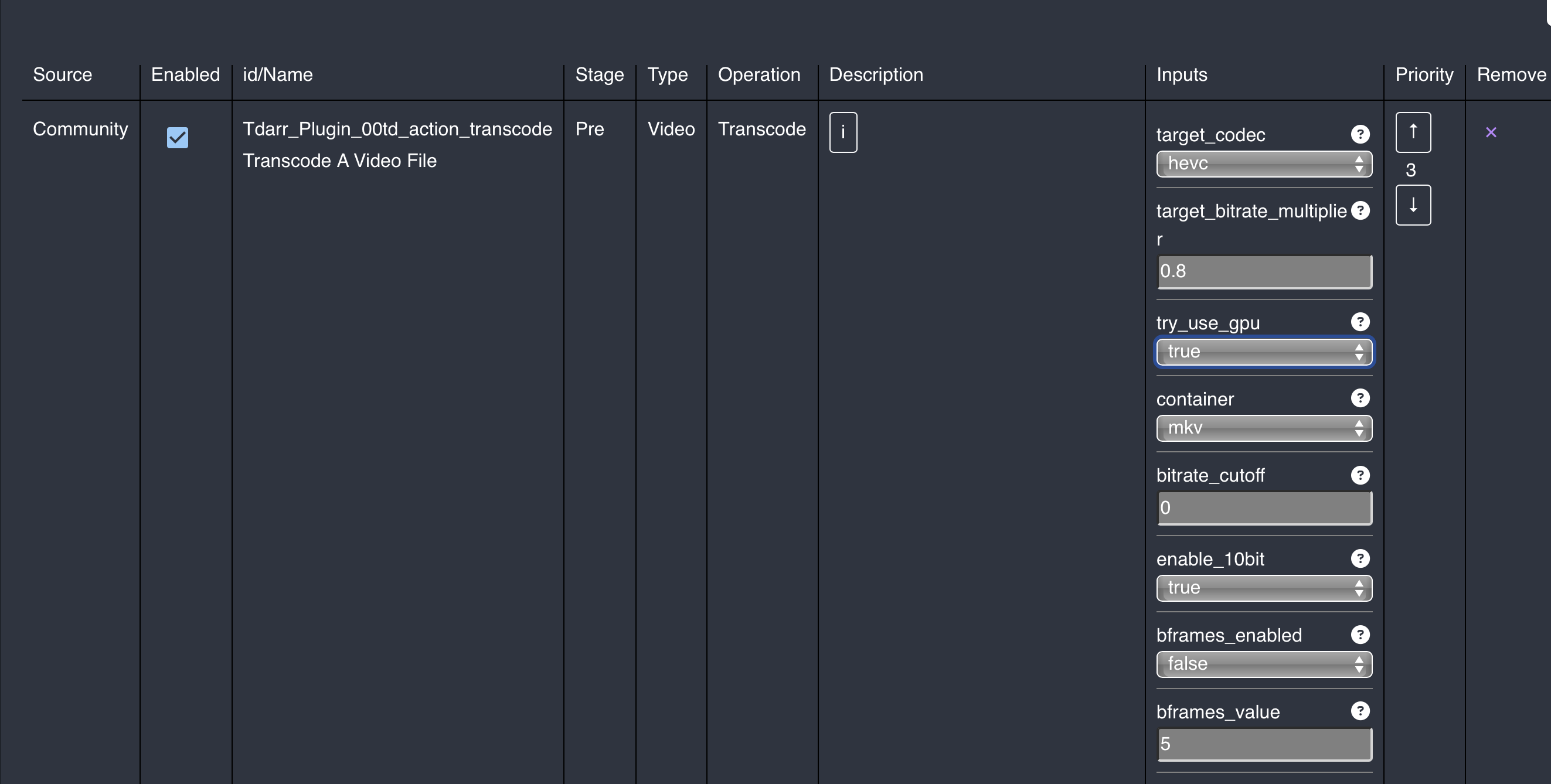

  2. I have two Samsung TVs, a newer model that can directy play pretty much everything 4k Dolby Vision with DTS. However the older model (from 2019-2020) while 4k, can't direct play most with DTS, TrueHD, DV and some HDR. I've see up a container with Tdarr and its corresponding node. Created a library pointing to a movie folder (just for testing) and set up this transcode plugin. When I scan the library the file gets checked but it says conditions are met. Whats conditions? Isn't this supposed to force transcoding? Then I tried another plugin with the same results. I've got to say this is all very new to me and I'm not familiar with tdarr and its plugins.

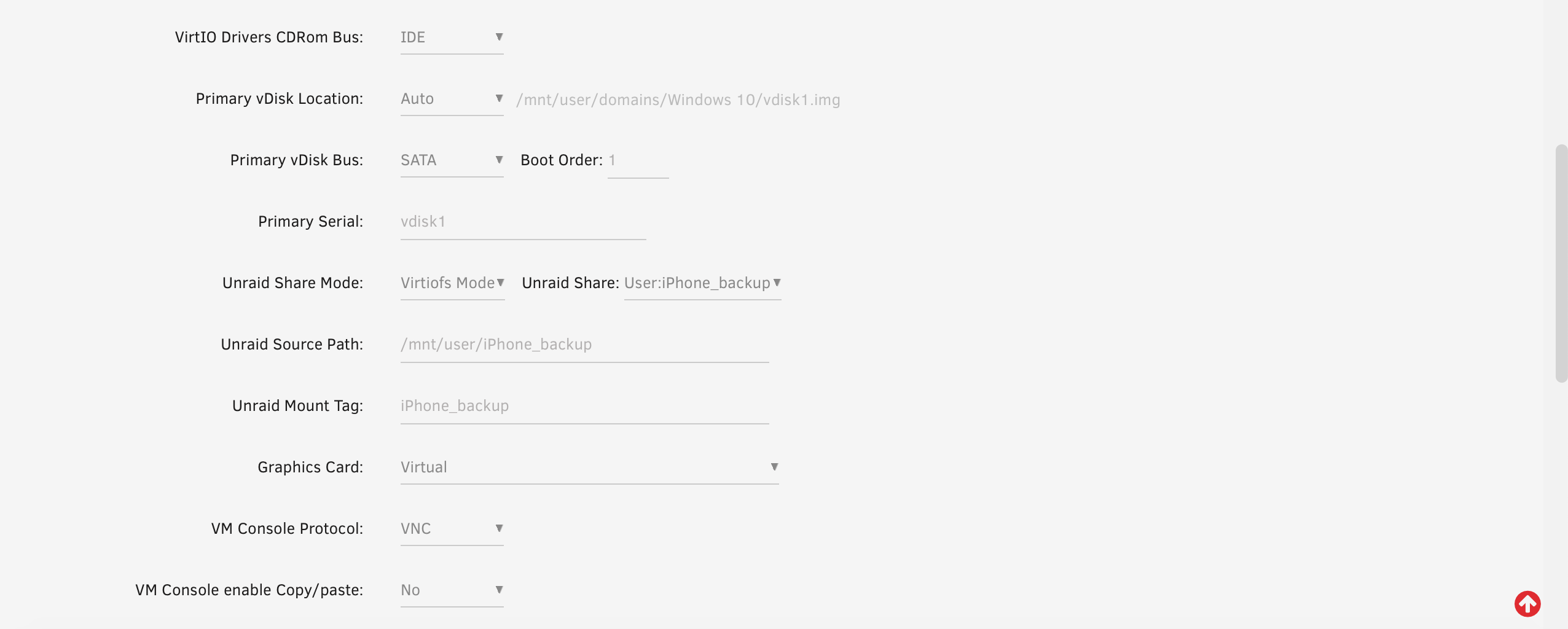

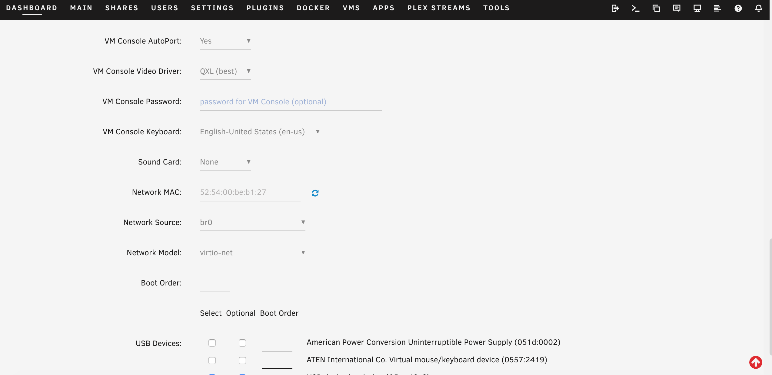

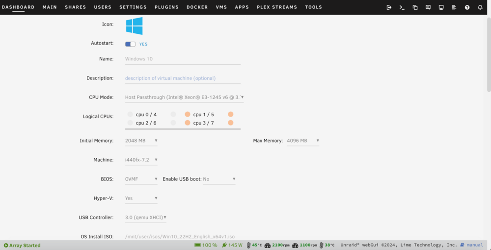

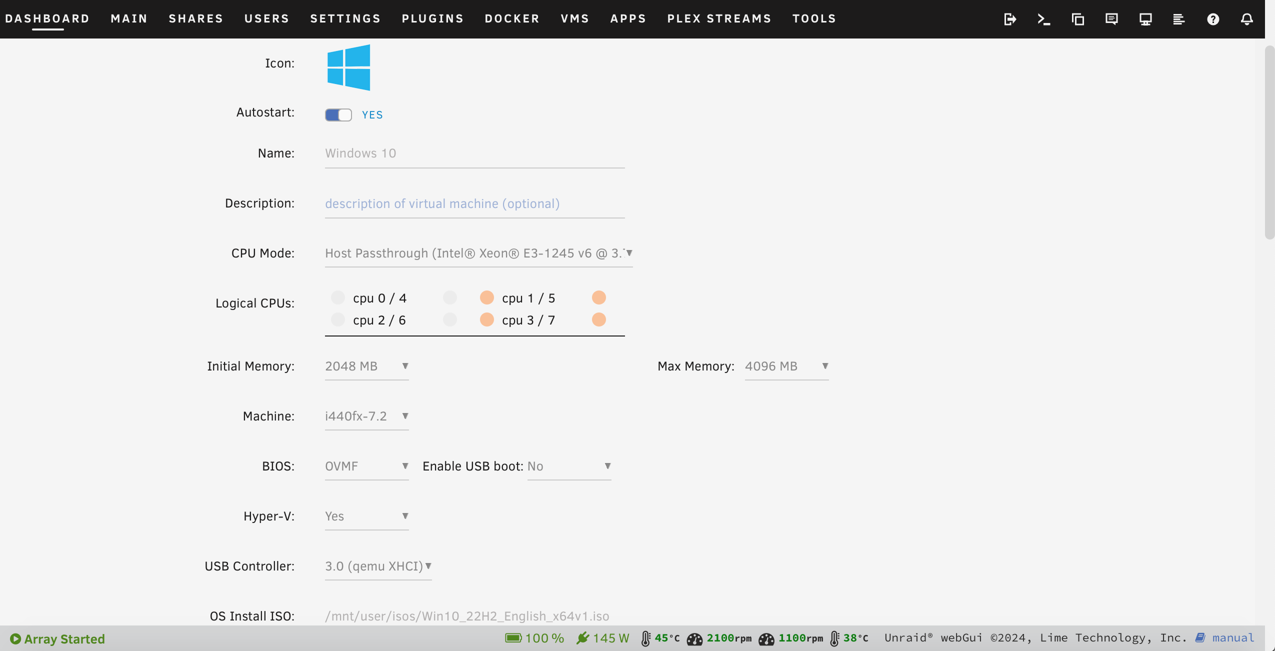

  13. A few days ago I set up a Win10 VM for iTunes backup purposes. The VM settings followed the configuration in the first post (pinning cpu cores, pairs for hyperthreading and not using the first two). 4GB of ram and vdisk on my cache SSD. After all of this I still find that the VM is extremely slow to use, almost unusable. I don't know what else to tweak because it seems like the configuration ticks all the boxes for usable performance.
