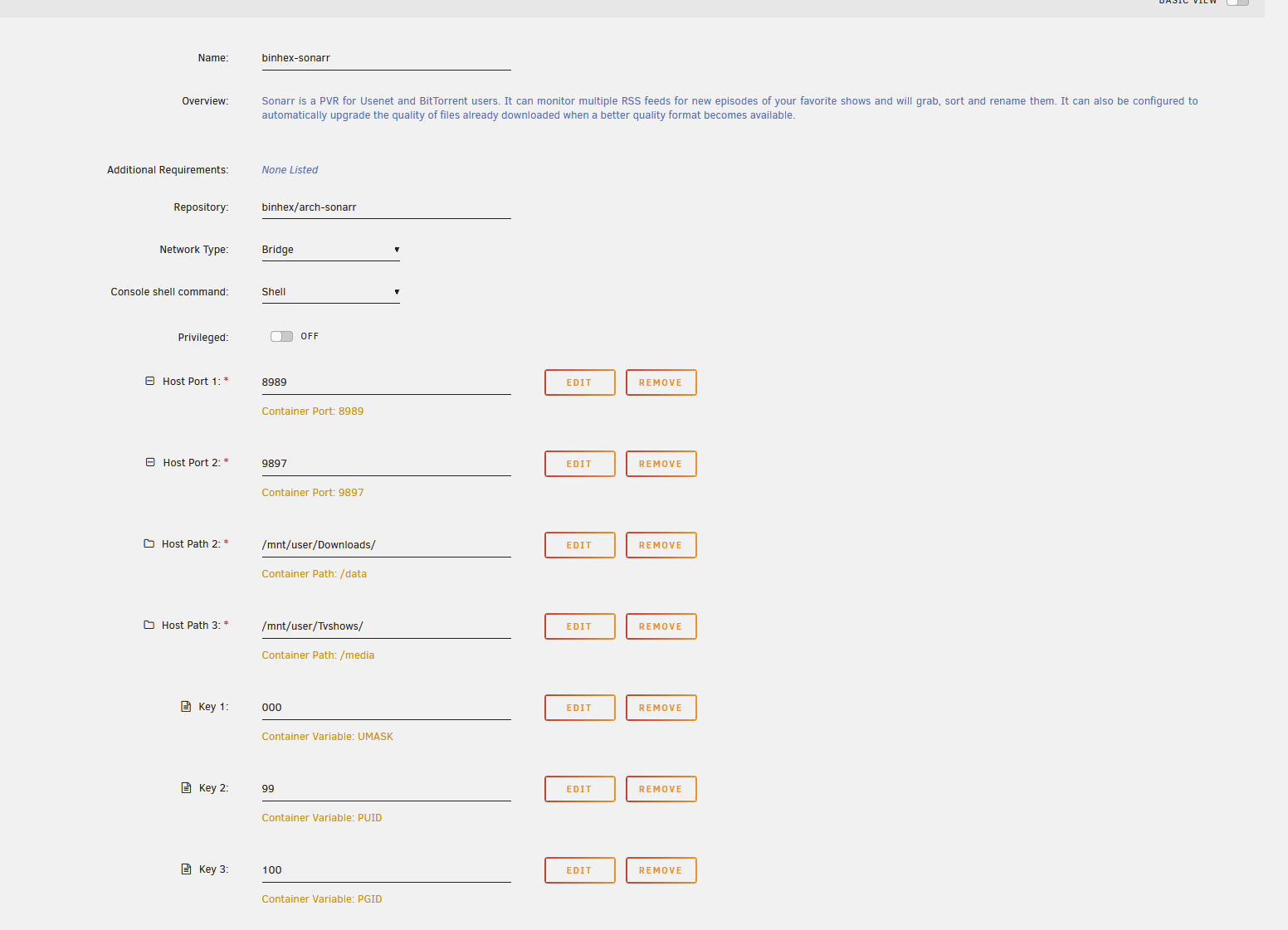

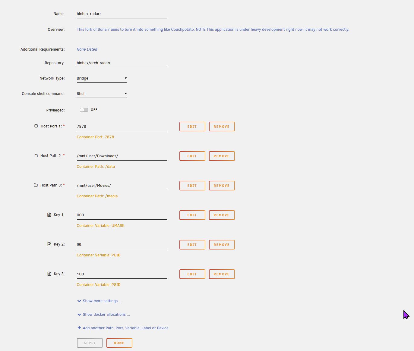

  8. Please see the images below of my radar and sonarr config.

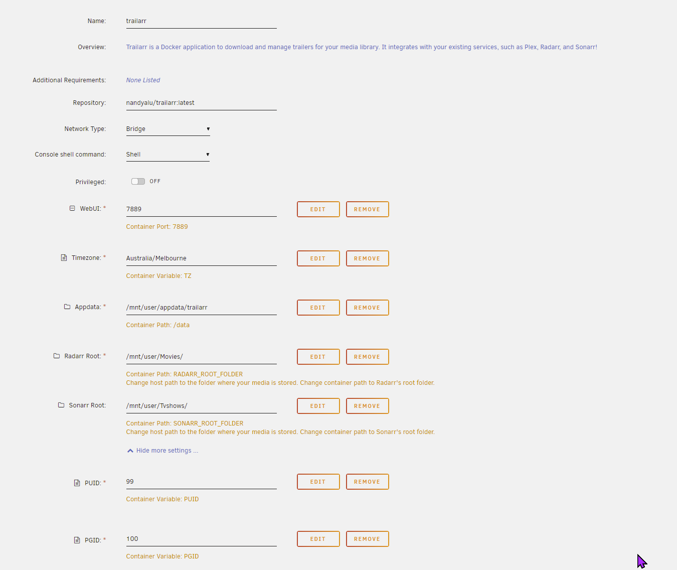

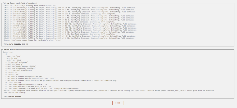

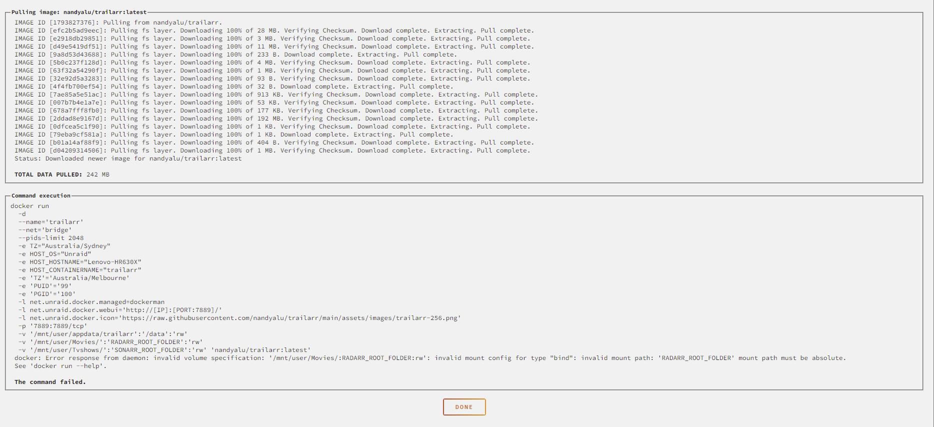

  9. I blew the entire installation away and now it wont install. I suspect the template is borked. Ill try rebooting the server and if I cant install it then I give up and will move onto something else. thanks for the help. *edit* Even after a reboot its still cactus.

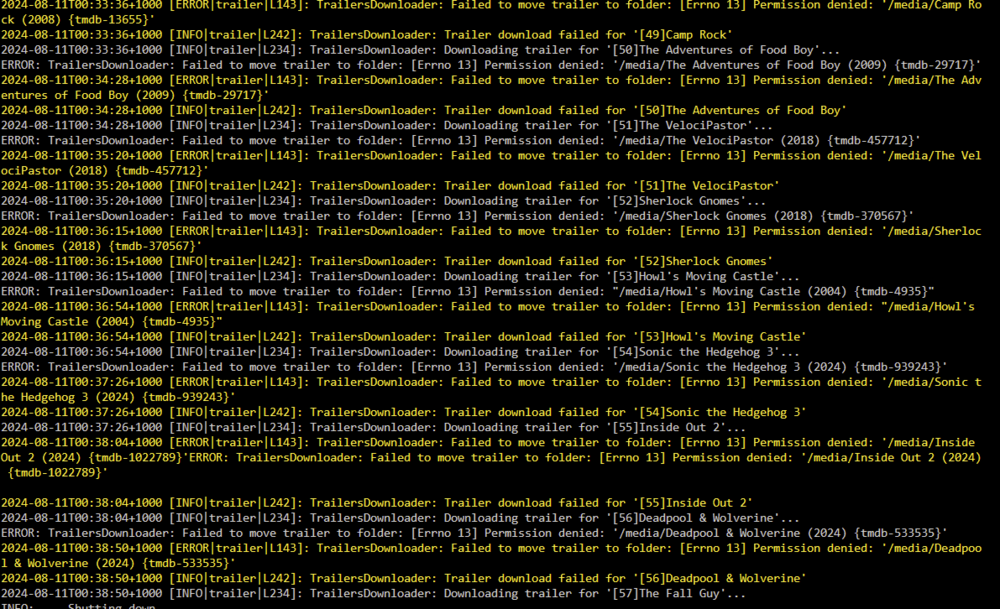

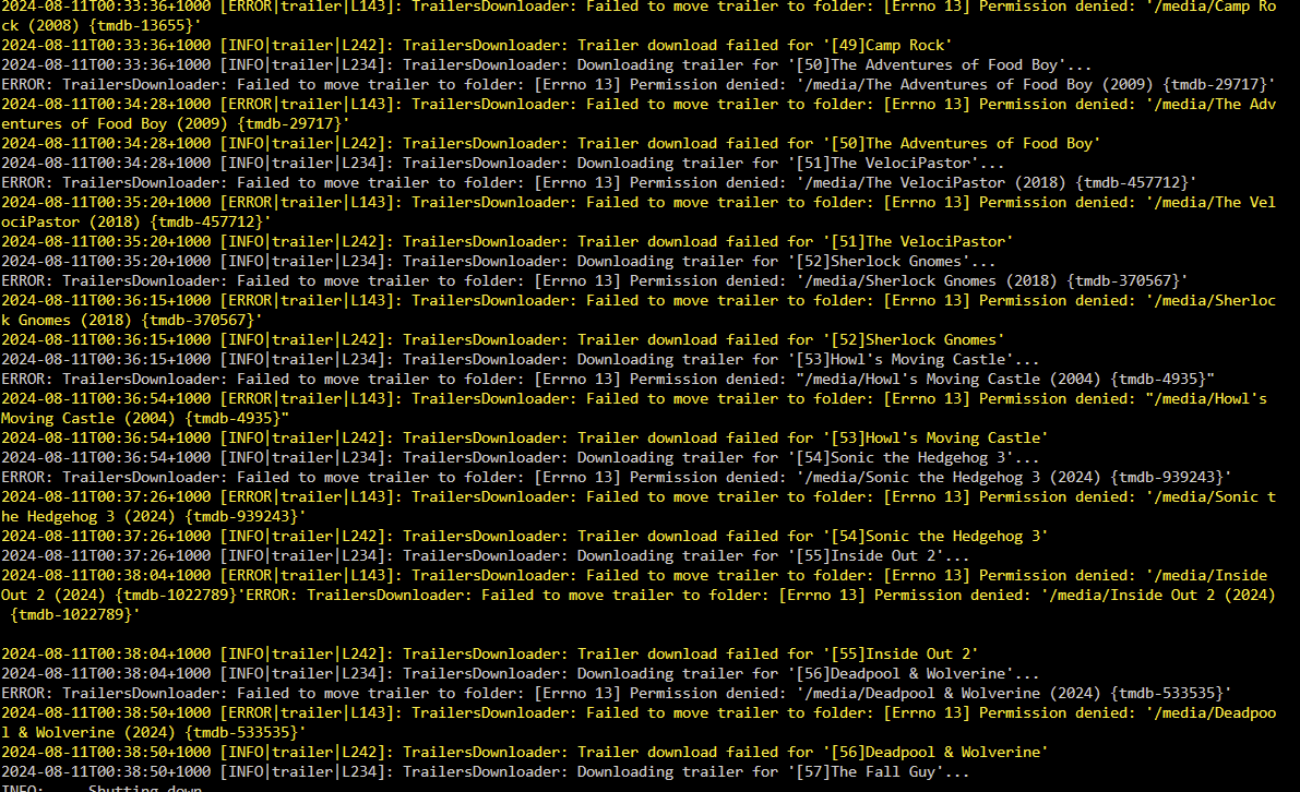

  10. I am having a bit of trouble with the Trailarr container. my Sonarr and Radarr paths are set to /mnt/user/Tvshows/ /mnt/user/Movies/ which ive set in the Trailarr Container, I can access the share and have read/write permissions into the share, but Trailarr is giving the following errors on permissions. (see Image below) Command executiondocker run -d --name='trailarr' --net='bridge' --pids-limit 2048 -e TZ="Australia/Sydney" -e HOST_OS="Unraid" -e HOST_HOSTNAME="Lenovo-HR630X" -e HOST_CONTAINERNAME="trailarr" -e 'TZ'='Australia/Melbourne' -l net.unraid.docker.managed=dockerman -l net.unraid.docker.webui='http://[IP]:[PORT:7889]/' -l net.unraid.docker.icon='https://raw.githubusercontent.com/nandyalu/trailarr/main/assets/images/trailarr-256.png' -p '7889:7889/tcp' -v '/mnt/user/appdata/trailarr':'/data':'rw' -v '/mnt/user/Movies/':'/data/media/movies':'rw' -v '/mnt/user/Tvshows/':'/data/media/tv':'rw' 'nandyalu/trailarr:latest' 8482fd37d378e6ff926f8a02859ed2ac6db89bc9c194940d2b673a1e14837e2a I have no doubt that I've made a mistake along the way due to my own ineptitude, if you could point it out, that would be props
