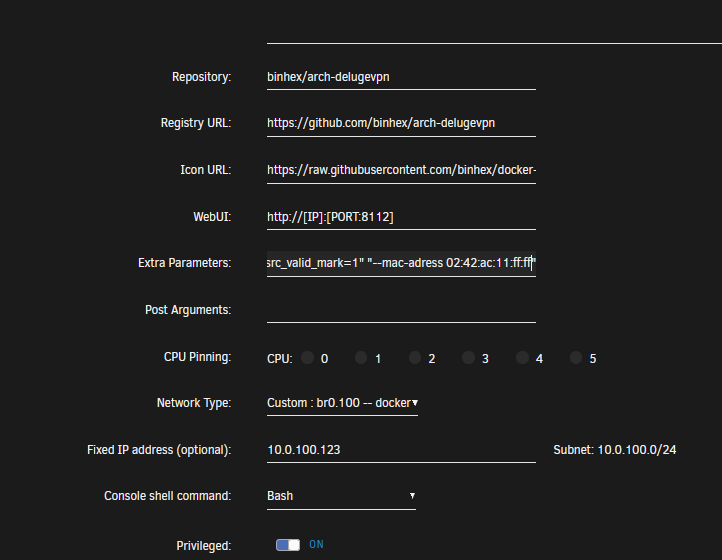

  5. Hi I run my dockers on a separate vlan (100). I can ping these from any computer i.e. ping 10.0.100.200. But they are not showing up in my unifi controller. This controller is running on a UDM pro so not on unraid (docker) itself. I was thinking it maybe had to do because of an invalid mac address so i tried to add it in the extra parameter part of the contrianer. However as soon as i add this the contrainer breaks. Any idea?

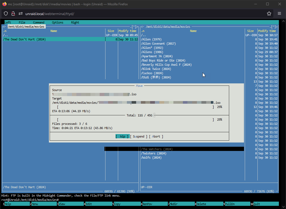

  6. Yes it is. But no parity.
  7. Using mc it is not really faster. Weird. Although it is a slightly older drive i was hoping/suspecting this should go way faster. this is using the "renmove" command inside mc.
  8. alright ill give it a try. "DFM does a copy, then remove" is this a safety precaution i assume?

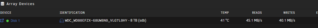

  9. In cli for example? mv /mnt/disk1/folder1 /mny/disk/folder2
