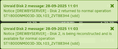

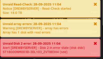

So i replaced the cable. When i followed the steps, first thing it says is "" which looked promising but then it immediately paused. When i clicked unpause, it then showed the previous error" " and now no longer says data rebuild but just read-check in progress". last time it did a read-check, i ended up in the same spot i did before. Attached are the diags. Please let me know what would be the next step. i appreciate the help drewbyserver-diagnostics-20250928-1104.zip
