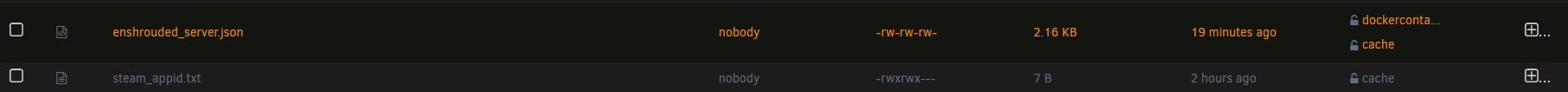

  4. Hmm, im having a few problems after the water update. Long story short i had a version mismatch issue and the server refused to update, i gave up on it almost entirely and just nuked my server and made a fresh one. However, i now have my new server, and the game loads in, fresh new world, no issues. However, i cannot seem to adjust any game settings. I am using unraid and i have tried to update the config file direction, i go to /user/appdata/enshrouded_proton and then edit the enshrouded_server.json directly. To do this i had to use the unraid ui, download the JSON file, edit in my editor, change the values, make sure the server is off, then delete the JSON on the server and upload onto it my edited version. I do this process and boot the server back up, everything is working however none of the changes i made to the json file worked. I even tried going through unraid itself and setting a variable to enable text chat, which i probably did wrong but this also did not work. b Any idea what im doing wrong here that would cause enshrouded to not read my JSON file that i edited? It didn't create another one, the only json file is the one i sent, but it does not want to read from it and retains all the default settings. Here is the json i sent with passwords and details edited from the original text.enshrouded_serverEXAMPLE.json I've also included a screenshot of the permissions menu as well, which appear fine to me. Any idea what im doing wrong here? server runs, game plays, things are golden, but i can't change a single setting for some reason. We are running on default user names and passwords because it won't accept any changes i make to the JSON. What gives?
