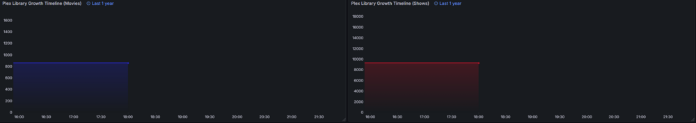

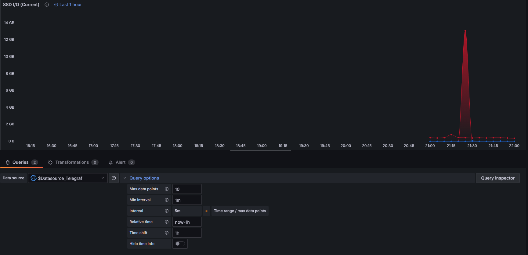

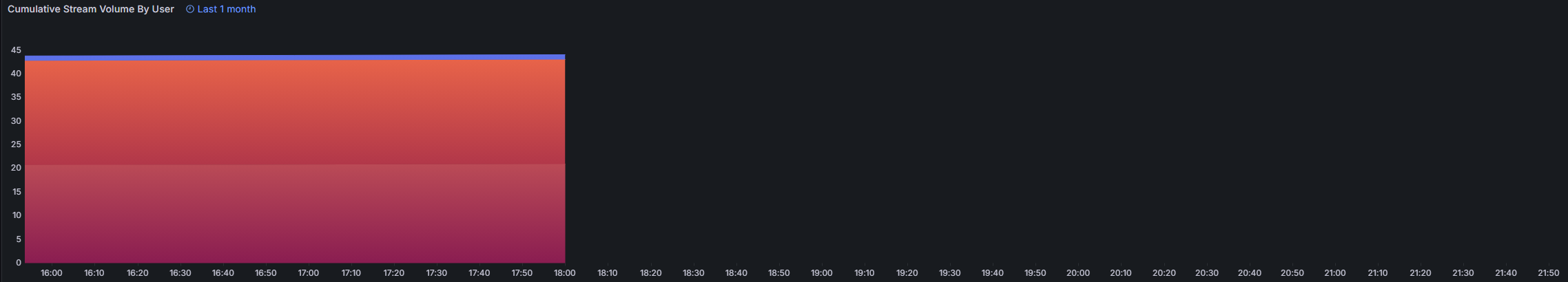

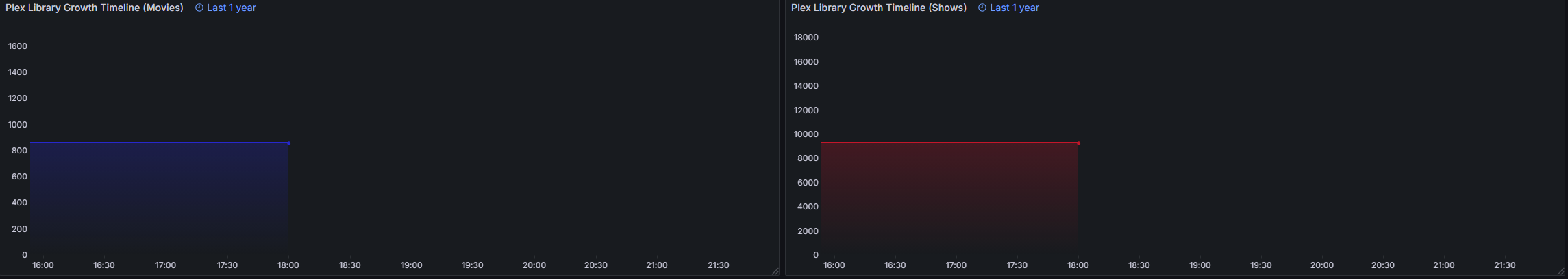

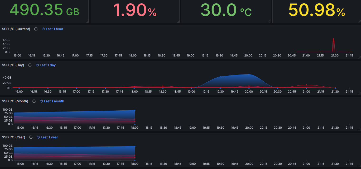

  15. Does anyone know why the time-series graph panels are all set to 6h? Its like they aren't respecting the time picker, nor the relative time options on the panel itself. This was for "Last 24 hours" in the time picker. Anything that does not modify query options is fine. If you make any modifications to query options, it snaps back to now-6h... EDIT: I found it. Under Dashboard Settings > General > Time Settings > Refresh Live Dashboards, Toggle that off. They all appear correct now.
