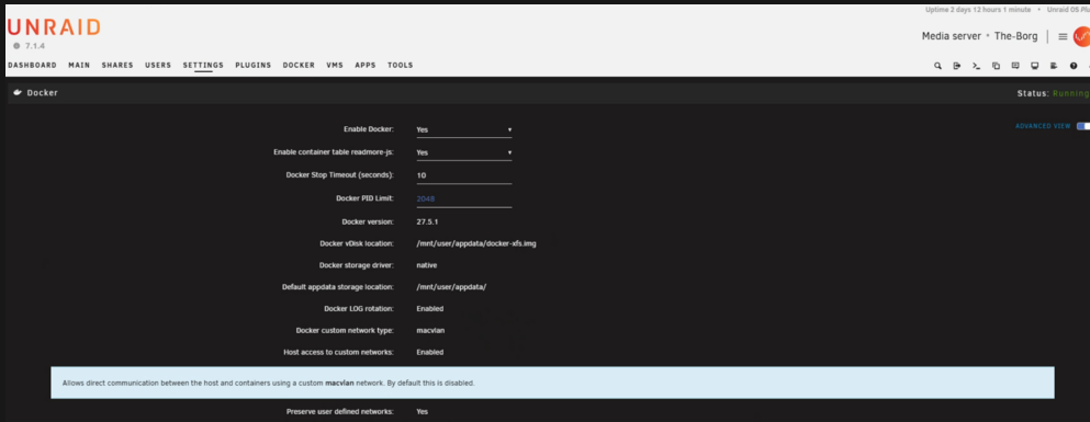

Apps that use the unraid UI for docker don't have this issue. I ran the same compose stacks on an Ubuntu server and they don't have the same disconnect issues.
I'm on Unraid 7.1.4 and using zfs for my cache drive.

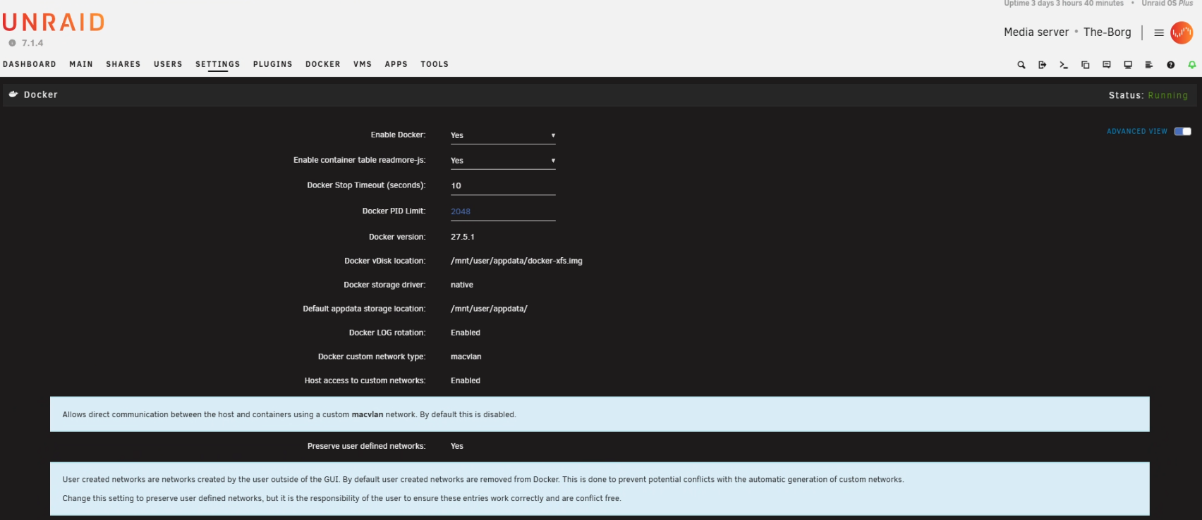

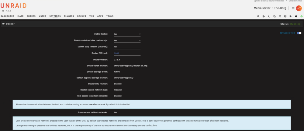

I don't think its dockge removing or messing with my docker networks. My docker settings look identical to that screenshot. Like I said above, stacks started with docker compose on the command line also have this problem. I use a custom-bridge network I had set up and been using long before I started using dockge or docker compose, and containers on this custom-bridge network started with Unraid's docker UI are fine and don't have disconnects.

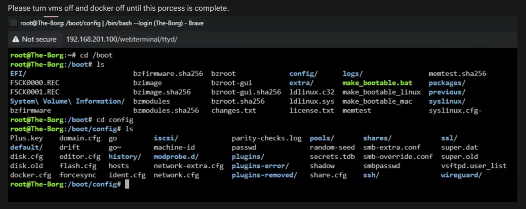

Thank you For posting the Diag File... It appears that the vlan and macvlan is breaking your shim-bridge to connect to the network for other dockers...

I will try removing vlan 50 and disabling vlans and by consequence any containers that were using the br0.50 docker network will be swapped to custom-bridge. I will report back to see if this helps.
Edit: I'd like to ask for clarification, do you mean macvlan docker network in general is the likely issue, or having a vlan (and as a result two macvlan docker networks)
Edited by nate34k

My Honest advice and step by step would be to clear the unraid networking config reboot and start fresh with Unraids default networking.
Before Beginning make sure you have a flash backup.
Main > Flash > Flash backup. This can be used to restore...
Before following these steps be sure to write down any static IPs and have the user script plugin installed as there bay be some scripts used there latter...
Following these steps will completely restart the unraid networking and bring it back to DHCP at first configurations.
Delete the docker network database of docker network configurations. (Also found in the docker disk image.)
rm /var/lib/docker/network/files/local-kv.db
--If docker is off / disabled it may still exisit do this be for diableing docker...
Since we are messing with internal networks. Turn off. LXC/Docker/VMS
Settings Docker Enabled no, VM Manger enabled No.... etc
With the sytem prepred we are ready to proceed with the steps.
Step one is tell the USB to recreate Unraids Default Network. simalr to first inintal configuration.
Reset unraid docker network to guarantee default configurations.
cd /boot/config
rm network*
reboot
this reset unraids to factory default network configurations.

Now with a the unraid defaults you should have bonding off bridging on and eth0 connected to your lan subnet
*At this time DO NOT DO ANY OTHER CONFIGURATION OUTSIDE OF STATIC IP ASSIGNMENT TO ETH0!
We first need to get the networking stuff set and squared away and working. Then you can futz with vlan and other interfaces settings...

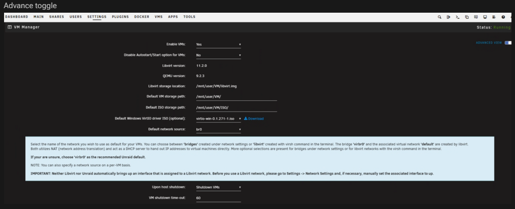

Next lets go to the VM Settings.
Make sure the Default Network Source is NOT VMBIR! it should be set to br0. This affect how the shim bridge is made and some internal cross talk for VMs.
*While Rare, this has also broken docker communications.
Next to Docker settings. (I would honestly recommened deleting the vdisk file. And starting fresh!
-This will clear out the previous Docker Tab all Docker template settings are still on the Flash Drive and Mapped Data is Saved to the Disks
I recommend creating a XFS Docker Vdisk Image. Depends on How You handle your storage and where the system vdisk image is located at. More info in the Release notes...
*This has also rarely caused docker issues.(While Your Diag and other docker issues don't necessarily point to its a recommend change for the future.)
Here we want to make sure that you are enabling Host access to custom networks. and Preserver user defined
(Host access networks is what's making the shim-bridge and ip duplication, which may be problematic and the next step to check and change)
-We want this enabled for lan access to the docker networks...

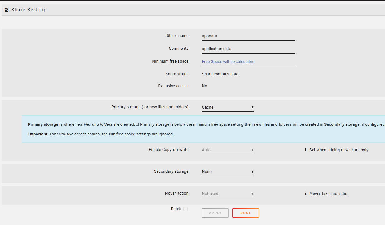

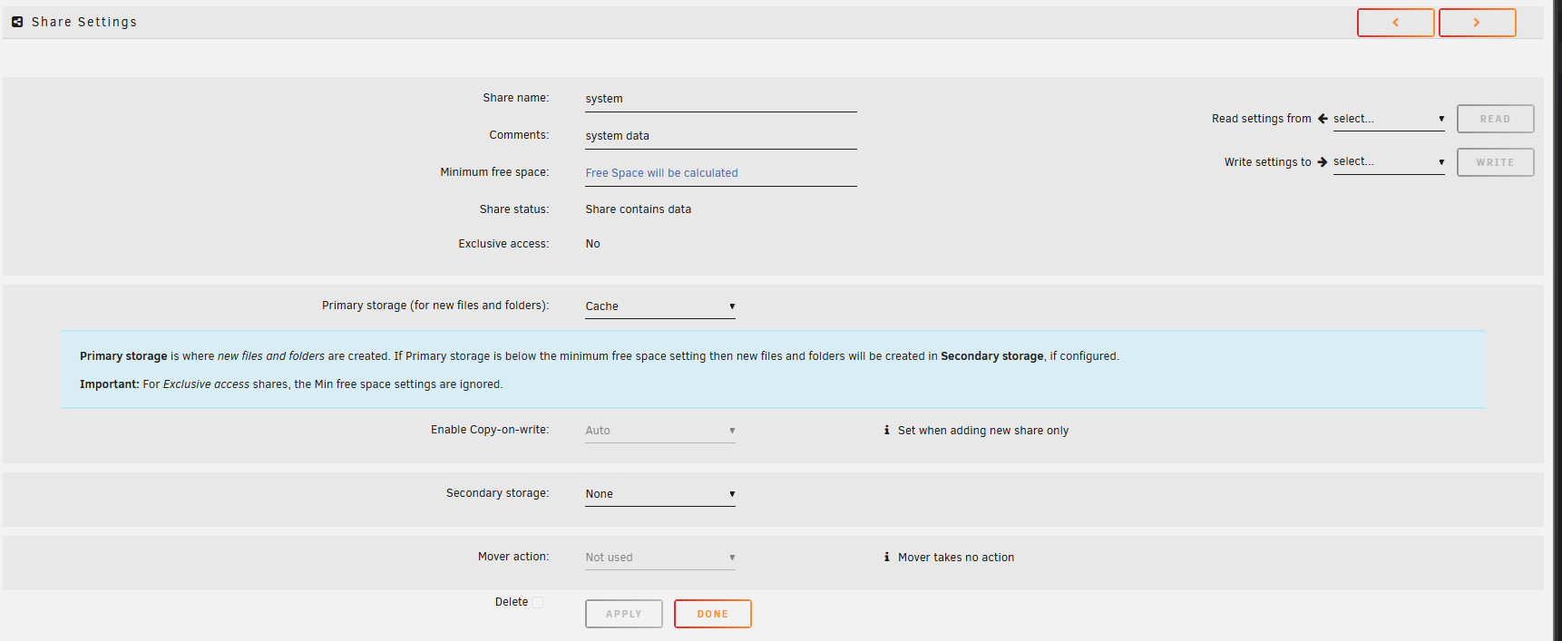

also make sure the docekr vdisk file is stored corretly.
usualy the system share:
as it should only be set to primary and only set to 1 disk.

I apologize for the lack of updates. I am slowly restarting docker services with docker compose up -d and through the GUI. So far everything is stable, no disconnect errors. I am just taking time in case it was a specific app/service I was running in docker that was potentially causing it.
I have a 4 port 1G NIC and a 2 port 10G NIC, I only use eth5 with is the 10G NIC. eth0 and eth5 are in bond0 with bridging on.
VMs are set to br0, and containers that require it (so far traefik and qbittorrent) are using the macvlan br0 with ipv4_address set. All other containers use a bridge network.
No other services at this time are planned to go on the docker macvlan br0 network, they will all run through bridge networks either created by docker compose (eg. immich_bridge or sonarr_bridge) or the one I created (custom-bridge).
If it continues to be stable in this configuration for a few days, I will enable a few more of my services and wait to see if its stable at that point. Rinse and repeat until they are all back online.
If you want another diagnostic or any docker commands ran to verify stability, let me know.
