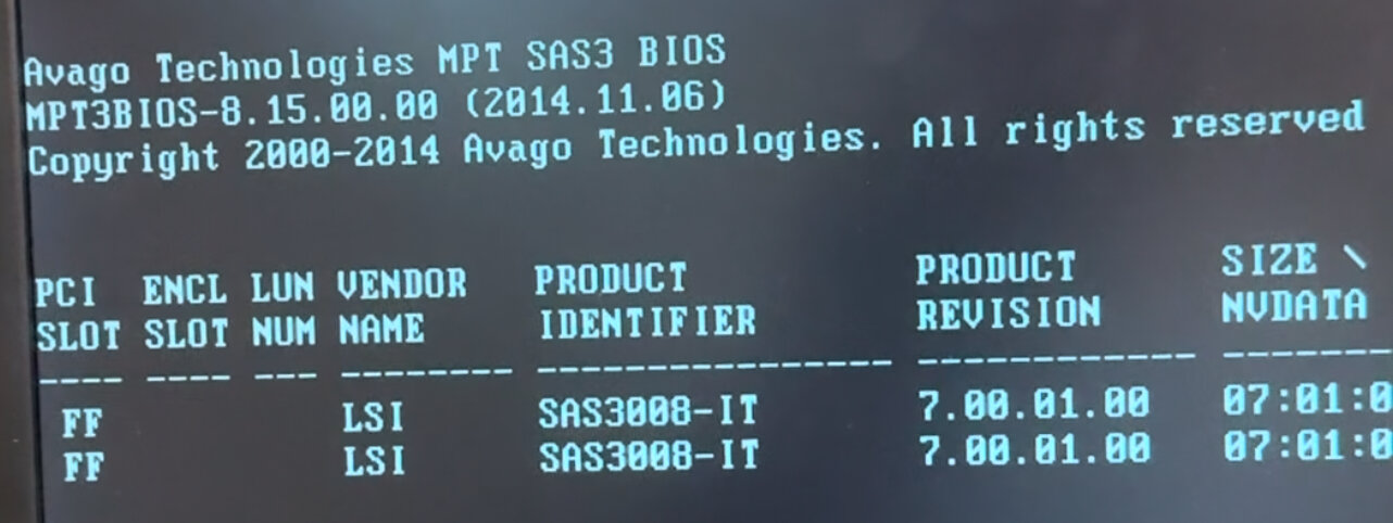

  10. Thank you, that post was helpful. I had originally seen but skipped that one, as I haven't actually built up my Unraid machine yet. I was able to jerry-rig a temporary Unraid box to get the HBA flashed, though, and it worked great. Thanks again!
