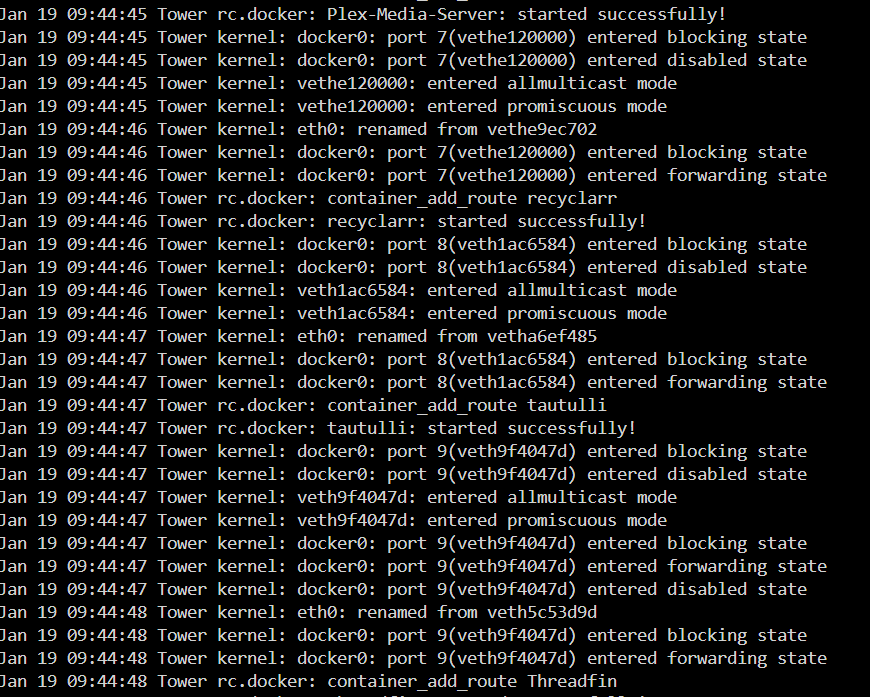

First time question long time lurker. Issue of docker0: port 9(veth9f4047d) entered blocking state spammed in the log

It only happens when turn on or off. So thanks. My real issue is the IPTV looping via Plex. I thought that has something to do with it. I posted my log from Stream Master. If I need to start a new thread. Lmk

I can keep this going. I’ve isolated the issue with the blocking state, promiscuous questions… it happens everytime I start a docker or stop one. As far as the IPTV. I deleted threadfin and installed Stream Master. Same issue. It will play for 30 seconds then repeat. Log from Threadfin.

I see that. I wasnt home and not using. I fired up the plex and tried to watch my iptv at the sametime as these errors started. My best guess is if i use the plex app on firestick it does this. The stream would play 20 secs or so then buffer for 30 then go back and repeat. Repeat what it played. Buffer. Then cycle again. The timing fits. Nothing else was happening with the server. So im running threadfin to translate the iptv signal to plex. But again, it just firestick. Im going to try the native plex app on my tv to see if its that.- First time question long time lurker. Issue of docker0: port 9(veth9f4047d) entered blocking state spammed in the log

Hello, I want to first off thank everyone for their questions and the details in the answers given. As a brand new person to anything even remotely seen as programming; this community has been instrumental in allowing me to make mistakes and understand how to correct. Its been fun! Now that the butt kissing is over. Ive seen this discussed over and over. Ive seen anywhere from you have network issue and its unstable, to its normal, to are you happy with the performance? then dont worry about it. So out of curiousity, is there any definitve answer to this? Thank you for your time in reading. Hitock - First time question long time lurker. Issue of docker0: port 9(veth9f4047d) entered blocking state spammed in the log
