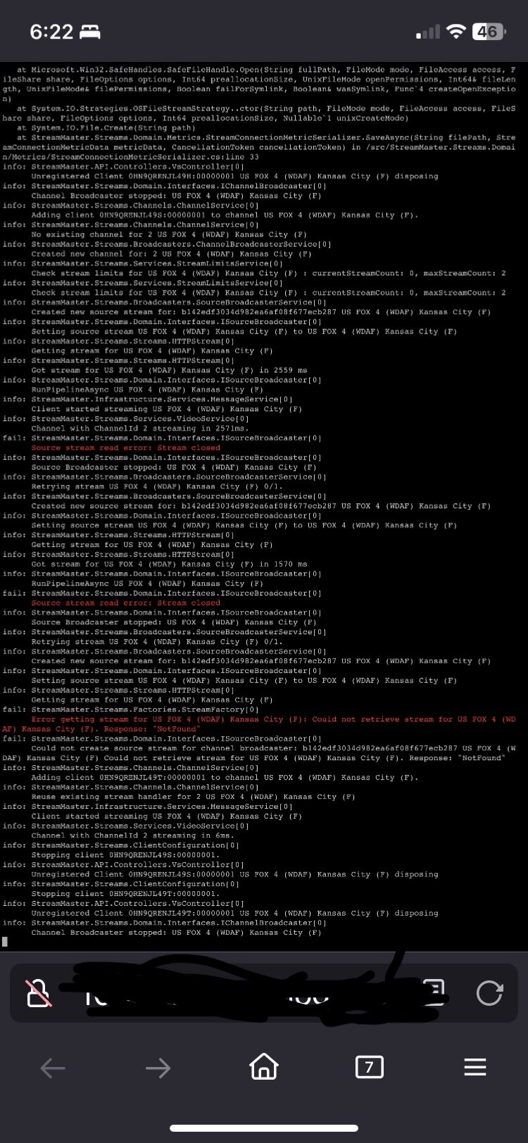

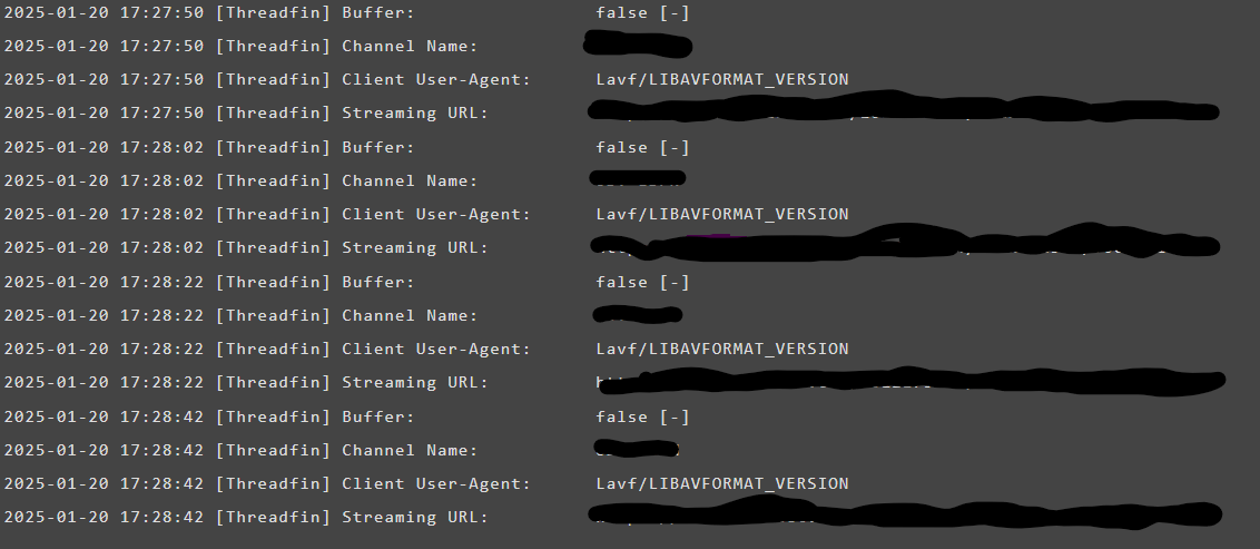

I have my IPTV signal on live tv(plex) for 30 secs or so then replay on loop. Its happened with either threadfin or Stream Master. No errors on the unraid log. I have no issues with IPTV with a dedicated app such as ipsmarters. thanks for reading.

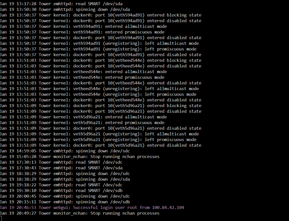

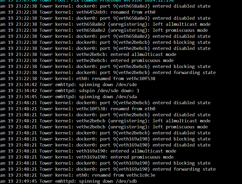

First time question long time lurker. Issue of docker0: port 9(veth9f4047d) entered blocking state spammed in the log

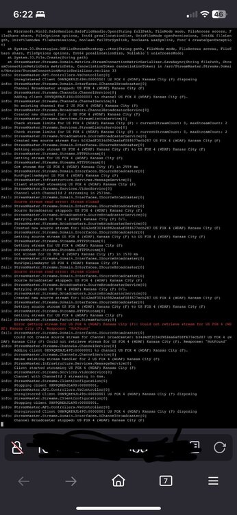

It only happens when turn on or off. So thanks. My real issue is the IPTV looping via Plex. I thought that has something to do with it. I posted my log from Stream Master. If I need to start a new thread. Lmk

I can keep this going. I’ve isolated the issue with the blocking state, promiscuous questions… it happens everytime I start a docker or stop one. As far as the IPTV. I deleted threadfin and installed Stream Master. Same issue. It will play for 30 seconds then repeat. Log from Threadfin.

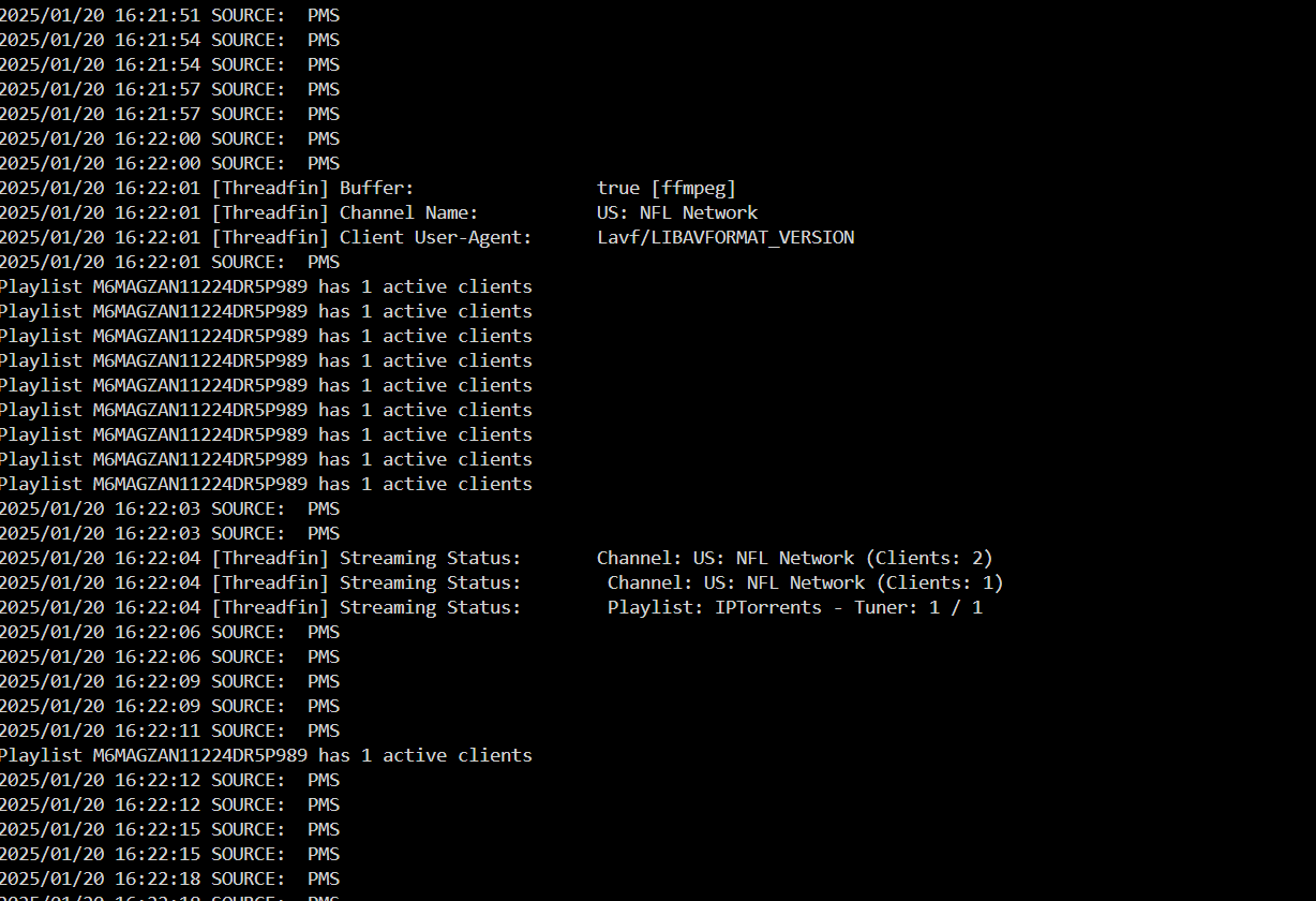

Here is the log inside the GUI of threadfin. You can see it restarting but on the restart it rewinds slowly creeping forward in time. Ive tried XTEVE but its not being updated. SO i gave threadfin a shot. Any other alternatives to those two?

I see that. I wasnt home and not using. I fired up the plex and tried to watch my iptv at the sametime as these errors started. My best guess is if i use the plex app on firestick it does this. The stream would play 20 secs or so then buffer for 30 then go back and repeat. Repeat what it played. Buffer. Then cycle again. The timing fits. Nothing else was happening with the server. So im running threadfin to translate the iptv signal to plex. But again, it just firestick. Im going to try the native plex app on my tv to see if its that.- First time question long time lurker. Issue of docker0: port 9(veth9f4047d) entered blocking state spammed in the log
