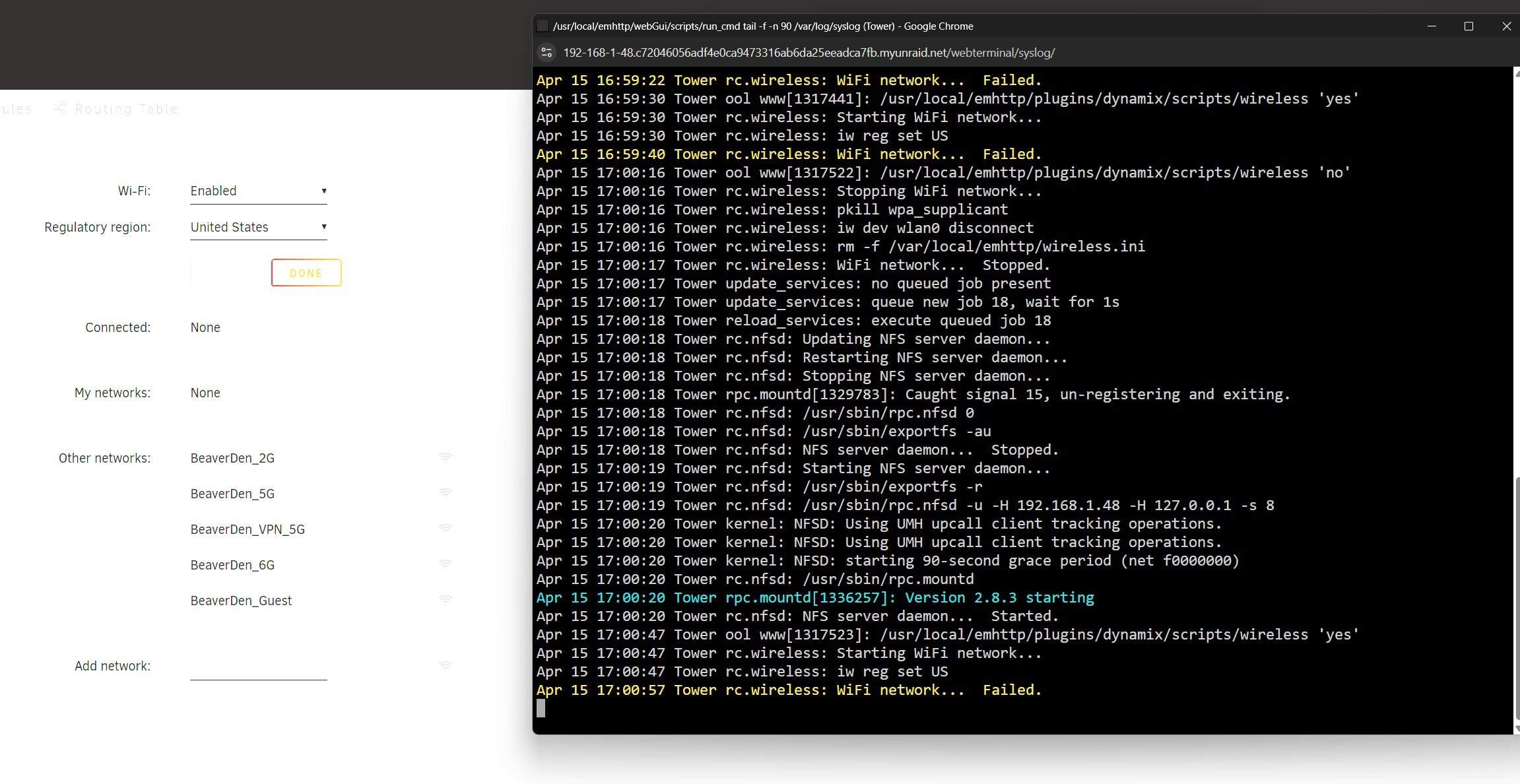

MediaTek wireless adapter not showing up in the most current 7.1.0-Beta
I'm seeing the same errors. Thanks!

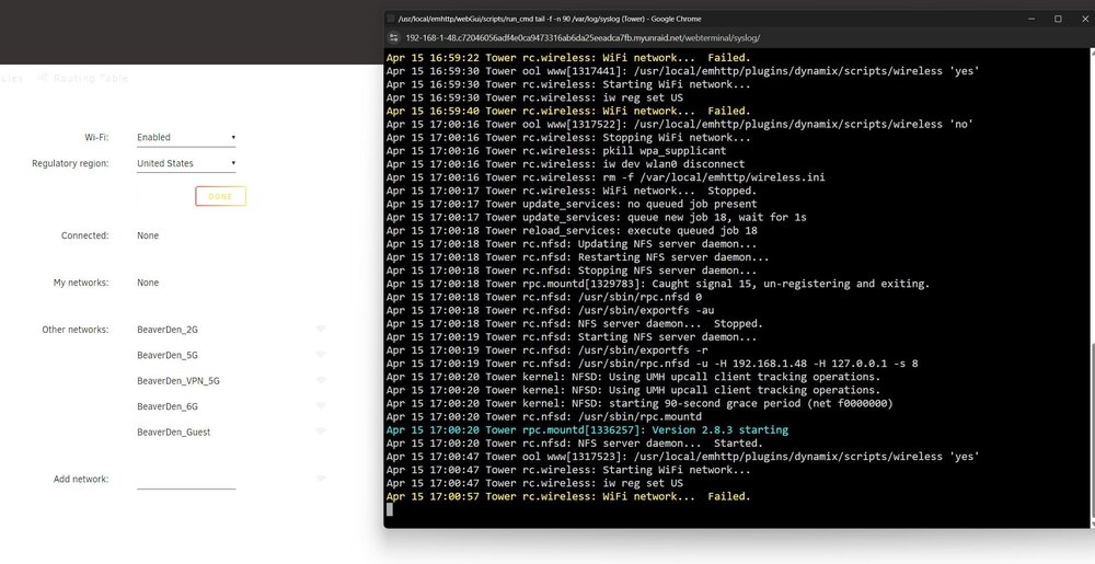

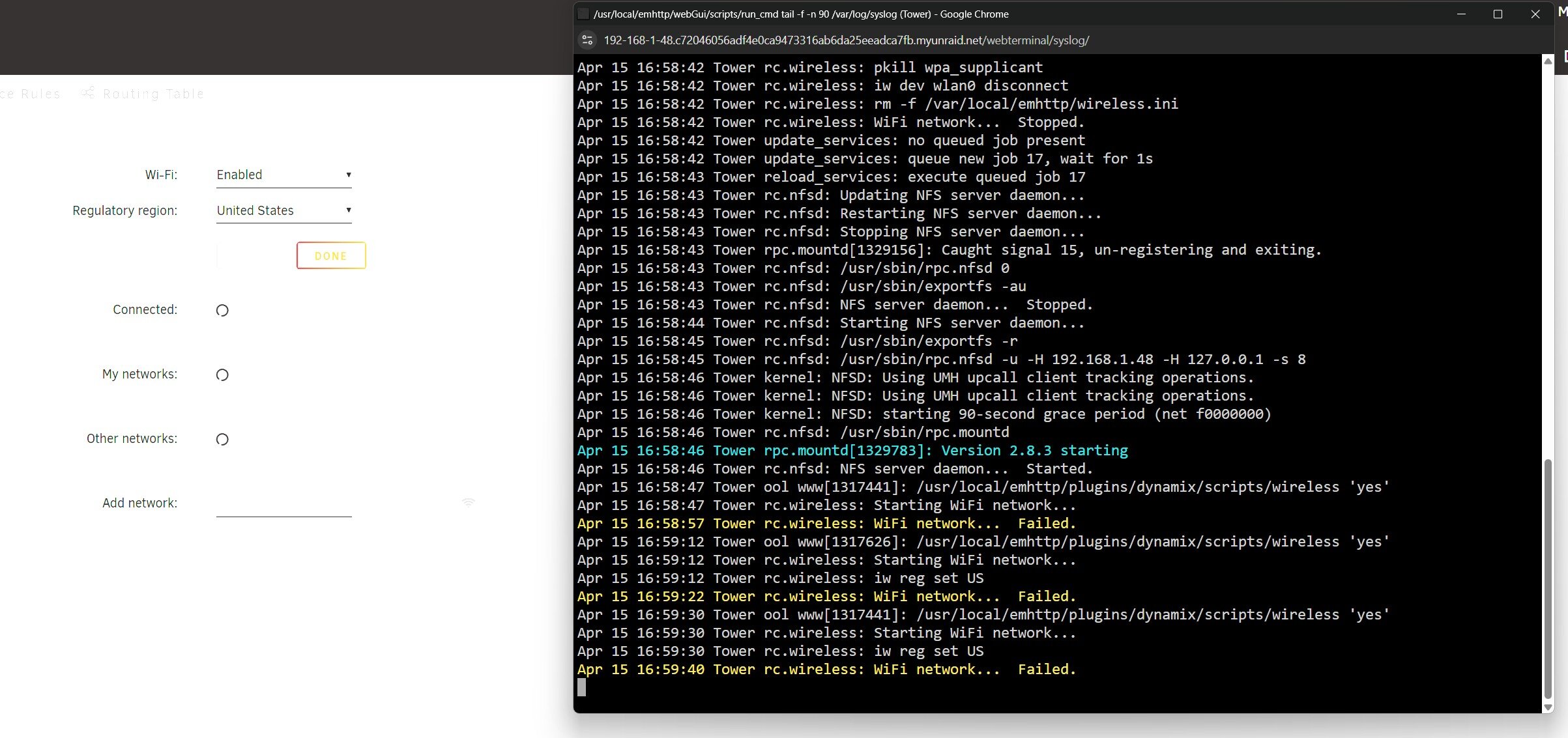

@bonienl Thanks for looking into the problem. I just wanted to add some details, as I'm not sure if the bug you found is for the same issue I'm running into. If I set my "Regulatory Region" and then enable WIFI, its still failing: If I manually enable the wifi interface like you suggested, it does appear to actually scan for networks. However, its still failing and won't let me select one to connect with.
It never gets to the point of selecting a wifi network. If I manually enable the wifi interface using ifconfig from the terminal, then it does at least shows wifi networks when I enable it from the UI, but it still doesn't let me actually connect.
@JorgeB Updated yesterday and the wireless interface does seem to be recongized now! However, its failing when I try to enable it. Apr 13 09:29:04 Tower ool www[527776]: /usr/local/emhttp/plugins/dynamix/scripts/wireless 'yes' Apr 13 09:29:04 Tower rc.wireless: Starting WiFi network... Apr 13 09:29:04 Tower rc.wireless: iw reg set US Apr 13 09:29:14 Tower rc.wireless: WiFi network... Failed. Appricate you adding the driver so quickly. tower-diagnostics-20250413-0920.zip
Thank you!
Not sure if there is a better area to post this, but it said to submit something in the forums if the wireless adapter wasn't showing up. I have: MEDIATEK Corp. MT7921 802.11ax PCI Express Wireless Network Adapter Diagnostic log is attached tower-diagnostics-20250410-1034.zip
