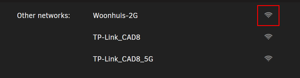

Can you open a terminal window and type
ip link set wlan0 up
Then open the wireless page and see if it populates.
You need to click on the wifi icon to join a network.
Ok, I found a bug which explains your issue, will be fixed in the next release.
As a workaround, set the "Regulatory region" to your country instead of ''automatic' and then join a network.
