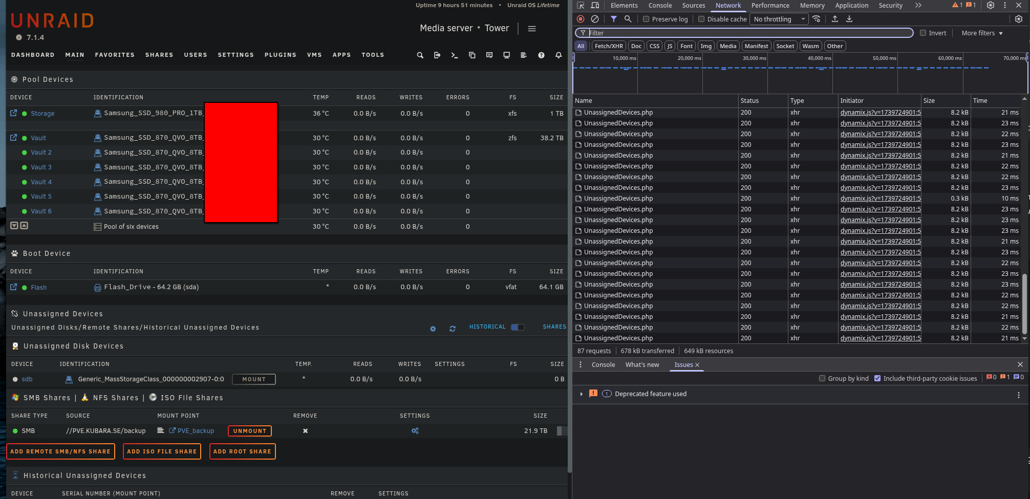

  3. Came here to say the exact same thing! It keeps spamming every second and i actually think this is the reason why my Brave crashes after some time. I uninstall and everything is back to normal! I read LT has taken over but not sure they are actively working on this or not. Would be awesome if this was part of Unraid itself. This is a very useful and pretty much must have feature.
