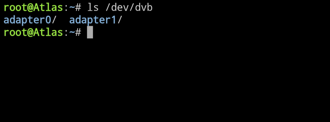

  10. Hi bmartino1, Just a quick follow up to let you know you were right. I changed the BinHex Docher to The Linux Repository Docher and the TV adapter was seen immediately..... Everything worked a treat after that. Thank you so much for your help, I honestly think without your help I would have continued to peruse the forums wondering what I had done wrong 🤔 Thanks again. Simon

  12. Hi bmartino1 I have copied your example and it appears to show that the Docher seems to see the both adapters....Do you agree or am I missing something?
  13. PPS....this is the Quadro doing a transcode for Plex
  14. Like I said, the container just doesn't see the hardware.
  15. Ps....In my original post my extra parameters shows 2 statements. The first is for the Nvidia runtime statement and the second is for the Hauppage antenna adapter. I read that you could use multiple statements as long as you left a space between statements.
  16. Thanks bmartino1 Like I mentioned in the previous post, I used the Binhex app as is was easier for GPU support to how I read it originally. The Quadro is seen by both Unraid and the Binhex Docher and transcodes my 4k HDR HEVC perfectly so that definitely doesn't seem to be an issue. I also ran the ls /dev/dvb command from terminal and just like you unraid can see my antenna adapters as shown below.
