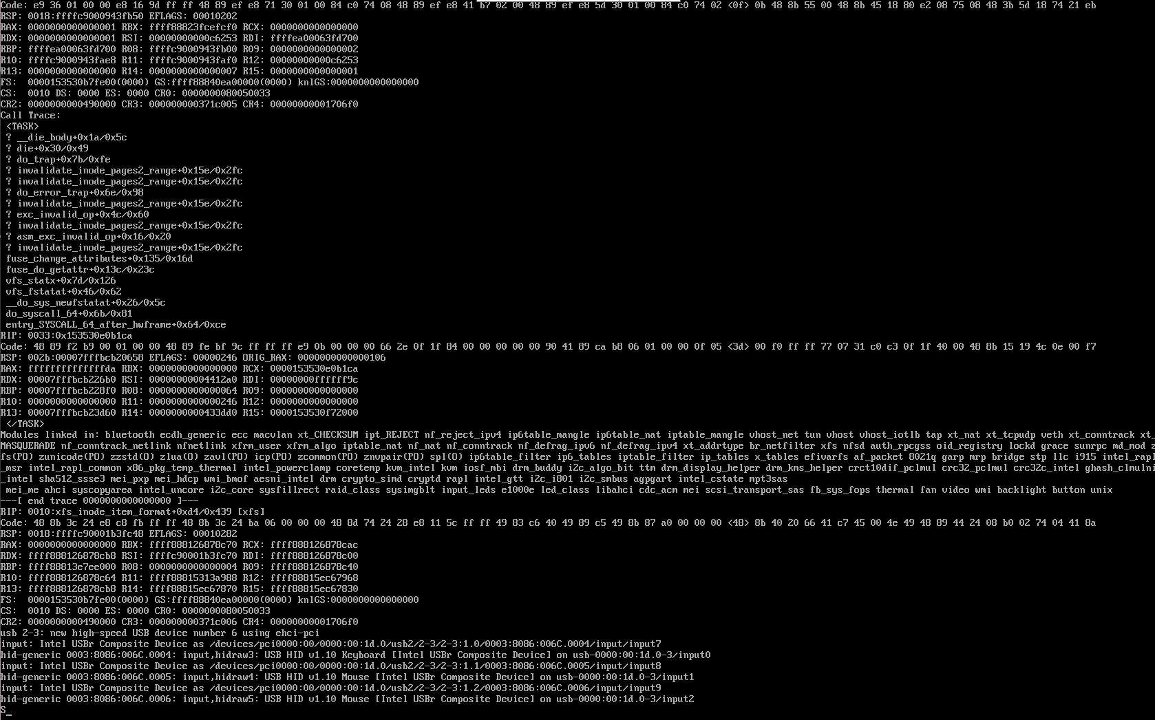

  4. So far I've managed to verify it's "stable" with Community Applications and Check For Common Problems plugins enabled. I had an issue once after installing Disk Location, but was not able to capture any useful data and haven't taken the time to try again. Now I say "stable" in quotes because after a number of days of solid operation things started going unresponsive again. I did capture diagnostics before it was completely unresponsive, but once it was unresponsive I capture the following from the console: It looks like this might be different than what I was previously running into, since I wasn't seeing the call traces before. Unfortunately I probably won't be able to get back to debug for a while, but I wanted to collect the data before I lost it. unraid-diagnostics-20230925-1315.zip

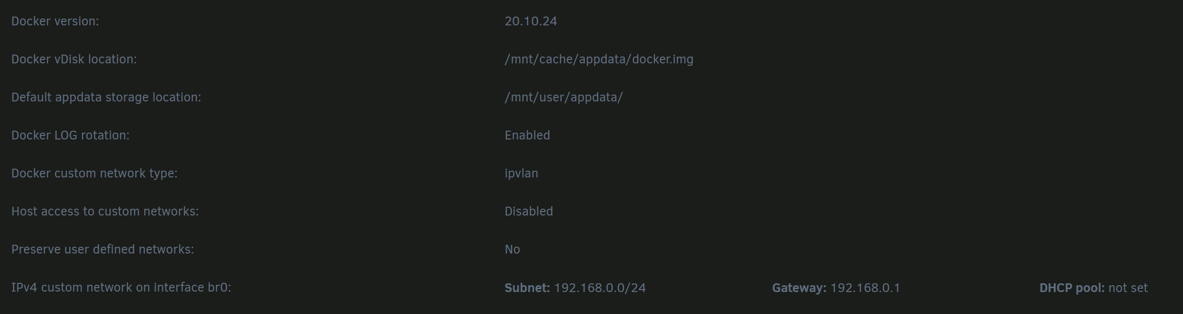

  8. Yeah, it's a little complicated. You're right, it's not totally frozen and does respond to a keyboard/mouse, however, if you're not already logged in locally on the console, you can't log in, it times out after 60 seconds from entering the username. That was what I tried above with the remote syslog (with all the USB cruft in the logs from the IPMI periodically reconnecting), I logged in to the console before the apparent network issues, and yes it wasn't completely frozen. This is also evidenced by the fact that eventually the shutdown/powerdown sequence completed after hitting the power button, but it was on the order of 9 hours later it finally completed. I do agree that it seems network related, and currently the leading suspect is something docker related. Right now my system is still up in safe mode with Home Assistant and zwave-js-ui running both with host network config. I've also started plex, which is also host networking and LMS which is one of my containers which are custom IPs on br0. I have several other containers that also use custom IPs on br0. I'm wondering if there's something wrong with how I've got that setup that's not compatible with 6.12. Here's my docker config:
