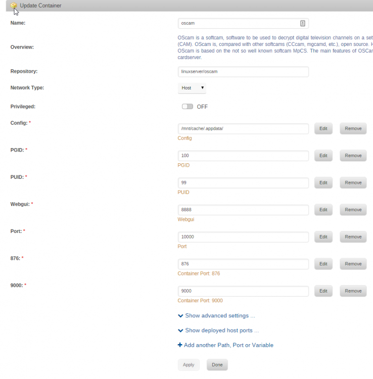

  2. I use port 876 for cccam. Please look into attachment for the container set up. Thank you Who have you set the network to host? There should be no need to. Change it back to bridge and try again. I checked both 'host' and 'bridge' modes, in both cases the error occurred. But I switched port from 876 to 8765 and it looks that the problem disappeared It was late and I could not check the port accessibility, but at least, there were no error messages in the log. Maybe the issue is related to ports lower than 1024. I do not know, if there are any restrictions in docker for ports. I will check if the port is accessible and check if the solution works for other modules. I will do a test with numbers like 877 or similar.

  4. I use port 876 for cccam. Please look into attachment for the container set up. Thank you

  6. Hello, When I enable cccam or newcamd modules in oscam, I have the following errors in log and I cannot access Web interface: - in case of cccam: 23:06:23 00000000 s (net) cccam: Bind request failed (Permission denied), waiting another 106 seconds - in case of newcamd: (net) newcamd: Bind request failed (Permission denied), waiting another 87 seconds I tried with different Network modes, the same. When I do telnet from unraid to the appropriate ports it says "Connection refused" Might be Docker general network configuration issue? Thank you in advance for your help,
