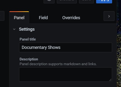

  8. Movies at the end of the FROM line, is a library in Plex. If you left click on it, you should get a list of libraries it found in Plex / Tautulli that you can select from. Your "movies" library in Plex must have a different name. Verify in Tautulli what it is seeing in Plex, under Libraries You will need to reselect the Documentary Movies and Anime Movies panels the same way. Actually, each panel in your top picture will need the same thing done. You will probably want to change the panel title also in each one to reflect what it actually is.

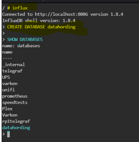

  10. Open a console to influxdb. You should have permission already for what you need. You type influxdb You next type CREATE DATABASE "name" Replace "name" with the name of the database you want to create. You can next type SHOW DATABASES to verify it was created. If you are done with influxdb, you type exit and exit again to close the session and window.

  14. Like falconexe said, "You need to edit the query by selecting your proper Plex Library section. If your library section names happen to mach the UUD (mine since I'm the developer) exactly, they will just magically work. So edit the panel, head over to the query, and click the library section tag and select from the auto populated drop own menu. Do this for all fo the N/As and you'll be in business." You should also change the Panel title and Alias by fields to the new type of show.
