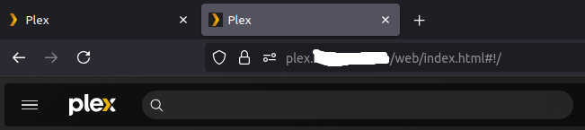

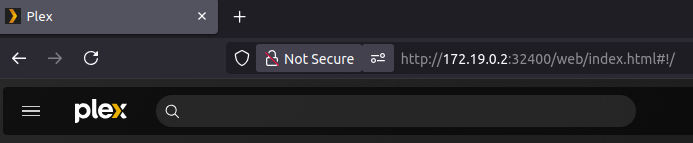

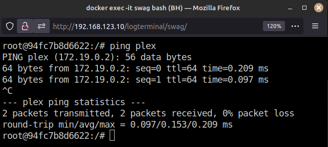

  1. @MowMdown Thank you for your feedback. Reading through the entire thread again, I realize I opened whole separate can of worms like you said. I'm surprised that you recommended to enable "Host access to custom networks". Because earlier I came across a few posts in my search that mentioned not to enable this setting, posts claiming it would have no impact. I can't find them at the moment. Your advise makes sense, so I probably misunderstood it. Thank you. Still, I'm glad that it forced me to think of another solution; adding the static route to my router. Because it enables access to the custom docker network from any device on my network (192.168.123.0/24), instead of (I assume) only the Unraid host getting access to the custom docker network when I would have enabled the setting "Host access to custom networks". I assume that only the Unraid host would have access to the custom docker network, because I never tested it. Below the screenshots to illustrate the above. Static route within Unifi to custom docker network (172.19.0.0/24), named ProxyNet, pointing to Unraid host (192.168.123.10): Browsing from another device within 192.168.123.0/24 to Plex via custom docker IP 172.19.0.2 on port 32400: Browsing through Tailscale network via swag (wildcard certificate) and sub domain also works without specifying port: The reverse proxy, swag, is in the same custom docker network as Plex. So swag can reach it by container name and IP.
  2. Sorry, to respond on an older threat. But I believe above to be incorrect. I came across this threat while trying to solve a problem. My Plex docker being only reachable when setup in network type host. But once I change it to a custom network so it can communicate with a reverse proxy (Swag), I can no longer reach it unless via Tailscale setup in that reverse proxy. But not without Tailscale. Looking at all the docker containers in use, I noticed that Plex doesn't have any ports mapped. Trying to solve this I found this thread and the comment above saying that port mappings don't do anything unless you are in bridge mode. Finally looking at official docker documentation on networks; https://docs.docker.com/engine/network/ I figured this was wrong. Doubting myselfI asked Grok AI for confirmation with the prompt/question: "Are docker containers running in a custom user-defined network reachable from the host's network without port mappings ?". The answer confirmed my understanding of the docker documentation; "Docker containers running in a custom user-defined network (e.g., a bridge network) are not directly reachable from the host's network without port mappings, unless specific configurations are made." So I followed through. I added the port mapping for port TCP 32400 to the Plex docker. The server results were that the Plex client found the server in a second, no longer did it take 15 seconds. The Remote Access section of the Plex server now has a green check mark again saying; "Fully accessible outside your network." Before it was a red warning. Using the IP address of the custom user-defined network I could not browse to the plex server yet. I had to add a static route on my Unifi router pointing the subnet towards the Unraid host. Once that was done I could use the custom user-defined docker network IP together with port 32400 to reach Plex web portal. And Tailscale using the DNS record also works. I'm happy with the results, although it took some time troubleshooting it all.
