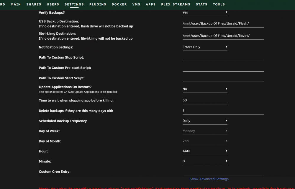

  • In your custom cron entry, you have a "*" character in the first slot which makes it so it is set to try to run at every minute during the 3:00 AM hour.   * * * * * * | | | | | | | | | | | +
