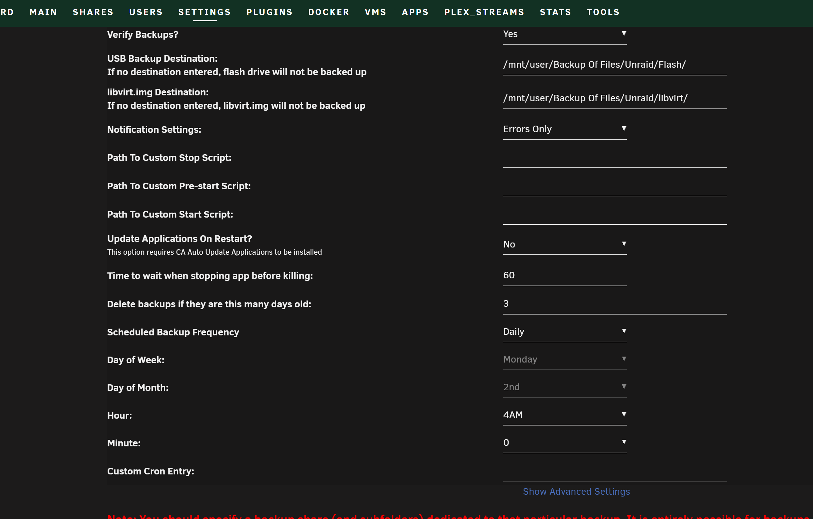

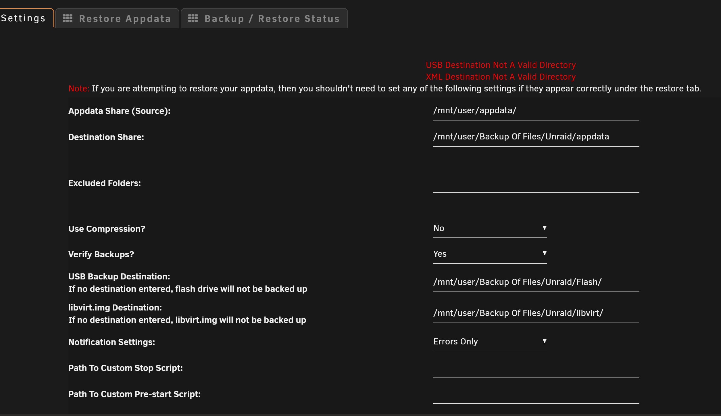

i trying to setup  ca backup on another unraid machine.. but its giving me issues
i have  a share called "Backup Of Files"    i duplicated what is on my other server  but i get 2 errors and not sure whats wrong.. it be nice if there was more detailed info... to me makes not sense no help  no   "?"  to say how to fix it like example.. so not sure whats wrong   better explaination be good
i figured the error... the error doesnt happen for Appdata  just Flash and libvirt
if the    "Backup Of Files/Unraid/appdata"  doesn't exist    no error  but will create  "appdata"  when it cabackup runs
if  the  "Backup Of Files/Unraid/Flash" doesn't exist gives error.. so i have to manually make that "Flash" Folder
if the "Backup Of Files/Unraid/libvirt" doesn't exists, gives error..  so i have to manually make that "libvirt" Folder
maybe you can make it like Appdata...    If usb destination folder doesnt exisit ... then create folder when cabackup is saved or ran
same for libvirt
just a suggestion...  but made the folders manually and no errors given
and maybe change that XML destination message  to me that made no sense.. i couldnt find no XML destination or down by  libvirt destination   put in Brackets (XML Destination)
Edited by comet424
