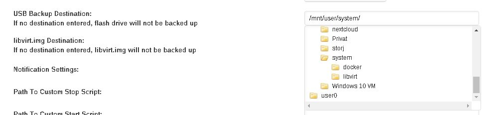

Is /mnt/user/system/libvirt/ for libvirt.img correct?

12 hours ago, nuhll said:
I see it via SMB as /flash/ but there is no share for it. And in the dropdown menue, i can just select user shares and all drives...
It is shared on the network as /flash, but within unRAID it is /boot.
