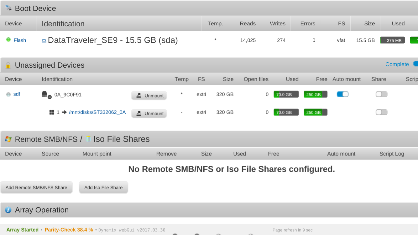

@wgstarks I was wondering what path you used to get the backup script to work with your Unassigned Drive. I have a similar setup and I am using /mnt/disks/Torrents/Backups and it fails every time! I know it's something simple but everything I try doesn't work. Any thoughts?
I use the path shown in UD for that mount point. You may need to click the name to see the path. In this case it's /mnt/disks/ST332063_OA.
Edited by wgstarks
