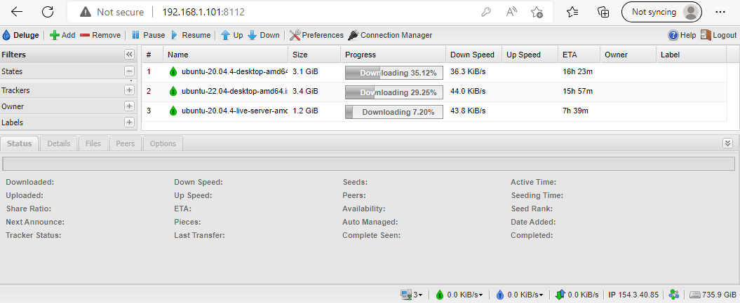

  2. I wanted to continue the issue I'm having with DelugeVPN here. I rebooted the unRaid server 3 times but that didn't completely fix the issue. I'm able to download but it seems to only allow 1 peer per torrent. I changed the PIA wireguard endpoint from ca-toronto.privacy.network to ca-montreal.privacy.network but get the same results. Is this an issue with my configurations or is it an issue with PIA? Thanks.
  3. I'm experiencing the same issue with Unraid 6.9.2 and the latest DelugeVPN-binhex which coincidently updated last night. I downgraded to 2.0.5-1-04 but still had this issue. Privoxy works so I'm confident I'm logged into PIA. I have another unraid server with the same configurations and the latest DelugeVPN-binhex is behaving as expected.

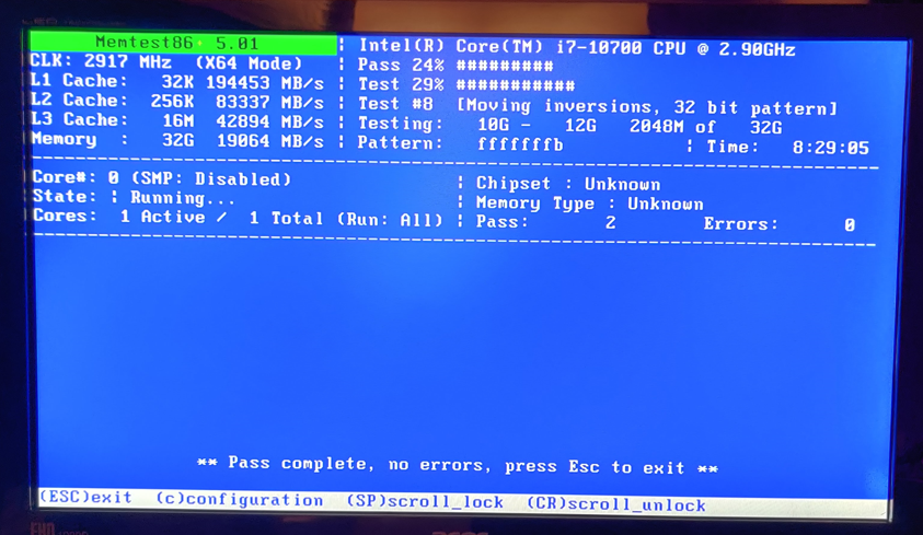

  8. How would you go about testing the disks? Thanks for your help by the way.
  9. Ran a memtest overnight and did not return any errors. I went ahea d and order some lsi 9201-16e replacement cards.

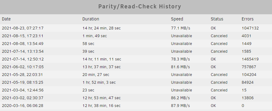

  10. I performed a "New Config" and parity was rebuilt. I then ran a non correcting parity check and it returned errors. I ran a 2nd non correcting parity check and it also returned errors. I've attached the latest diagnostics. Could the lsi 9201-16e cards have gone bad? They are about the only things left that I haven't replaced besides the hard drives and power supply. atlas-diagnostics-20210922-0759.zip
  11. atlas-diagnostics-20210919-1551.zipAttached is the latest diagnostics.
  12. I have replaced the sata and power connection and now disk ST4000DM000-1F2168_Z304M0WL is now showing up in Unassigned Devices. I then assigned disk 10 to ST4000DM000-1F2168_Z304M0WL and get a warning that the disk data will be erased when the array is started. I'm assuming instead of doing this, I need to do a "New Config" and recreate the parity drives. I'm just not sure what the exact options I need to select on "New Config". Also, will my other settings like Shares, dockers, and VM will still be there or will I really need to start from scratch?
  13. disk10 became disabled during the the latest parity check. After building the new computer, I reattached the 6 External Mini SAS cables to the DAS and on boot-up, 4 of the hard drives were not recognized. I unplugged and re-plugged the 6 External Mini SAS cables and on next boot-up all drives were recognized. I then ran the latest parity check. I suspect there's something going on with the SAS connection. I will check all connections and reboot to see if disk10 comes back.
  14. In order to fix disk10, would I replace it with another drive and let unRaid rebuild the new drive? How would the previous parity check sync errors affect this rebuild? Is it possible that the new disk10 rebuild will contain bad data?
  15. I'm trying to figure what is causing the following parity check errors on my server. So far I have replaced the motherboard, cpu, memory, and psu hoping this would solve the issue. I wanted to upgrades the cpu anyways. This was before the 8/23/2021 parity check but I'm still getting errors. I'm currently running another parity check but sync errors are still coming up. I have not replaced the hard drives, 2 LSI SAS9201-16e cards, 6 External Mini SAS cables, and a DIY DAS made up of 3 Dual Mini SAS SFF-8088 to SAS36P SFF-8087 Adapter and 6 Mini SAS 26Pin (SFF-8088) Male to 4 SATA 7Pin Female Cable. Any ideas on where I should look next? atlas-diagnostics-20210823-0831.zip
