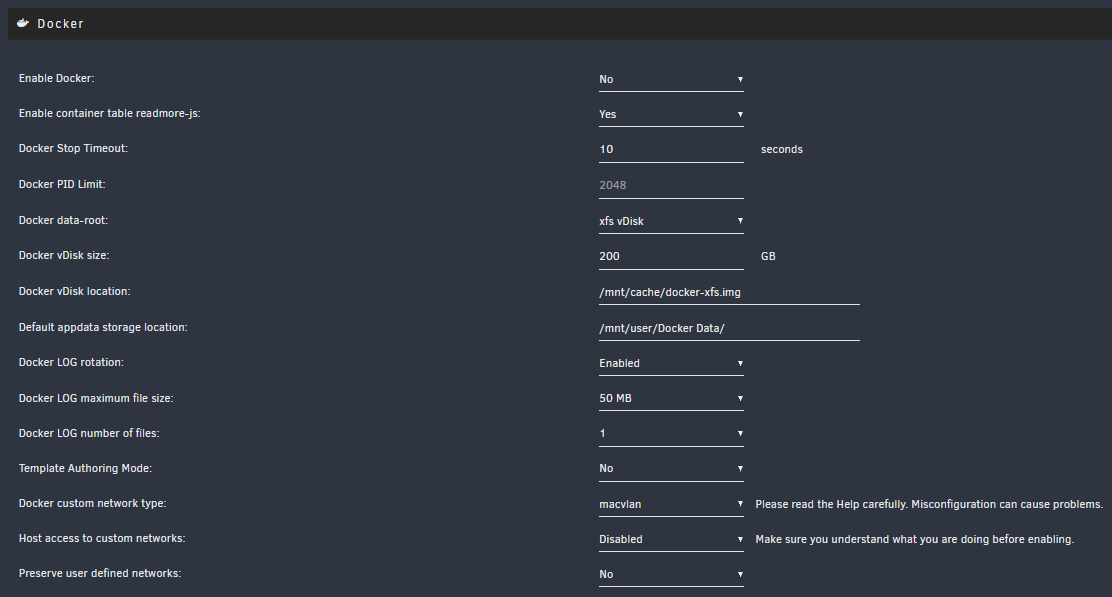

  16. Managed to format the 2tb nvme cache drive to XFS so at least it's showing up now.

  18. I'm working through an issue with Docker again. This morning I checked in and docker was not running. I had a bit of an issue with one nvme slot being a bit too close to a PCIE slot and the NVME heatsink was touching the heatsink of a PCIE. I figure it was causing a connection issue even though it's been fine for the past month. Anyway, I'm using a different slot and I took the heatsink off. The cache drive is showing up but the directory (/mnt/cache/docker-xfs.img) has a triagle next to it and says path does not exist. Now, there is a large chunk of the nvme drive that's being used. I expect it's the previous .img file but I don't know how to find it. It's not showing in WinSCP. I think my only option at this point is to format and set it up again. I'm backing up the /user folder to try to keep my persistent data. I wanted to check here in case you have any other options.
