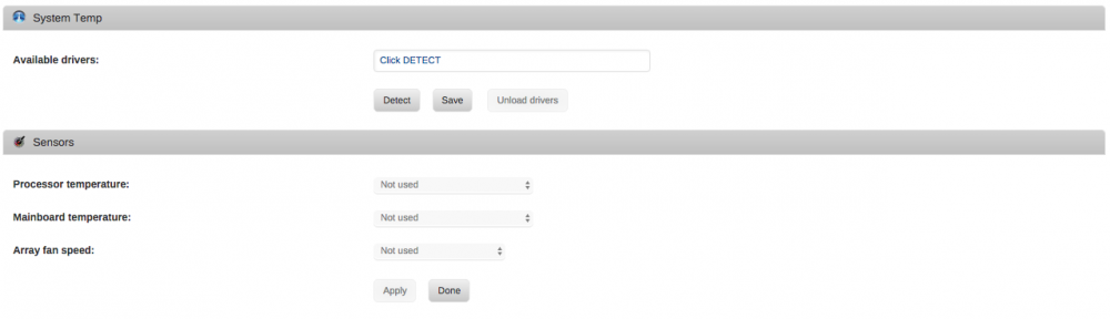

  6. You didn't actually say what's not working. It all looks fine, from what I can see. What temps are you seeing on the Main page? Ah. Right. Yeah, I'm not seeing any temps on the main page. Or the dashboard. They're supposed to show up towards the bottom, if I'm not mistaken? The sensor command is working fine, but I can't seem to get the temps to pass through to the gui through the plugin.
  7. Can't seem to get this to work. In the plugin under drivers all I'm getting is the 'click detect', but it doesn't seem to do anything. I went through the sensor-detect script in order to get sensors working, and it seems to be outputting temps correctly... Any ideas? root@Tower:~# sensors -u acpitz-virtual-0 Adapter: Virtual device temp1: temp1_input: 27.800 temp1_crit: 105.000 temp2: temp2_input: 29.800 temp2_crit: 105.000 coretemp-isa-0000 Adapter: ISA adapter Physical id 0: temp1_input: 46.000 temp1_max: 80.000 temp1_crit: 100.000 temp1_crit_alarm: 0.000 Core 0: temp2_input: 46.000 temp2_max: 80.000 temp2_crit: 100.000 temp2_crit_alarm: 0.000 Core 1: temp3_input: 42.000 temp3_max: 80.000 temp3_crit: 100.000 temp3_crit_alarm: 0.000 Core 2: temp4_input: 44.000 temp4_max: 80.000 temp4_crit: 100.000 temp4_crit_alarm: 0.000 Core 3: temp5_input: 45.000 temp5_max: 80.000 temp5_crit: 100.000 temp5_crit_alarm: 0.000 nct6791-isa-0290 Adapter: ISA adapter in0: in0_input: 0.904 in0_min: 0.000 in0_max: 1.744 in0_alarm: 0.000 in0_beep: 0.000 in1: in1_input: 1.016 in1_min: 0.000 in1_max: 0.000 in1_alarm: 1.000 in1_beep: 0.000 in2: in2_input: 3.344 in2_min: 0.000 in2_max: 0.000 in2_alarm: 1.000 in2_beep: 0.000 in3: in3_input: 3.328 in3_min: 0.000 in3_max: 0.000 in3_alarm: 1.000 in3_beep: 0.000 in4: in4_input: 1.016 in4_min: 0.000 in4_max: 0.000 in4_alarm: 1.000 in4_beep: 0.000 in5: in5_input: 1.992 in5_min: 0.000 in5_max: 0.000 in5_alarm: 1.000 in5_beep: 0.000 in6: in6_input: 0.112 in6_min: 0.000 in6_max: 0.000 in6_alarm: 1.000 in6_beep: 0.000 in7: in7_input: 3.472 in7_min: 0.000 in7_max: 0.000 in7_alarm: 1.000 in7_beep: 0.000 in8: in8_input: 3.392 in8_min: 0.000 in8_max: 0.000 in8_alarm: 1.000 in8_beep: 0.000 in9: in9_input: 1.120 in9_min: 0.000 in9_max: 0.000 in9_alarm: 1.000 in9_beep: 0.000 in10: in10_input: 0.000 in10_min: 0.000 in10_max: 0.000 in10_alarm: 0.000 in10_beep: 0.000 in11: in11_input: 0.848 in11_min: 0.000 in11_max: 0.000 in11_alarm: 1.000 in11_beep: 0.000 in12: in12_input: 0.000 in12_min: 0.000 in12_max: 0.000 in12_alarm: 0.000 in12_beep: 0.000 in13: in13_input: 0.064 in13_min: 0.000 in13_max: 0.000 in13_alarm: 1.000 in13_beep: 0.000 in14: in14_input: 0.016 in14_min: 0.000 in14_max: 0.000 in14_alarm: 1.000 in14_beep: 0.000 fan1: fan1_input: 2890.000 fan1_min: 0.000 fan1_alarm: 0.000 fan1_beep: 0.000 fan1_pulses: 2.000 fan2: fan2_input: 1030.000 fan2_min: 0.000 fan2_alarm: 0.000 fan2_beep: 0.000 fan2_pulses: 2.000 fan3: fan3_input: 0.000 fan3_min: 0.000 fan3_alarm: 0.000 fan3_beep: 0.000 fan3_pulses: 2.000 fan4: fan4_input: 0.000 fan4_min: 0.000 fan4_alarm: 0.000 fan4_beep: 0.000 fan4_pulses: 2.000 fan5: fan5_input: 0.000 fan5_min: 0.000 fan5_alarm: 0.000 fan5_beep: 0.000 fan5_pulses: 2.000 fan6: fan6_input: 0.000 fan6_alarm: 0.000 fan6_pulses: 2.000 SYSTIN: temp1_input: 31.000 temp1_max: 0.000 temp1_max_hyst: 0.000 temp1_alarm: 1.000 temp1_type: 4.000 temp1_offset: 0.000 temp1_beep: 0.000 CPUTIN: temp2_input: 40.000 temp2_max: 80.000 temp2_max_hyst: 75.000 temp2_alarm: 0.000 temp2_type: 4.000 temp2_offset: 0.000 temp2_beep: 0.000 AUXTIN0: temp3_input: -128.000 temp3_type: 4.000 temp3_offset: 0.000 AUXTIN1: temp4_input: -128.000 temp4_type: 4.000 temp4_offset: 0.000 AUXTIN2: temp5_input: 34.000 temp5_type: 4.000 temp5_offset: 0.000 AUXTIN3: temp6_input: 127.000 temp6_type: 4.000 temp6_offset: 0.000 PECI Agent 0: temp7_input: 40.500 PCH_CHIP_CPU_MAX_TEMP: temp8_input: 0.000 PCH_CHIP_TEMP: temp9_input: 0.000 PCH_CPU_TEMP: temp10_input: 0.000 intrusion0: intrusion0_alarm: 1.000 intrusion0_beep: 0.000 intrusion1: intrusion1_alarm: 1.000 intrusion1_beep: 0.000 beep_enable: beep_enable: 0.000 I've got this for my sensors.conf # Sensor Configuration chip "nct6791-isa-0290" label temp1 "MB Temp" label temp2 "CPU Temp"
