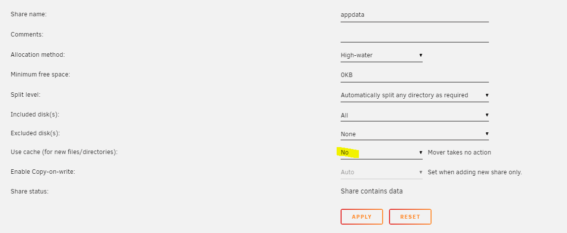

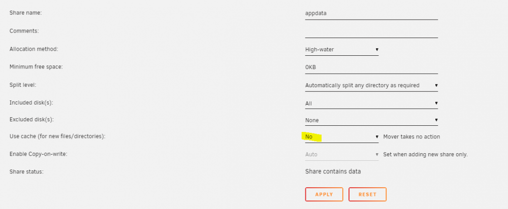

  2. I'm running into a strange situation where everytime I update SABnzbd I need to re-setup everything. As in I click update in the Unraid webui, it says update successful, then when I open the SABnzbd webui it has the configuration wizard, all my previous settings are lost. This has happened the past 2-3 updates, I just got a new update notification and I haven't run the update wondering if there is something I can do to keep from having to reconfigure everything?
  3. I don't have a cache drive, although I do sometimes get errors from the "Fix Common Problems" plugin stating an issue with Docker and the cache drive being set. I have mostly ignored it, since I do not have a cache drive. For reference here is that error: But I don't have a cache drive, and my appdata location is set to cache NO: Not sure if that helps at all.

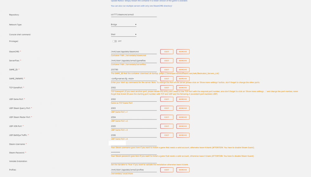

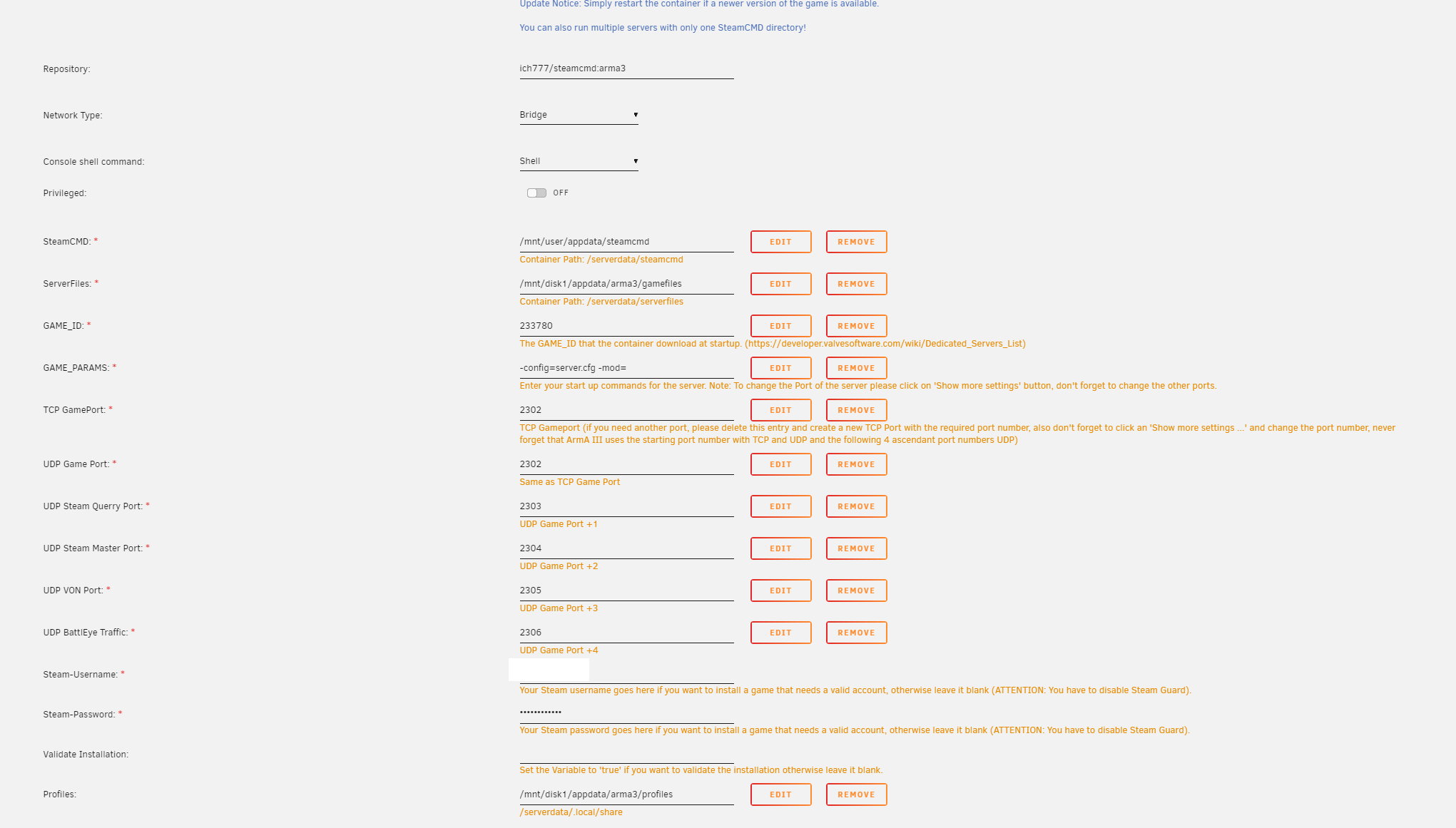

  4. Hi Ich777! Managed to get my Avorian server up and running successfully, but now I'm having difficulty running the Arma 3 server. I am having some issues grabbing a log full log, but this is a snippet which I feel has the error that's stopping the server from running:
  5. This worked! Thanks so much! I thought that since there wasn't a dedicated server in the Steam tools section you would need an account to make it run so I put in credientials to an account that owns the software!
