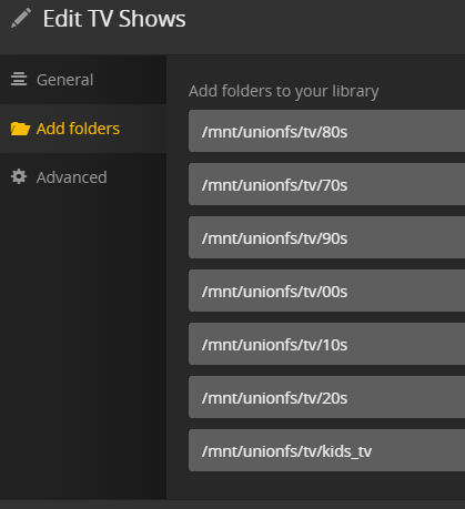

Note that I have not checked yet, but is there an option /flag / fork for strictly unencypted remotes? If not I might convert once you have settled everything down and perhaps it could sit in another branch?- Guide: How To Use Rclone To Mount Cloud Drives And Play Files
Well its very simple - I have a sonarr that looks after everything from 1980-1989 another for 1990-1999, 2000-20010 etc. Same for movies. Those are then structured the same way in teamdrives. `teamdrive_name:tv/1980s` and then it all comes together in a merger under `/mergerdir/tv`.- Guide: How To Use Rclone To Mount Cloud Drives And Play Files
You just set up mergerfs - you don't really have to do anything I use a bunch of different sonarrs and radarrs to manage my splits. Year based is the easiest because you can allow for that in the series level folder. And movie too. If you need some help with moving stuff between team drives I can help you there. The up loaders I guess can be switched but movies will not ever likely exceed the limit of a single drive. TV - I currently use four different team drives. five if you count anime.- Guide: How To Use Rclone To Mount Cloud Drives And Play Files
You may wish to consider the 400k object limit on teamdrives - this includes files / directories and stuff in the trash. An rclone move into a mergered MYDRIVE after upload can get you around that, but it's still another remote, and mydrive doesn't really support service accounts properly.- Guide: How To Use Rclone To Mount Cloud Drives And Play Files
I think you can easily use options other than numbering too - it works easiest for me, but random or alphanumeric would probably work too.- Guide: How To Use Rclone To Mount Cloud Drives And Play Files
Both -but it depends what you are doing - this was made to avoid api bans doing something like tdarr. So if you have a movies drive and a TV drive and so on, splitting them makes a block on one remote not affect the others. Did you look at my simple rgen script for config file? https://github.com/maximuskowalski/smount/blob/master/rgen.sh I use sometimes a few rclone.conf files and just swap them out. Different batches of service accounts from different projects. service_account_file = /opt/sa/76.json becomes service_account_file = /opt/sa2/76.json- Guide: How To Use Rclone To Mount Cloud Drives And Play Files
