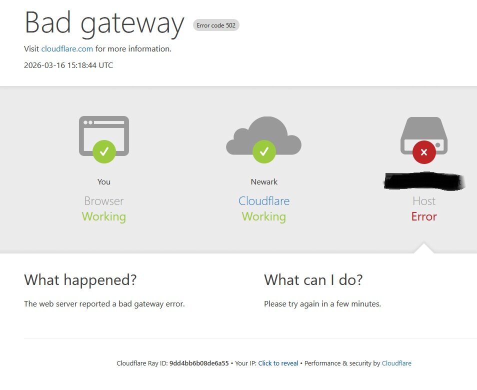

  1. Hi, thanks for your response. 10.55.83.191 is the ultimate webserver. The webserver in this case is a BlueIris webserver running in a Win11 VM that is located on the same unRAID machine that is running the NGINX docker under unRAID. After further testing, I see that upon stopping and starting BlueIris, things are working. I will wait until the next failure to see if I can glean anything from the BlueIris log. Cloudflair claims "The HTTP 502 error is coming from your origin web server and is not caused by Cloudflare."
  2. NGINX v2.14.0 works after unRAID reboot, some time later starts failing, with Cloudflare reporting Bad Gateway Error code 502: (This is a configuration that has worked correctly for the last year until recently) The error messages in the NGINX proxy-host-2_error.log: 2026/03/16 11:38:31 [error] 482#482: *16 recv() failed (104: Connection reset by peer) while reading response header from upstream, client: 162.158.155.156, server: APPLICATION.MYDOMAIN.net, request: "GET / HTTP/1.1", upstream: "http://10.55.83.191:8080/", host: "APPLICATION.MYDOMAIN.net" 2026/03/16 11:38:32 [error] 483#483: *18 recv() failed (104: Connection reset by peer) while reading response header from upstream, client: 104.23.187.209, server: APPLICATION.MYDOMAIN.net, request: "GET /ui3serviceworker.js?v=318-6.0.3.8 HTTP/1.1", upstream: "http://10.55.83.191:8080/ui3serviceworker.js?v=318-6.0.3.8", host: "APPLICATION.MYDOMAIN.net" 2026/03/16 11:38:33 [error] 484#484: *20 recv() failed (104: Connection reset by peer) while reading response header from upstream, client: 104.23.190.195, server: APPLICATION.MYDOMAIN.net, request: "GET /favicon.ico HTTP/1.1", upstream: "http://10.55.83.191:8080/favicon.ico", host: "APPLICATION.MYDOMAIN.net", referrer: "https://APPLICATION.MYDOMAIN.net/"

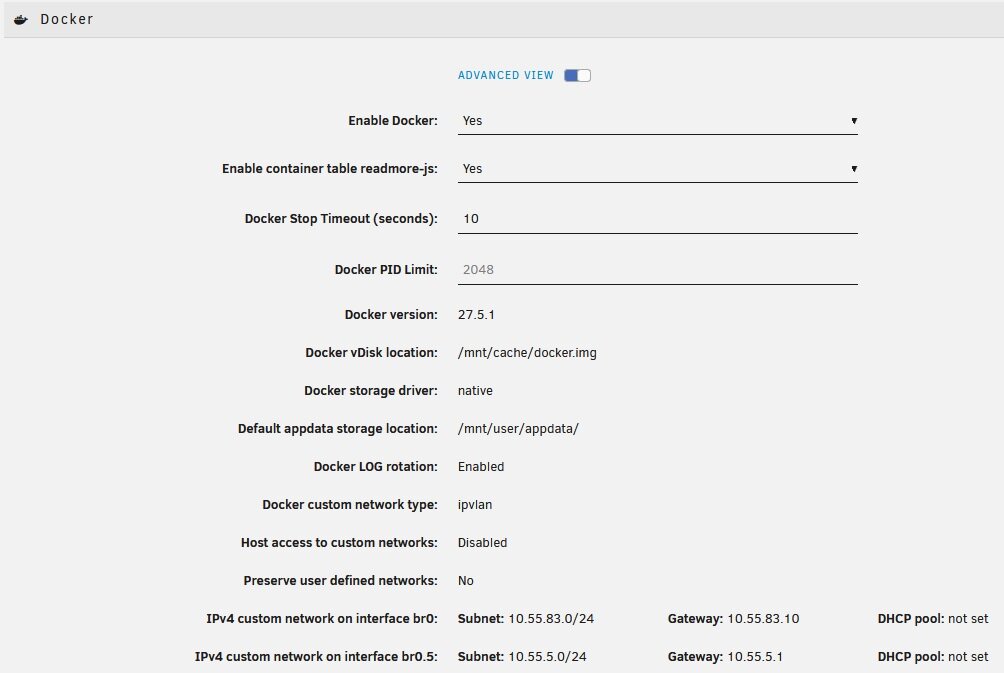

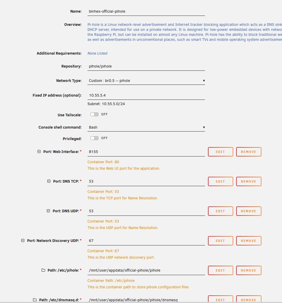

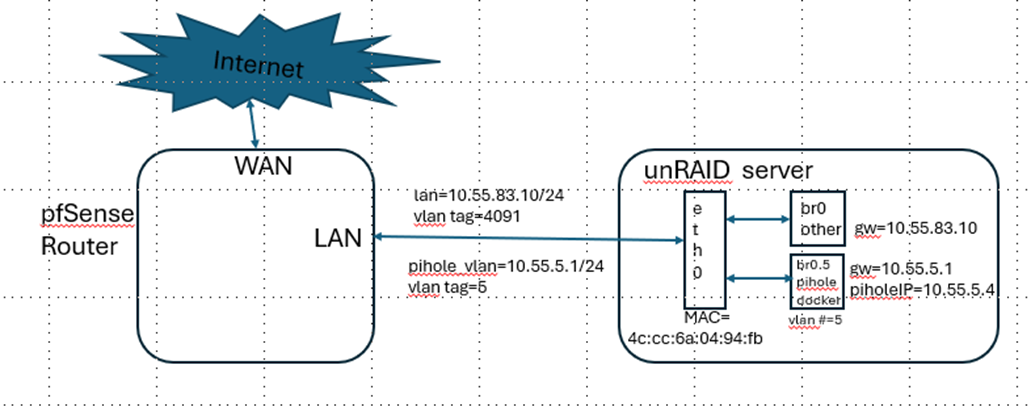

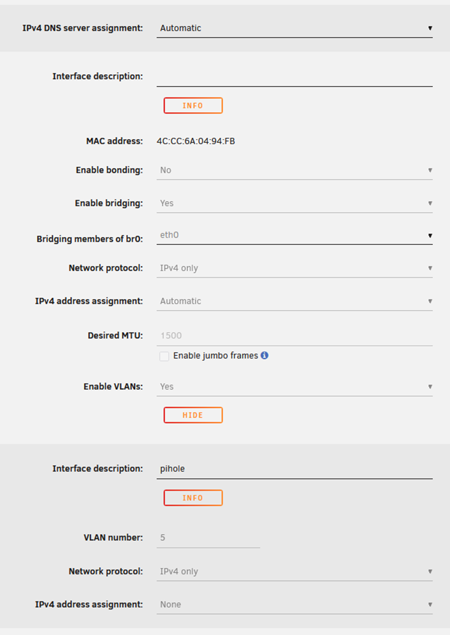

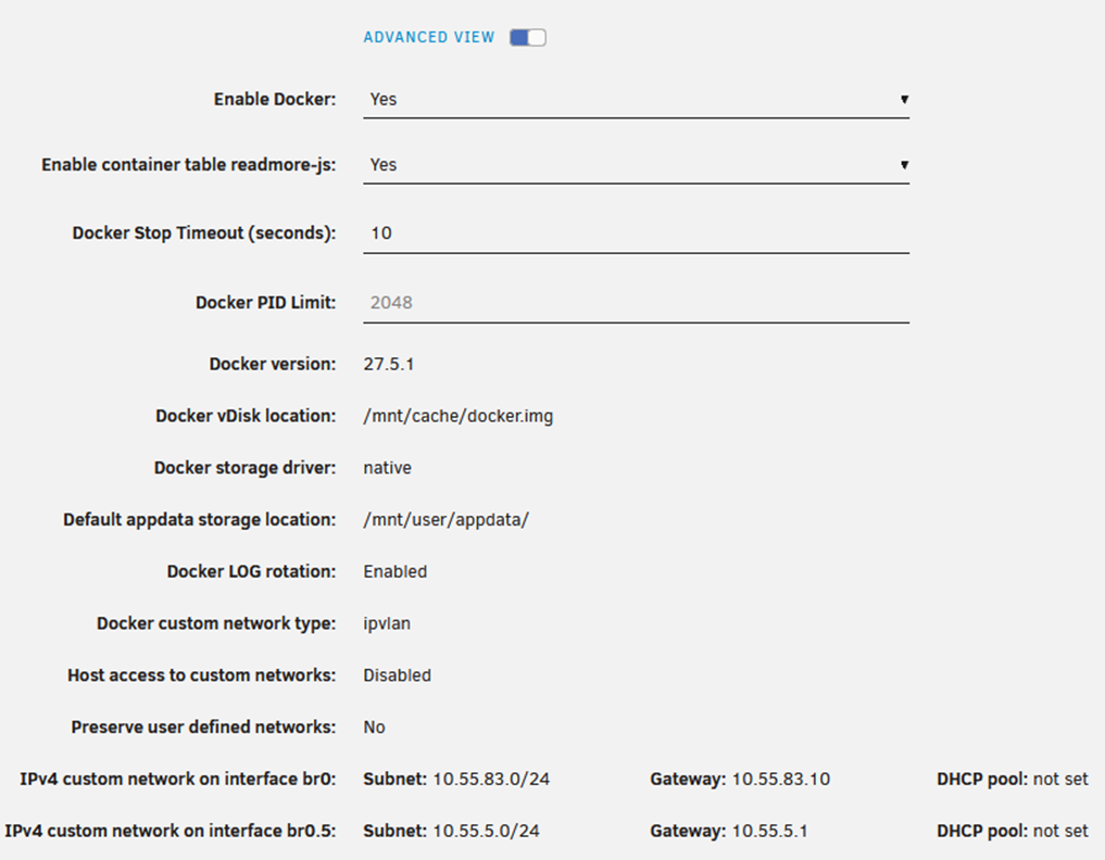

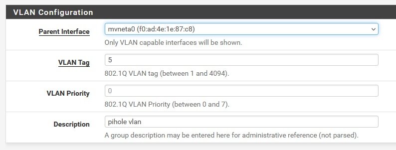

  4. I have created a docker container on a separate VLAN. When I attempt to ping the gateway defined for the vlan from the docker container console using that vlan, it is unsuccessful. I have a “pass any” firewall rule defined on the router, which is running pfSense, so the ping should be working. After crawling though all the settings many times, including the route tables, I don’t see what is wrong. Here is a block diagram, and screenshots of all of the settings. Any help from another set of eyes is much appreciated. The network and vlan settings in unRAID: The docker settings in unraid: The network configuration for the docker container that is using the vlan: Output from “ip a” from console of docker container that is using the vlan: 1: lo: <LOOPBACK,UP,LOWER_UP> mtu 65536 qdisc noqueue state UNKNOWN group default qlen 1000 link/loopback 00:00:00:00:00:00 brd 00:00:00:00:00:00 inet 127.0.0.1/8 scope host lo valid_lft forever preferred_lft forever inet6 ::1/128 scope host proto kernel_lo valid_lft forever preferred_lft forever 2: tunl0@NONE: <NOARP> mtu 1480 qdisc noop state DOWN group default qlen 1000 link/ipip 0.0.0.0 brd 0.0.0.0 32: eth0@if6: <BROADCAST,MULTICAST,UP,LOWER_UP> mtu 1500 qdisc noqueue state UNKNOWN group default link/ether 4c:cc:6a:04:94:fb brd ff:ff:ff:ff:ff:ff link-netnsid 0 inet 10.55.5.4/24 brd 10.55.5.255 scope global eth0 valid_lft forever preferred_lft forever Output from “route” from console of docker container that is using the vlan: Kernel IP routing table Destination Gateway Genmask Flags Metric Ref Use Iface default 10.55.5.1 0.0.0.0 UG 0 0 0 eth0 10.55.5.0 * 255.255.255.0 U 0 0 0 eth0 VLAN Configuration in the router: VLAN any-to-any firewall rule in the router Routing table entries of interest in the router:
  5. Thanks. I have changed that setting to Enabled, and unfortunately no change in behavior. I can not ping from the pihole_vlan console window to the gateway 10.55.5.1 . The output of ip route in the pihole_vlan console remains the same as previously posted: default via 10.55.5.1 dev eth0 10.55.5.0/24 dev eth0 proto kernel scope link src 10.55.5.4

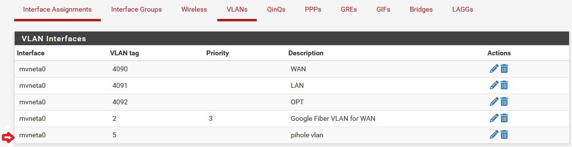

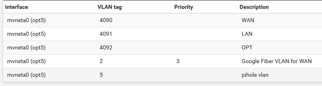

  6. 4091 is a reserved vlan id that pfSense uses for untagged traffic. I did not explicitly assign it. Docker containers using br0 can ping 10.55.83.1/24 without issue My pihole_vlan console (which uses br0.5) can not access 10.55.5.1, that is of course the problem I am trying to debug. (The console also can not access any numeric IPs on the WAN either.)

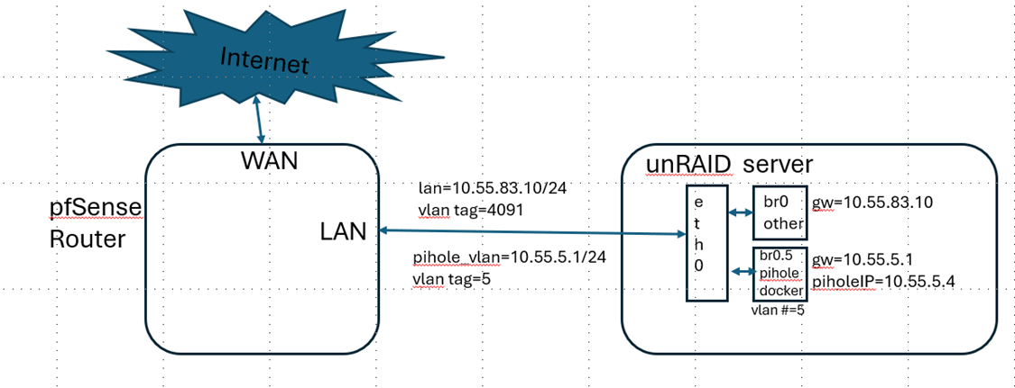

  7. Here is a picture of what I am trying to accomplish: So the current problem I am trying to debug is that in the pihole docker container console (10.55.5.4), a ping to 10.55.5.1 fails. It is my understanding that unRAID does no blocking between VLANs (please correct me if I am wrong), so we should need only a firewall rule in the router, which is in place and for testing is set to pass any to any: The routing tables in the router and in the pihole docker container console look ok (see prior postings). I must be missing something?
  8. Yes, I'm kind of stuck. Here is the output from a 'route' command run in the pihole_vlan docker container console (this shows a little more info than the 'ip route' command): Destination Gateway Genmask Flags Metric Ref Use Iface default 10.55.5.1 0.0.0.0 UG 0 0 0 eth0 10.55.5.0 * 255.255.255.0 U 0 0 0 eth0 The pihole_vlan is defined for docker as br0.5 . Is it ok that the interface in the table above shows as eth0, instead of br0.5 ? (The docker container is using br0.5 as its network interface, as shown in the picture further above. The only physical ethernet interface is eth0)

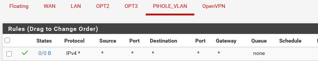

  9. Thank you. I'm not sure where you think the host access needs to be added? On the router, the firewall rule I showed on my previous post should allow the 10.55.5.1/24 vlan to access the WAN. I'm following directions from here, that specify using a different vlan for the pihole: https://www.vikash.nl/pi-hole-in-docker-container-on-separate-vlan/ I haven't got the pihole GUI working yet, right now I'm just trying to get the vlan to be able to access the WAN.

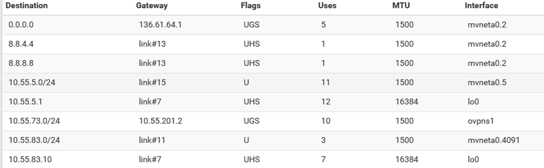

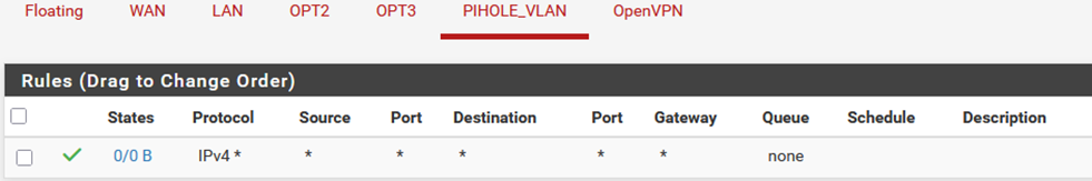

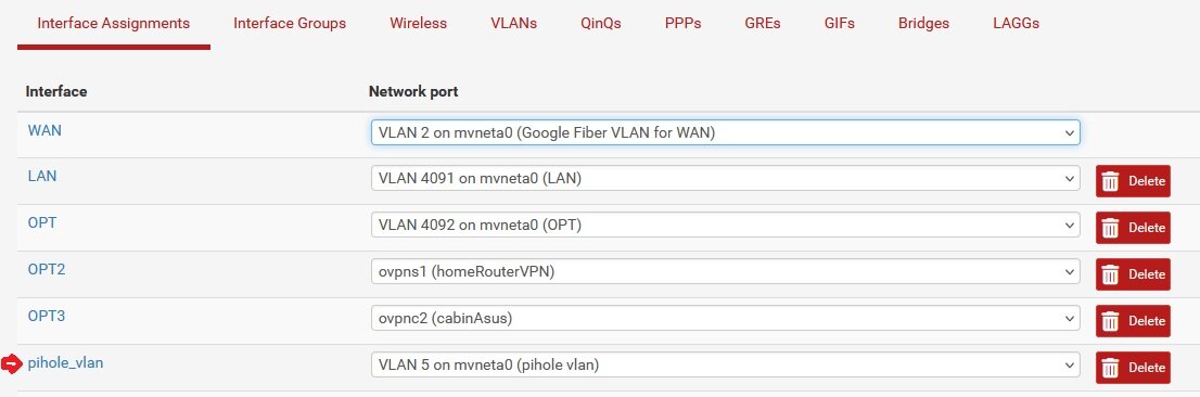

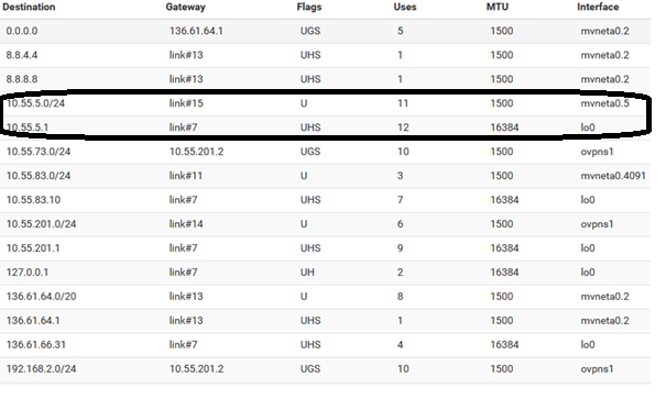

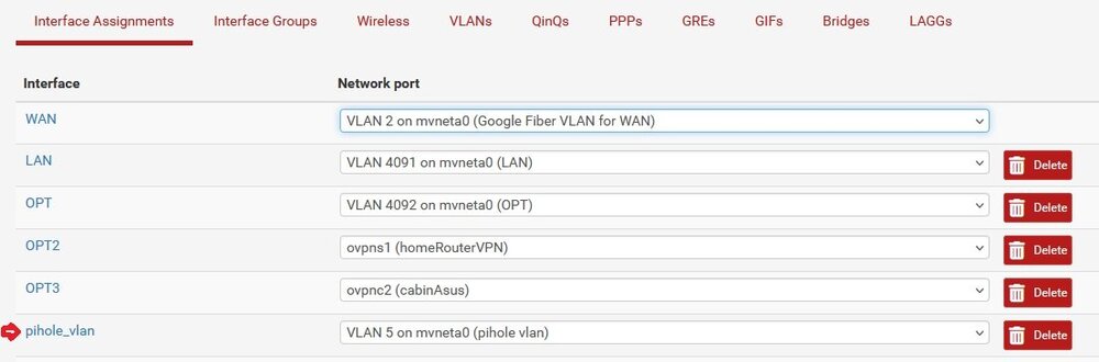

  10. I have stepped back to try and simply verify that I have pfSense properly configured to support the vlan (pihole_vlan) that I am using for the docker pihole container. In a console for the pihole docker container, the output of 'ip route show' looks correct: default via 10.55.5.1 dev eth0 10.55.5.0/24 dev eth0 proto kernel scope link src 10.55.5.4 In the console, a ping of the gateway (10.55.5.1) fails. In an attempt to debug, in pfSense, I have a pihole_vlan interface rule that I simplified to pass any protocol, any source, any destination: Here is the route table from pfSense, with the entries of interest circled. I am not understanding why the ping 10.55.5.1 in the docker console is not working?
