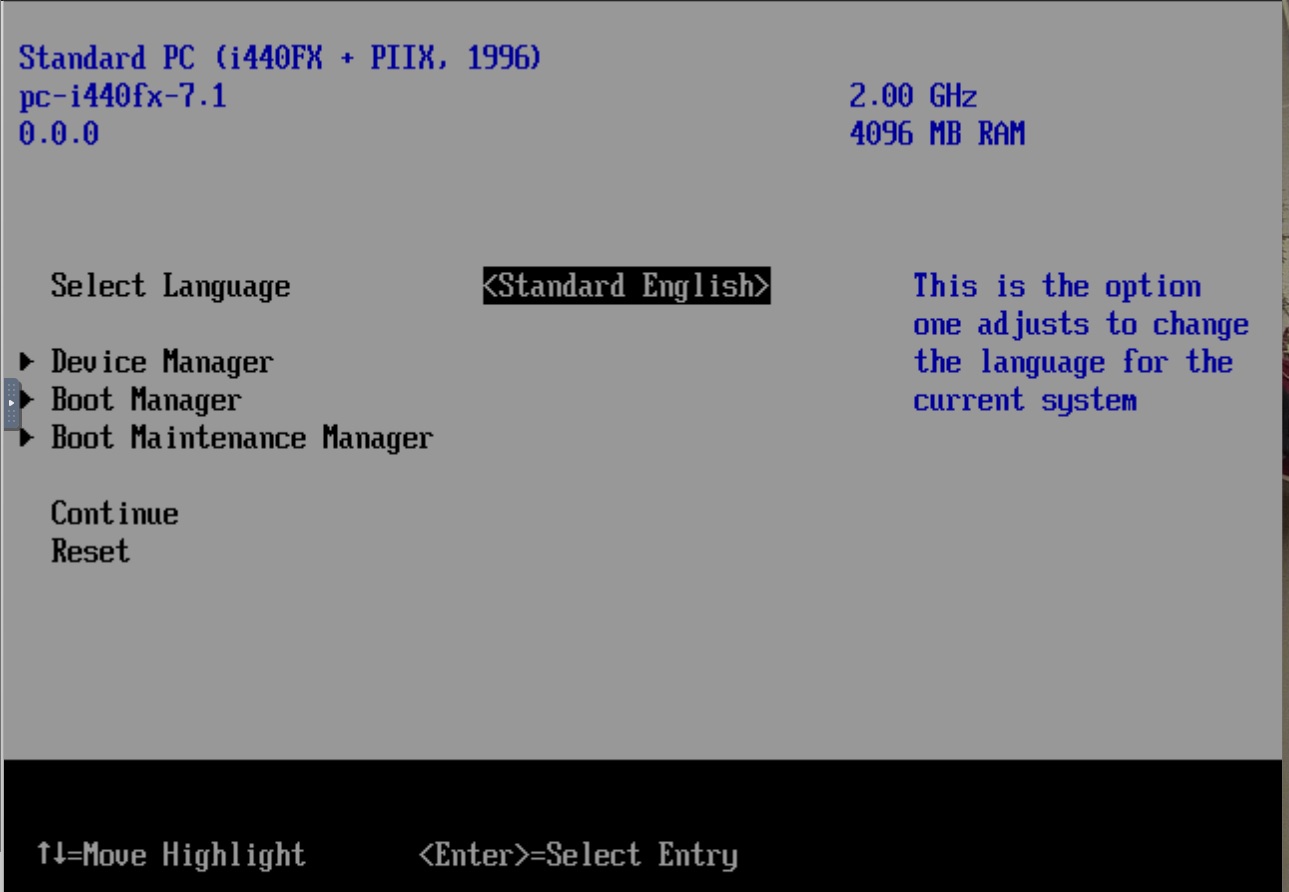

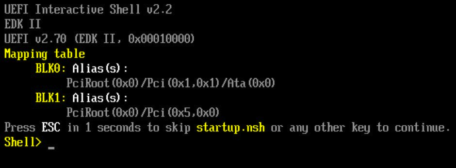

The ...vdisk1.img did have boot order 1, but the windows install *.iso did not have a boot order of 2. I also scrubbed through all of the settings in the forms view, and found a few things that were not the same as they previously were. I don't know if it is user error when I pasted in the prior xml, or if the mapping from xml to forms is not 100% complete or correct. In any case, windows is now booting.
Restoring Windows 11 VM - seeing this screen instead of windows boot?
I had a hardware problem with a cache pool that I have now fixed. I am attempting to restore a windows 11 VM. I have restored the backup *.img file: -rwxrwxrwx 1 root root 69793218560 Dec 8 16:34 /mnt/user/VM/Windows\ 10/vdisk1.img* I have created a new VM, and restored all the *.xml settings from the backup *.xml, while retaining the new values of <uuid>... and <nvram>... I also copied my backed up *.fd file to the location and name specified by those parameters: -rwxrwxrwx 1 root users 131072 Oct 17 09:58 /etc/libvirt/qemu/nvram/5a177830-4640-6f85-fed8-c2d284bb8488_VARS-pure-efi-tpm.fd* When I start the VM and open a VM console from the unraid dashboard, this is what I see instead of windows booting: If I enter exit in the screen above, I get this: I don't know how to debug this further. Thanks in advance for help.
