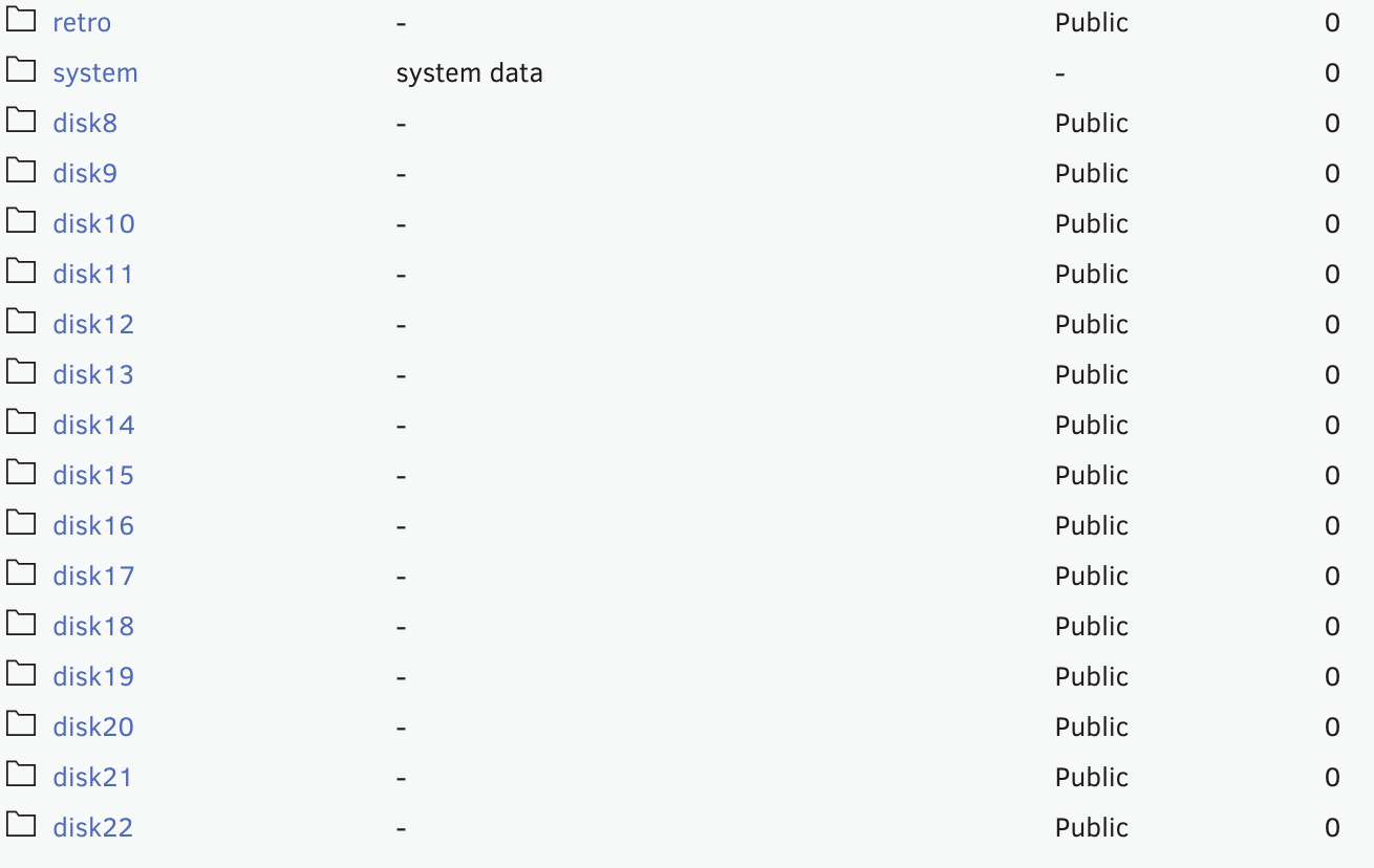

  1. just one more thing, did you try both: enable the global setting export disk shares while the array is offline and while it is online. I have a hunch that maybe toggling it when the array is offline screws up the assigned un/assigned logic?! Again just speculating?
  2. My best guess is that an older version of unraid is responsible. I first installed that server 4-5 years go with the then current version (don't remember which exacty). At the beginning i updated pretty quickly but then with 6.12.8 i stuck to that until now (7.2.2). This unfortunatly does not narrow it down very much..... but none of the previous version displayed those non existant disk shares. So if a previous version set the export flag then its code on the dashboard must have been more correct than the current code. If the setting of flag happened during the update from 6.12.8 to 7.2.2 then the cosmetic bug might have been hidden in the code for ages?! Maybe this observation helps?
  3. I do not know why they are set to e, but the system has been running for at least 4 years, so it went through many unraid updates. Also there was (and maybe still is) an option to toggle the export of disk shares globally. Maybe - and this is pure speculation - i toggled that with an old unraid version, and then the setting got applied to all slots even if not assigned (I had slots probably set to the max all the time). Then when i turned the global setting off and did it indivdually it only set the assigned disks correctly?! This is all just theorizing but its the only way i can imagine those export = e entries came about. I never had more slots populated then are currently in use, and i never meddled with any of the array config files. So it must have come through some menu interaction across many unraid updates?! Also as the shares -> disk shares page is always correct, the code there seems to check if a slot is unassigned, while dashboard does not. Maybe just change the dashboard code to mimic shares -> disk shares in enumarating shares?! That should solve it. That does not address how they got set to export => e in the first place, though Addendum: Also these shares are not really exported they do not show up when looking at the shares from another machine. So its a purely cosmetic bug in the Dashboard display code and/or a small bug that under some circumstances incorrectly sets the export => e for unassigned slots.
  4. I stopped the array, changed the number of slots from 22 to 9 (the slots 8 to 22 were all set to unassigned) and started the array. Now the dashboard is normal again, only the correct number of shares is shown. So i think that dashboard uses a different check to enumerate shares, it goes through all slots and displays all disk shares with export set to e regardless of being assigned or not. The shares->disk page does it correctly by skipping unassinged disks. This seems like a minor cosmetic bug. One question though, now that i set the number of slots to 9, lets say i want to add another harddrive, can i easily set it to higher numbers?
  5. Additionaly to those disk entries under tools vars, there are more: [sec] => Array ( [disk1] => Array ( [export] => - [caseSensitive] => auto [security] => public [readList] => [writeList] => [volsizelimit] => ) [disk2] => Array ( [export] => - [caseSensitive] => auto [security] => public [readList] => [writeList] => [volsizelimit] => ) [disk3] => Array ( [export] => - [caseSensitive] => auto [security] => public [readList] => [writeList] => [volsizelimit] => ) [disk4] => Array ( [export] => - [caseSensitive] => auto [security] => public [readList] => [writeList] => [volsizelimit] => ) [disk5] => Array ( [export] => - [caseSensitive] => auto [security] => public [readList] => [writeList] => [volsizelimit] => ) [disk6] => Array ( [export] => - [caseSensitive] => auto [security] => public [readList] => [writeList] => [volsizelimit] => ) [disk7] => Array ( [export] => - [caseSensitive] => auto [security] => public [readList] => [writeList] => [volsizelimit] => ) [disk8] => Array ( [export] => e [caseSensitive] => auto [security] => public [readList] => [writeList] => [volsizelimit] => ) [disk9] => Array ( [export] => e [caseSensitive] => auto [security] => public [readList] => [writeList] => [volsizelimit] => ) [disk10] => Array ( [export] => e [caseSensitive] => auto [security] => public [readList] => [writeList] => [volsizelimit] => ) [disk11] => Array ( [export] => e [caseSensitive] => auto [security] => public [readList] => [writeList] => [volsizelimit] => ) [disk12] => Array ( [export] => e [caseSensitive] => auto [security] => public [readList] => [writeList] => [volsizelimit] => ) [disk13] => Array ( [export] => e [caseSensitive] => auto [security] => public [readList] => [writeList] => [volsizelimit] => ) [disk14] => Array ( [export] => e [caseSensitive] => auto [security] => public [readList] => [writeList] => [volsizelimit] => ) [disk15] => Array ( [export] => e [caseSensitive] => auto [security] => public [readList] => [writeList] => [volsizelimit] => ) [disk16] => Array ( [export] => e [caseSensitive] => auto [security] => public [readList] => [writeList] => [volsizelimit] => ) [disk17] => Array ( [export] => e [caseSensitive] => auto [security] => public [readList] => [writeList] => [volsizelimit] => ) [disk18] => Array ( [export] => e [caseSensitive] => auto [security] => public [readList] => [writeList] => [volsizelimit] => ) [disk19] => Array ( [export] => e [caseSensitive] => auto [security] => public [readList] => [writeList] => [volsizelimit] => ) [disk20] => Array ( [export] => e [caseSensitive] => auto [security] => public [readList] => [writeList] => [volsizelimit] => ) [disk21] => Array ( [export] => e [caseSensitive] => auto [security] => public [readList] => [writeList] => [volsizelimit] => ) [disk22] => Array ( [export] => e [caseSensitive] => auto [security] => public [readList] => [writeList] => [volsizelimit] => ) [cache] => Array ( [export] => - [caseSensitive] => auto [security] => public [readList] => [writeList] => [volsizelimit] => )The disks in question (the ones that do not really exist) have all [export] => e set..... maybe thats in issue?
  6. Hi, testparm -v output below (minus the user shares which look normal). I think i might have found a different clue though. Under tools vars there are entries like this for disks 8 to 22. Exactly the ones displayed on the dashboard page (but strangely not under shares -> disk shares: [disk8] => Array ( [idx] => 8 [name] => disk8 [device] => [id] => [size] => 0 [sectors] => 0 [sector_size] => 0 [transport] => [rotational] => [discard] => [removable] => [spundown] => 0 [status] => DISK_NP [format] => - [temp] => * [numReads] => 0 [numWrites] => 0 [numErrors] => 0 [type] => Data [color] => grey-off [spindownDelay] => -1 [spinupGroup] => [idSb] => [sizeSb] => 0 [deviceSb] => [luksState] => 0 [fsType] => auto [fsStatus] => - [autotrim] => [compression] => [warning] => [critical] => [exportable] => no [comment] => [fsColor] => grey-off [fsEmpty] => no [fsSize] => 0 [fsFree] => 0 [fsUsed] => 0 ) So i conjecture, that these entries are correctly processed by shares/diskshares, but somehow confuse the main dashboard page. If these are normal entries or not for maybe older versions of unraid i have no idea. testparm -v: Load smb config files from /etc/samba/smb.conf lpcfg_do_global_parameter: WARNING: The "null passwords" option is deprecated Loaded services file OK. Weak crypto is allowed by GnuTLS (e.g. NTLM as a compatibility fallback) Server role: ROLE_STANDALONE Press enter to see a dump of your service definitions # Global parameters [global] abort shutdown script = acl claims evaluation = AD DC only ad dc functional level = 2008_R2 add group script = additional dns hostnames = add machine script = addport command = addprinter command = add share command = add user script = add user to group script = afs token lifetime = 604800 afs username map = aio max threads = 100 algorithmic rid base = 1000 allow dcerpc auth level connect = No allow dns updates = secure only allow insecure wide links = No allow nt4 crypto = No allow trusted domains = Yes allow unsafe cluster upgrade = No apply group policies = No async dns timeout = 10 async smb echo handler = No auth event notification = No auto services = binddns dir = /var/lib/samba/bind-dns bind interfaces only = Yes browse list = Yes cache directory = /var/cache/samba change notify = Yes change share command = check password script = client ipc max protocol = default client ipc min protocol = default client ipc signing = default client lanman auth = No client ldap sasl wrapping = seal client max protocol = default client min protocol = SMB2_02 client netlogon ping protocol = cldap client NTLMv2 auth = Yes client plaintext auth = No client protection = default client schannel = Yes client signing = default client smb encrypt = default client smb3 encryption algorithms = AES-128-GCM, AES-128-CCM, AES-256-GCM, AES-256-CCM client smb3 signing algorithms = AES-128-GMAC, AES-128-CMAC, HMAC-SHA256 client smb transports = tcp, nbt client use kerberos = desired client use krb5 netlogon = default client use spnego = Yes cluster addresses = clustering = No config backend = file config file = create krb5 conf = Yes ctdbd socket = ctdb locktime warn threshold = 0 ctdb timeout = 0 cups connection timeout = 30 cups encrypt = No cups server = dcerpc endpoint servers = epmapper, wkssvc, samr, netlogon, lsarpc, drsuapi, dssetup, unixinfo, browser, eventlog6, backupkey, dnsserver deadtime = 10080 debug class = No debug encryption = No debug hires timestamp = Yes debug pid = No debug prefix timestamp = No debug syslog format = No winbind debug traceid = Yes debug uid = No dedicated keytab file = default service = defer sharing violations = Yes delete group script = deleteprinter command = delete share command = delete user from group script = delete user script = dgram port = 138 disable netbios = No disable spoolss = Yes dns hostname = dns forwarder = dns port = 53 dns proxy = Yes dns update command = /usr/sbin/samba_dnsupdate dns zone scavenging = No dns zone transfer clients allow = dns zone transfer clients deny = domain logons = No domain master = Auto dos charset = CP850 dsdb event notification = No dsdb group change notification = No dsdb password event notification = No enable asu support = No enable core files = Yes enable privileges = Yes encrypt passwords = Yes enhanced browsing = Yes enumports command = eventlog list = get quota command = getwd cache = Yes gpo update command = /usr/sbin/samba-gpupdate guest account = nobody himmelblaud hello enabled = No himmelblaud hsm pin path = /var/lib/himmelblaud/hsm-pin himmelblaud sfa fallback = No host msdfs = Yes hostname lookups = No idmap backend = tdb idmap cache time = 604800 idmap gid = idmap negative cache time = 120 idmap uid = include system krb5 conf = Yes init logon delay = 100 init logon delayed hosts = interfaces = 192.168.178.30/24 127.0.0.1 iprint server = kdc default domain supported enctypes = 0 kdc enable fast = Yes kdc force enable rc4 weak session keys = No kdc supported enctypes = 0 keepalive = 300 kerberos encryption types = all kerberos method = default kernel change notify = Yes kpasswd port = 464 krb5 port = 88 lanman auth = No large readwrite = Yes ldap admin dn = ldap connection timeout = 2 ldap debug level = 0 ldap debug threshold = 10 ldap delete dn = No ldap deref = auto ldap follow referral = Auto ldap group suffix = ldap idmap suffix = ldap machine suffix = ldap max anonymous request size = 256000 ldap max authenticated request size = 16777216 ldap max search request size = 256000 ldap page size = 1000 ldap passwd sync = no ldap replication sleep = 1000 ldap server require strong auth = Yes ldap ssl = start tls ldap suffix = ldap timeout = 15 ldap user suffix = lm announce = Auto lm interval = 60 load printers = No local master = Yes lock directory = /var/cache/samba lock spin time = 200 log file = logging = syslog@0 log level = 1 log nt token command = logon drive = logon home = \\%N\%U logon path = \\%N\%U\profile logon script = log writeable files on exit = No lpq cache time = 30 lsa over netlogon = No machine password timeout = 604800 mangle prefix = 1 mangling method = hash2 map to guest = Bad User max disk size = 0 max log size = 5000 max mux = 50 max open files = 40960 max smbd processes = 0 max stat cache size = 512 max ttl = 259200 max wins ttl = 518400 max xmit = 16644 mdns name = netbios message command = min domain uid = 1000 min receivefile size = 0 min wins ttl = 21600 mit kdc command = multicast dns register = No name cache timeout = 660 name resolve order = lmhosts wins host bcast nbt client socket address = 0.0.0.0 nbt port = 137 ncalrpc dir = /var/run/samba/ncalrpc netbios aliases = netbios name = TOWER-II netbios scope = neutralize nt4 emulation = No nmbd bind explicit broadcast = No nsupdate command = /usr/bin/nsupdate -g nt hash store = always ntlm auth = ntlmv1-permitted nt pipe support = Yes ntp signd socket directory = /var/lib/samba/ntp_signd nt status support = Yes null passwords = Yes obey pam restrictions = No old password allowed period = 60 oplock break wait time = 0 os2 driver map = os level = 100 pam password change = No panic action = passdb backend = smbpasswd passdb expand explicit = No passwd chat = newpassword* %n\n newpassword* %n\n changed passwd chat debug = No passwd chat timeout = 2 passwd program = password hash gpg key ids = password hash userPassword schemes = password server = * perfcount module = pid directory = /var/run preferred master = Auto prefork backoff increment = 10 prefork children = 4 prefork maximum backoff = 120 preload modules = printcap cache time = 750 printcap name = /dev/null private dir = /var/lib/samba/private raw NTLMv2 auth = No read raw = Yes realm = registry shares = No reject aes netlogon servers = No reject md5 clients = Yes reject md5 servers = Yes remote announce = remote browse sync = rename user script = require strong key = Yes reset on zero vc = No restrict anonymous = 0 root directory = rpc big endian = No rpc server dynamic port range = 49152-65535 rpc server port = 0 rpc start on demand helpers = Yes samba kcc command = /usr/sbin/samba_kcc security = USER server max protocol = SMB3 server min protocol = NT1 server multi channel support = Yes server reject aes schannel = No server role = auto server schannel = Yes server schannel require seal = Yes server services = s3fs, rpc, nbt, wrepl, ldap, cldap, kdc, drepl, ft_scanner, winbindd, ntp_signd, kcc, dnsupdate, dns server signing = if_required server smb3 encryption algorithms = AES-128-GCM, AES-128-CCM, AES-256-GCM, AES-256-CCM server smb3 signing algorithms = AES-128-GMAC, AES-128-CMAC, HMAC-SHA256 server smb transports = tcp, nbt server string = Media server server support krb5 netlogon = No set primary group script = set quota command = show add printer wizard = No shutdown script = smb1 unix extensions = No smb2 disable lock sequence checking = No smb2 disable oplock break retry = No smb2 leases = Yes smb2 max credits = 8192 smb2 max read = 8388608 smb2 max trans = 8388608 smb2 max write = 8388608 smb3 directory leases = No smbd profiling level = off smb passwd file = /var/lib/samba/private/smbpasswd socket options = TCP_NODELAY spn update command = /usr/sbin/samba_spnupdate stat cache = Yes state directory = /var/lib/samba svcctl list = sync machine password script = sync machine password to keytab = syslog = 1 syslog only = No template homedir = /home/%D/%U template shell = /bin/false time server = No timestamp logs = Yes tls ca directories = tls cafile = tls/ca.pem tls certfile = tls/cert.pem tls crlfile = tls dh params file = tls enabled = Yes tls keyfile = tls/key.pem tls priority = NORMAL:-VERS-SSL3.0 tls trust system cas = No tls verify peer = as_strict_as_possible unicode = Yes unix charset = UTF-8 unix password sync = No use mmap = Yes username level = 0 username map = username map cache time = 0 username map script = usershare allow guests = No usershare max shares = 0 usershare owner only = Yes usershare path = /var/lib/samba/usershares usershare prefix allow list = usershare prefix deny list = usershare template share = utmp = No utmp directory = winbind cache time = 300 winbindd socket directory = /var/run/samba/winbindd winbind enum groups = No winbind enum users = No winbind expand groups = 0 winbind max clients = 200 winbind max domain connections = 1 winbind nested groups = Yes winbind normalize names = No winbind nss info = template winbind offline logon = No winbind reconnect delay = 30 winbind refresh tickets = No winbind request timeout = 60 winbind rpc only = No winbind scan trusted domains = No winbind sealed pipes = Yes winbind separator = \ winbind use default domain = No winbind use krb5 enterprise principals = Yes winbind varlink service = No wins hook = wins proxy = No wins server = wins support = No workgroup = WORKGROUP write raw = Yes wsp property file = wtmp directory = fruit:nfs_aces = No idmap config * : range = 3000-7999 idmap config * : backend = tdb access based share enum = No acl allow execute always = Yes acl check permissions = Yes acl flag inherited canonicalization = Yes acl group control = No acl map full control = Yes administrative share = No admin users = afs share = No aio read size = 0 aio write behind = aio write size = 0 allocation roundup size = 0 available = Yes blocking locks = Yes block size = 1024 browseable = Yes case sensitive = Auto check parent directory delete on close = No comment = copy = create mask = 0777 csc policy = manual cups options = default case = lower default devmode = Yes delete readonly = No delete veto files = No dfree cache time = 0 dfree command = directory mask = 0777 dmapi support = No dont descend = dos filemode = No dos filetime resolution = No dos filetimes = Yes durable handles = Yes ea support = Yes fake directory create times = No fake oplocks = No follow symlinks = Yes smbd force process locks = No force create mode = 0000 force directory mode = 0000 force group = force printername = No force unknown acl user = No force user = fstype = NTFS guest ok = No guest only = No hide dot files = No hide files = hide new files timeout = 0 hide special files = No hide unreadable = No hide unwriteable files = No honor change notify privilege = No hosts allow = hosts deny = include = /etc/samba/smb-shares.conf inherit acls = No inherit owner = no inherit permissions = No invalid users = root kernel oplocks = No kernel share modes = No level2 oplocks = Yes locking = Yes lppause command = lpq command = lpq -P'%p' lpresume command = lprm command = lprm -P'%p' %j magic output = magic script = mangled names = illegal mangling char = ~ map acl inherit = No map archive = Yes map hidden = No map readonly = no map system = No max connections = 0 max print jobs = 1000 max reported print jobs = 0 min print space = 0 msdfs proxy = msdfs root = No msdfs shuffle referrals = No nt acl support = Yes ntvfs handler = unixuid, default oplocks = Yes path = posix locking = Yes postexec = preexec = preexec close = No preserve case = Yes printable = No print command = lpr -r -P'%p' %s printer name = printing = bsd printjob username = %U print notify backchannel = No queuepause command = queueresume command = read list = read only = Yes root postexec = root preexec = root preexec close = No server addresses = server smb encrypt = default short preserve case = Yes smb3 unix extensions = Yes smbd async dosmode = No smbd getinfo ask sharemode = Yes smbd max async dosmode = 0 smbd max xattr size = 65536 smbd profiling share = No smbd search ask sharemode = Yes spotlight = No spotlight backend = noindex store dos attributes = Yes strict allocate = No strict locking = Auto strict rename = No strict sync = Yes sync always = No use client driver = No use sendfile = Yes valid users = veto files = veto oplock files = vfs mkdir use tmp name = Auto vfs objects = volume = volume serial number = -1 wide links = Yes write list =
  7. Here are the diagnostics. So i assume this problem is not known?tower-ii-diagnostics-20251217-0711.zip
  8. Hi, just updated from 6.12.8 to 7.2.2. The update seems to work and all major functions seem to be intact. There a a couple of minor issues: 1) The main page shows disk shares that are not even connected (see screenshot). There are not disks 8 - 22 in the system, and yet it displays those as public. If i go to the disk shares tab, everything is normal (just disks 1-7 and cache). 2) I get this error in the system log: Dec 16 18:07:44 Tower-II root: error log : /var/log/graphql-api.log. It seems to have no consequence though. 3) I get these warnings, anybody know what they mean: Dec 16 18:06:35 Tower-II kernel: c3xxx 0000:01:00.0: Failed to send admin msg 3 to accelerator 2 Dec 16 18:06:35 Tower-II kernel: c3xxx 0000:01:00.0: Failed to send init message Dec 16 18:06:35 Tower-II kernel: c3xxx 0000:01:00.0: qat_dev0 stopped 6 acceleration engines Dec 16 18:06:35 Tower-II kernel: c3xxx 0000:01:00.0: Resetting device qat_dev0 Dec 16 18:06:35 Tower-II kernel: c3xxx 0000:01:00.0: probe with driver c3xxx failed with error -14
