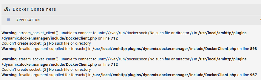

  10. I figured it out. I have two Unraid servers and used to use Portainer. I had it setup for one instance of Portainer to be able to manage both servers. I had added this line to the docker.cfg to allow docker to be managed remotely. DOCKER_OPTS="-H unix:///var/run/diocker.sock -H tcp://0.0.0.0:2376" I removed this line and it appears to be working now. Not sure why this decided to be a problem now. I stopped using Portainer awhile ago and have rebooted unraid since then. 🤷‍♂️

  14. Lost power for less than a second and the unraid server went down. Rebooted and now I'm seeing this error. I've tried the most common solutions to this error by recreated docker.img, recreated the USB stick, and ran a memtest (passed). Nothing seems to fix it so it must be something else. alderaan-diagnostics-20230122-2048.zip
