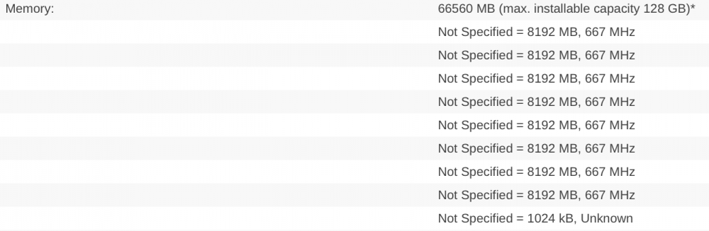

  6. On the 64GB = 65536 MB. part? I agree that 65536MB is refferd to 64GB got confused with the google conversion - see attached photo. But what about the Dynamix System Info that shows 66560 MB ram is installed? And what about the Not Specified = 1024 kB, Unknown part in Memory? Pointing out the obvious dosen't help, 64GB is 64GB, but some parts of the system is showing more than 64GB, it shows 66.56GB. So, what going on? I'm new at unRAID so again - the diagnostics is the diagnostics under tools in the GUI then?

  10. SO. Back to "topic". In the Dynamix System Info it shows: 66560 MB installed, and 128GB as max (with the riser card that i don't have installed) Not Specified = 8192 MB, 667 MHz Not Specified = 8192 MB, 667 MHz Not Specified = 8192 MB, 667 MHz Not Specified = 8192 MB, 667 MHz Not Specified = 8192 MB, 667 MHz Not Specified = 8192 MB, 667 MHz Not Specified = 8192 MB, 667 MHz Not Specified = 8192 MB, 667 MHz Not Specified = 1024 kB, Unknown on the dashboard it says 65,536 MB (max. 64 GB). Any clue on why that is? Also, as i now running full 8*8GB Docker and VMs and more is not working, but replacing anyone of the 8 men sticks with a <8GB ram fixes this.

  13. So a couple of days ago i received my RAM upgrade, 64GB of joy I installed it an went on doing other stuff. yesterday when i finally got the time to play with my unRAID server i saw it behaving weird, and over the last 24+ hours it has been reformatted, had new usb drive installed and so on and still - very unstable and weird behavior. Today i realized that on the "dashboard" in the GUI it says MAX 64GB Ram and it got 65,xxx installed - WT* - it got 8*8GB ram. So uncliped 2*8GB ram and ... it seems to run fine now. So what's going on? 65GB ram on 8*8GB ram sticks? And is it why unRAID is spazzing out? Server is HP xw8600 supports 8*8GB ram or 16*8GB ram with an riser.
