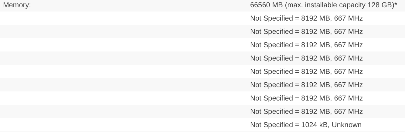

In the Dynamix System Info it shows: 66560 MB installed, and 128GB as max (with the riser card that i don't have installed)
Not Specified = 8192 MB, 667 MHz
Not Specified = 1024 kB, Unknown

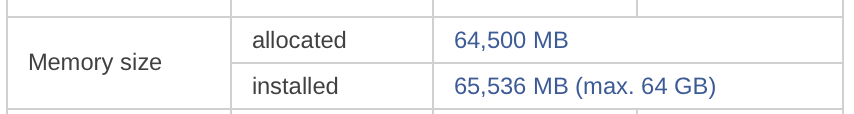

on the dashboard it says 65,536 MB (max. 64 GB).
Any clue on why that is?

So what about the 66560 MB installed ram then?
I agree with BRiT on that....

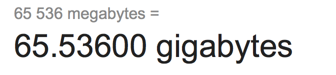

On the 64GB = 65536 MB. part? I agree that 65536MB is refferd to 64GB got confused with the google conversion - see attached photo.
But what about the Dynamix System Info that shows 66560 MB ram is installed? And what about the Not Specified = 1024 kB, Unknown part in Memory?

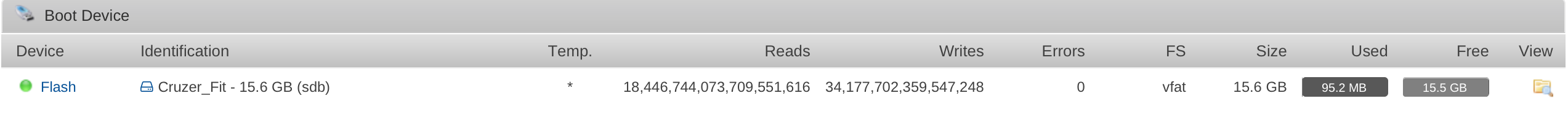

Something is up with you flash drive. Run chkdsk on it in a windows PC or try another.
Just did it, it came back saying: Windows has checked the file system and found no problems.
It's a completely new flashdisk, but again unRAID is doing some weird stuff when i run *8*8GB - see attachment (uptime 5mins).
