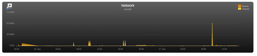

  1. I've noticed some weirdness where the Stats plugin shows impossible spikes on my Bonded (2x1Gb) Ethernet connection (attached image). Is this something that has been discussed? Searches on the forum were a little messy and I wasn't able to find much useful information. Thanks!
