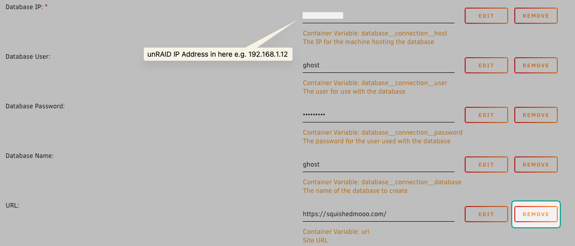

  18. Cool I think I understand what is going on here. My first suggestion would be to not install MySQL. MariaDB is an opensource implementation of MySQL, so 99% of the time any application that can connect and use a MySQL database can also use a MariaDB database. So what I would do is set Ghost to use your MariaDB instance. Setup is the same. I'll put a screenshot of my config below for reference. Database IP is the IP address of the machine running MariaDB. I assume your unRAID machine. So something like 192.168.1.45 or whatever your IP scheme is. Database user and password are self explanatory. Database name is the name of the database within MariaDB you wish Ghost to use. The other issue you seem to be having is with the URL setting. If you are running a blog that can not be accessed from a domain name then leave it blank. If that fails then I would remove the variable entirely. Just click the remove button on the right hand side. If you ever plan to open your Ghost blog up to the internet, you will need to set this to the domain name your site will be reachable from. In my case it is `https://squishedmooo.com/` Note that as the error suggests, you need to include a protocol in the URL. https is correct for the most part. I hope that helps, but if you have any more questions, just shout.
