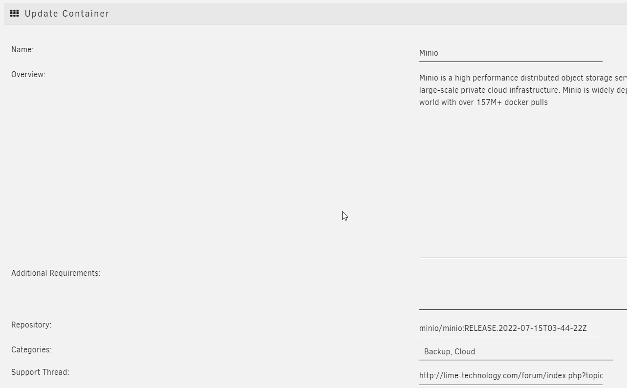

@TheSnotRocket I just saw that my Minio had also stopped with the same error as yours. I rolled back to version RELEASE.2022-07-15T03-44-22Z and it is working again. Probably worth a shot for you to try.

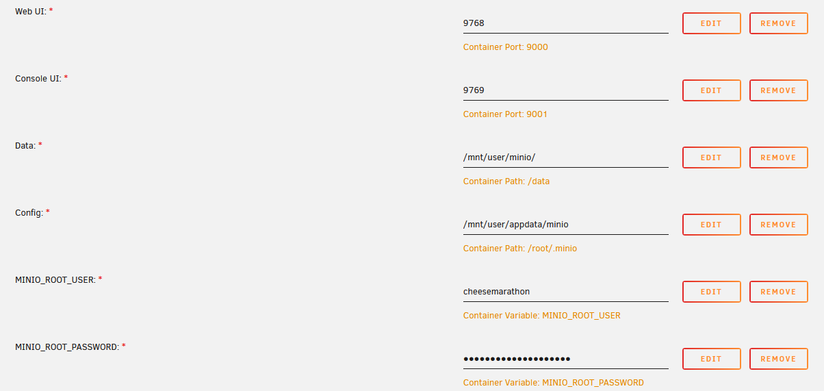

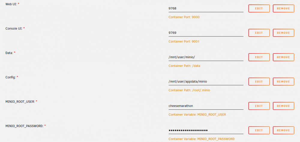

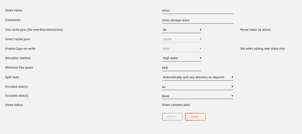

I run backups to my Minio instance every night without issue. So here is my minio config and my share config that i backup to. As for and issue with my version, the only thing I have done is created the template. It uses the official https://hub.docker.com/r/minio/minio/ container image. So the issue lies somewhere with its use specifically on unRAID. Failing spotting any issues with the above, I would look at raising an issue on the Minio github. I would stick as much of your logs as you can in a pastebin for the guys over there.
