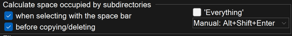

  8. I never use Windows Explorer. I only use Total Commander. I checked with Explorer and you are right. So TC is overriding somehow and manages to perform a Shift-Delete on the server.

    It seems I was very lucky. The directory I inadvertently shift-deleted is several tera worth. So Total Commander had to "calculate" the occupied space to delete. It seems I stopped the process fast enough. But this thing has to be prevented in the future. I added a suggestion in the Recycle Bin plugin.
