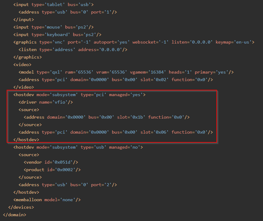

What? Look man, trust me the line that i've show you in the red box, are the line for the audio card.
***GUIDE*** How to passthrough Intel chipset audio
Windows 10 Config : Remove those lines. You don't need to do anything else. The XML files doesn't keep the modification exactly where you place them. So look carefully and try to focus on one thing at the time.
The code lines are present, look at the end of the device section. Remove the hostdev completely from one of the VM. No, don't do that.
First of all it is very weird that thoses XML doesn't appears. However, if you edit something with the form view (try changing the USB setting) and save it. This will overwrite any XML modification. This should reset the XML to the base configuration. You should also try to do a power cycle after this modification. (remove the power plug)
You can only use the audio device with 1 VM at the time. The configuration seems to be working. Also, when playing with embedded motherboard device, sometimes it require to remove the power completely (remove the AC Plug). Exactly, Form View overwrite XML edit. If you want to run both of them at the same time, you need the remove the audio card in one of the XML.
