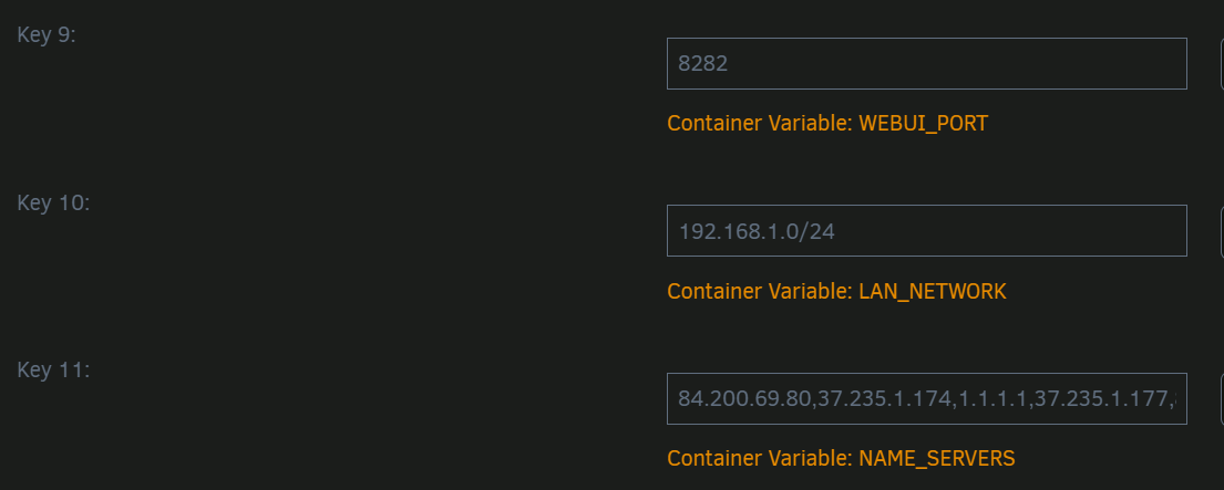

  2. Anyone have any ideas? The Web UI just won't load. I've disabled the VPN so that strikes that out. 2024-04-15 04:58:27.853379 [info] Host is running unRAID 2024-04-15 04:58:27.885629 [info] System information Linux 222c668176a2 5.19.17-Unraid #2 SMP PREEMPT_DYNAMIC Wed Nov 2 11:54:15 PDT 2022 x86_64 GNU/Linux 2024-04-15 04:58:27.922436 [info] PUID defined as '99' 2024-04-15 04:58:28.008334 [info] PGID defined as '100' 2024-04-15 04:58:28.125813 [info] UMASK defined as '000' 2024-04-15 04:58:28.169173 [info] Permissions already set for '/config' 2024-04-15 04:58:28.209140 [info] Deleting files in /tmp (non recursive)... 2024-04-15 04:58:28.258098 [info] VPN_ENABLED defined as 'no' 2024-04-15 04:58:28.282725 [warn] !!IMPORTANT!! VPN IS SET TO DISABLED', YOU WILL NOT BE SECURE 2024-04-15 04:58:28.321015 [info] WEBUI_PORT defined as '8282' 2024-04-15 04:58:28.358829 [info] Starting Supervisor... 2024-04-15 04:58:28,769 INFO Included extra file "/etc/supervisor/conf.d/qbittorrent.conf" during parsing 2024-04-15 04:58:28,770 INFO Set uid to user 0 succeeded 2024-04-15 04:58:28,775 INFO supervisord started with pid 7 2024-04-15 04:58:29,777 INFO spawned: 'start-script' with pid 62 2024-04-15 04:58:29,779 INFO spawned: 'watchdog-script' with pid 63 2024-04-15 04:58:29,780 INFO reaped unknown pid 8 (exit status 0) 2024-04-15 04:58:29,800 DEBG 'start-script' stdout output: [info] VPN not enabled, skipping configuration of VPN 2024-04-15 04:58:29,800 INFO success: start-script entered RUNNING state, process has stayed up for > than 0 seconds (startsecs) 2024-04-15 04:58:29,800 INFO success: watchdog-script entered RUNNING state, process has stayed up for > than 0 seconds (startsecs) 2024-04-15 04:58:29,800 DEBG fd 8 closed, stopped monitoring <POutputDispatcher at 22364966405840 for <Subprocess at 22364969660432 with name start-script in state RUNNING> (stdout)> 2024-04-15 04:58:29,801 DEBG fd 10 closed, stopped monitoring <POutputDispatcher at 22364966397200 for <Subprocess at 22364969660432 with name start-script in state RUNNING> (stderr)> 2024-04-15 04:58:29,801 INFO exited: start-script (exit status 0; expected) 2024-04-15 04:58:29,801 DEBG received SIGCHLD indicating a child quit 2024-04-15 04:58:29,819 DEBG 'watchdog-script' stdout output: [info] qBittorrent not running 2024-04-15 04:58:29,820 DEBG 'watchdog-script' stdout output: [info] qBittorrent config file already exists, skipping copy [info] Removing session lock file (if it exists)... 2024-04-15 04:58:29,879 DEBG 'watchdog-script' stdout output: [info] Attempting to start qBittorrent... 2024-04-15 04:58:29,885 DEBG 'watchdog-script' stdout output: [info] qBittorrent process started [info] Waiting for qBittorrent process to start listening on port 8282... 2024-04-15 04:58:30,330 DEBG 'watchdog-script' stdout output: [info] qBittorrent process listening on port 8282
