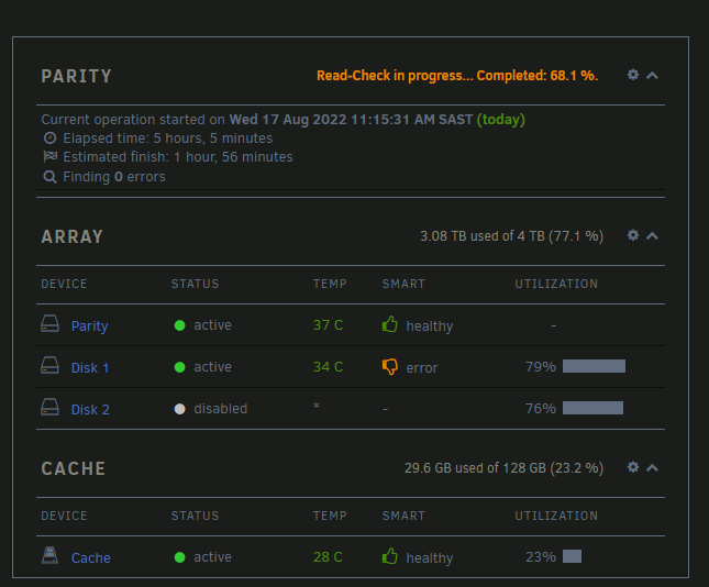

The Dashboard warning is for UDMA CRC, which is connection problem some time in the past. You can acknowledge it by clicking 👎
and it will warn again if it increases.
Since it is WD disk I am wondering about attributes 1 and 200 for that disk.
Why are you doing read-check?

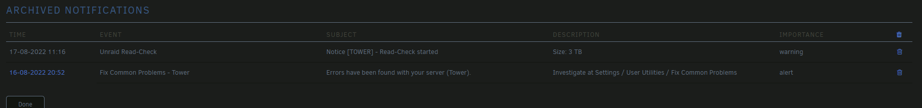

Sorry, this is what I see.
I actually cancelled that check now

23 minutes ago, trurl said:
Notifications setup to alert you by email or other agent as soon as a problem is detected

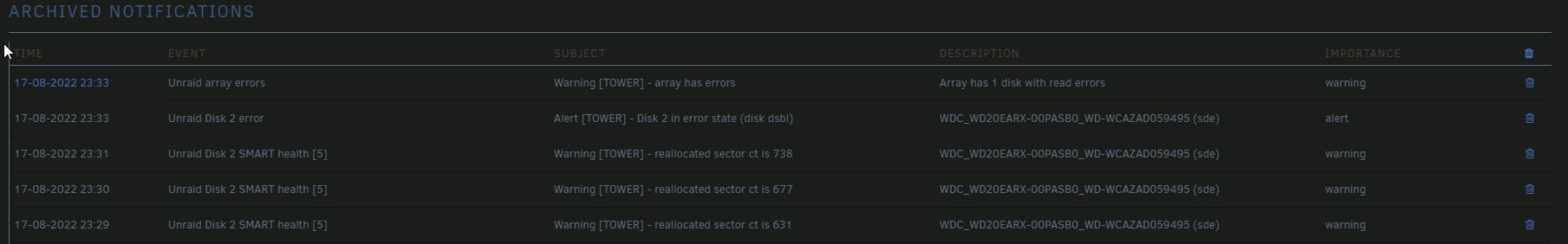

@trurl
Not sure if this helps, I picked it up.
