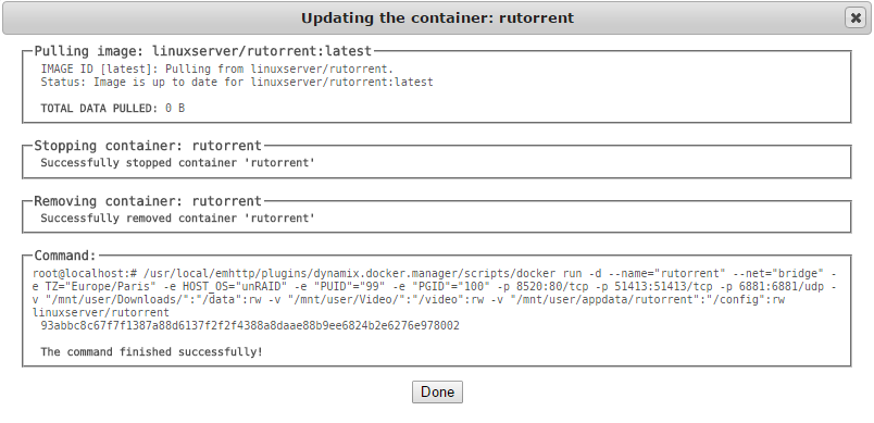

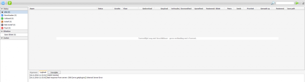

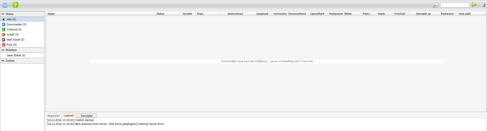

  12. Am I the only one who has problems with this since a version or two when I updated the container a couple of weeks ago I saw an empty rutorrent with this error message "Bad response from server: (500 [error,getplugins]) Internal Server Error" It seems like It can't connect to rtorrent and load the pluggins nor the torrents. Also afther a couple of hours running this my docker img fills up. I tried deleting the docker img but it didn't help. Can this be fixed without me losing my torrents?
