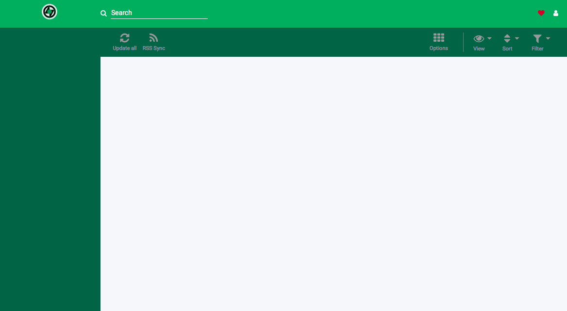

  2. Ok, installed, mapped and the logs look good but there's no left nav and the top nav buttons are greyed out and not useable. Not even sure where to start with this one.
  3. Awesome... it worked. Thank you
