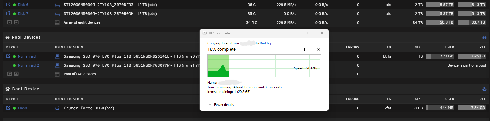

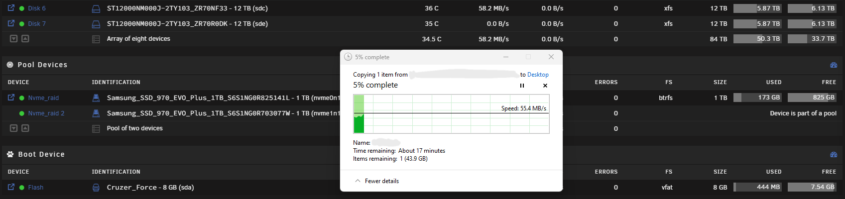

  2. I am still facing the issue where read speed from the server is weird. These 2 file is located in the same share same disk (disk6). Docker and VM is disabled to ensure nothing is affect the result. both transfer is a single large file. I repeated this test and keep getting this result. How does data from the same drive same share transfer at different speed over the network? Transferring 20+GB file to my workstation desktop which is on NVME Transferring 40+GB file to my workstation desktop which is on NVME tower-diagnostics-20230831-0016.zip

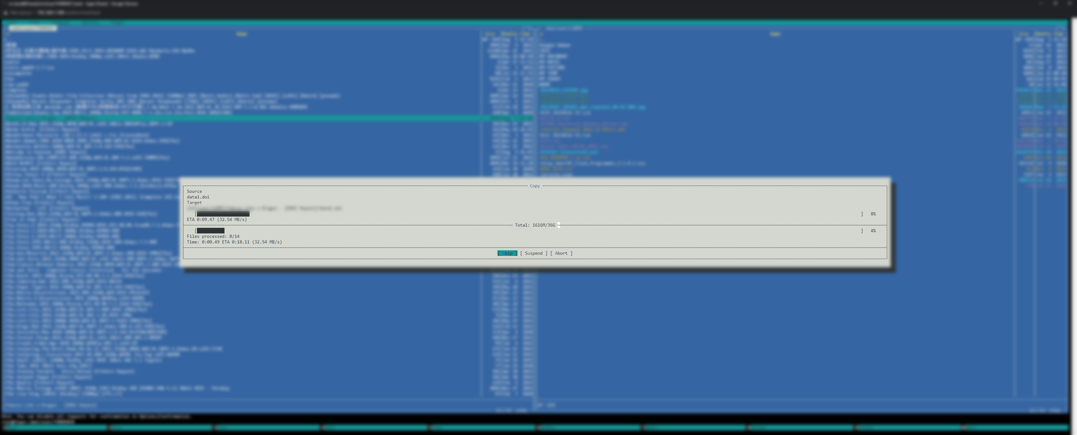

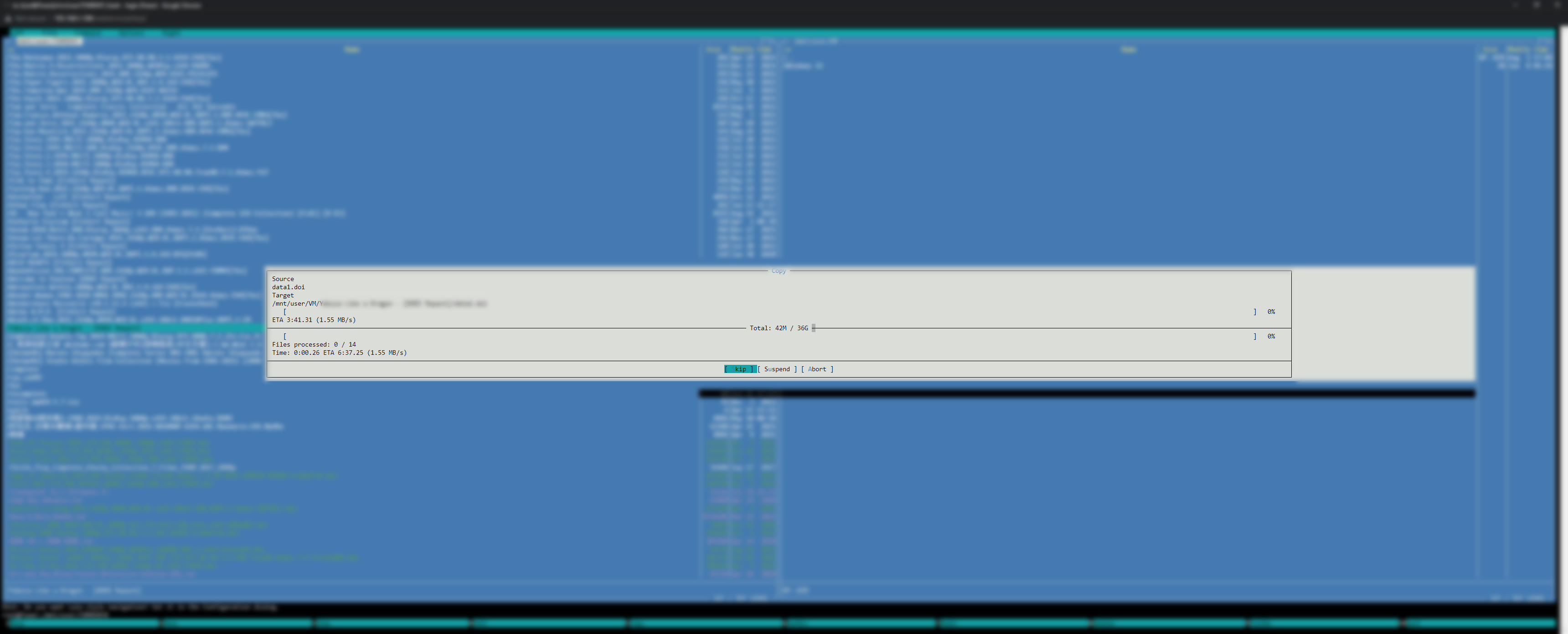

  8. Attach is a screenshot that I transfer file between 2 disks using MC. The speed is at 30+

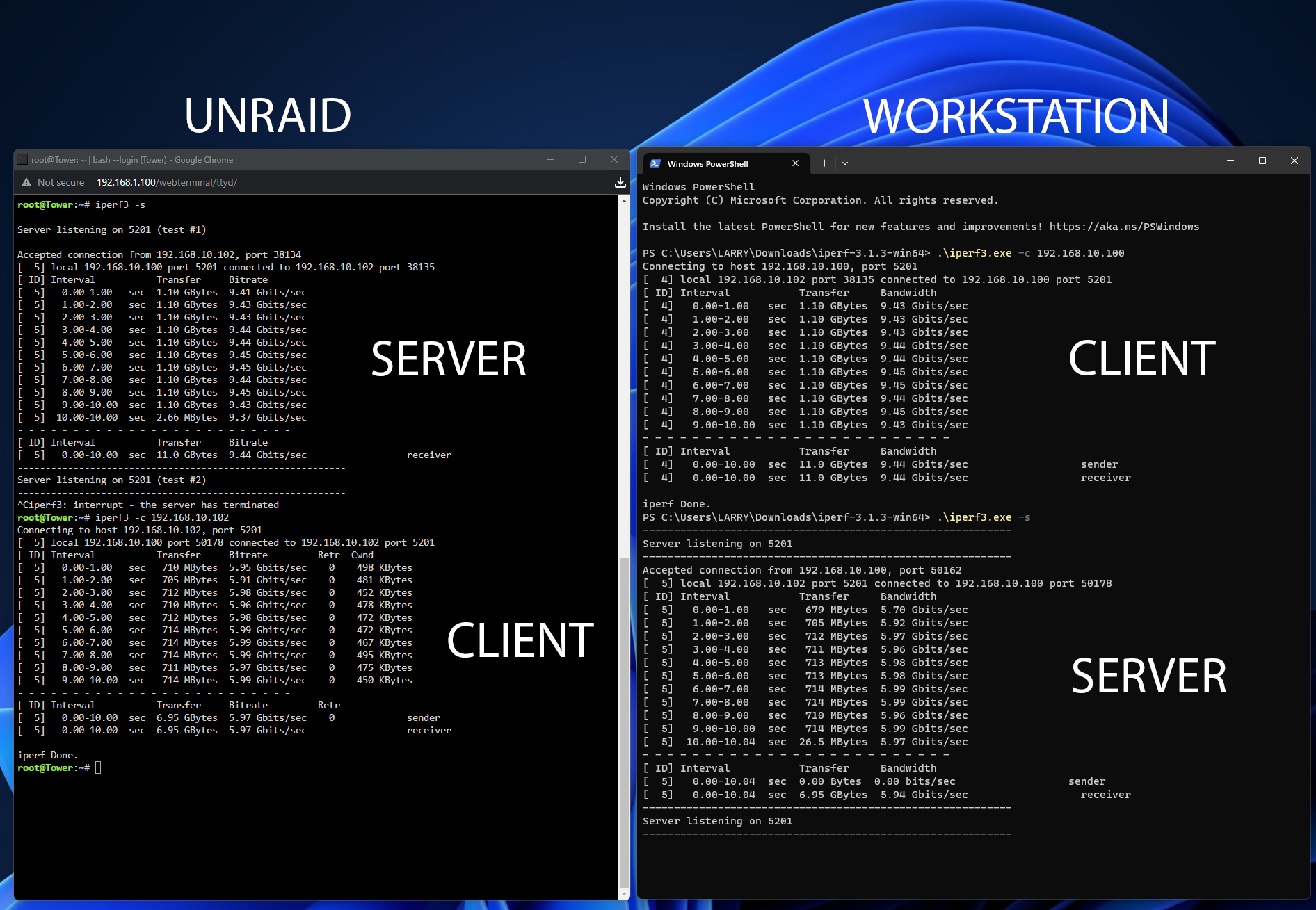

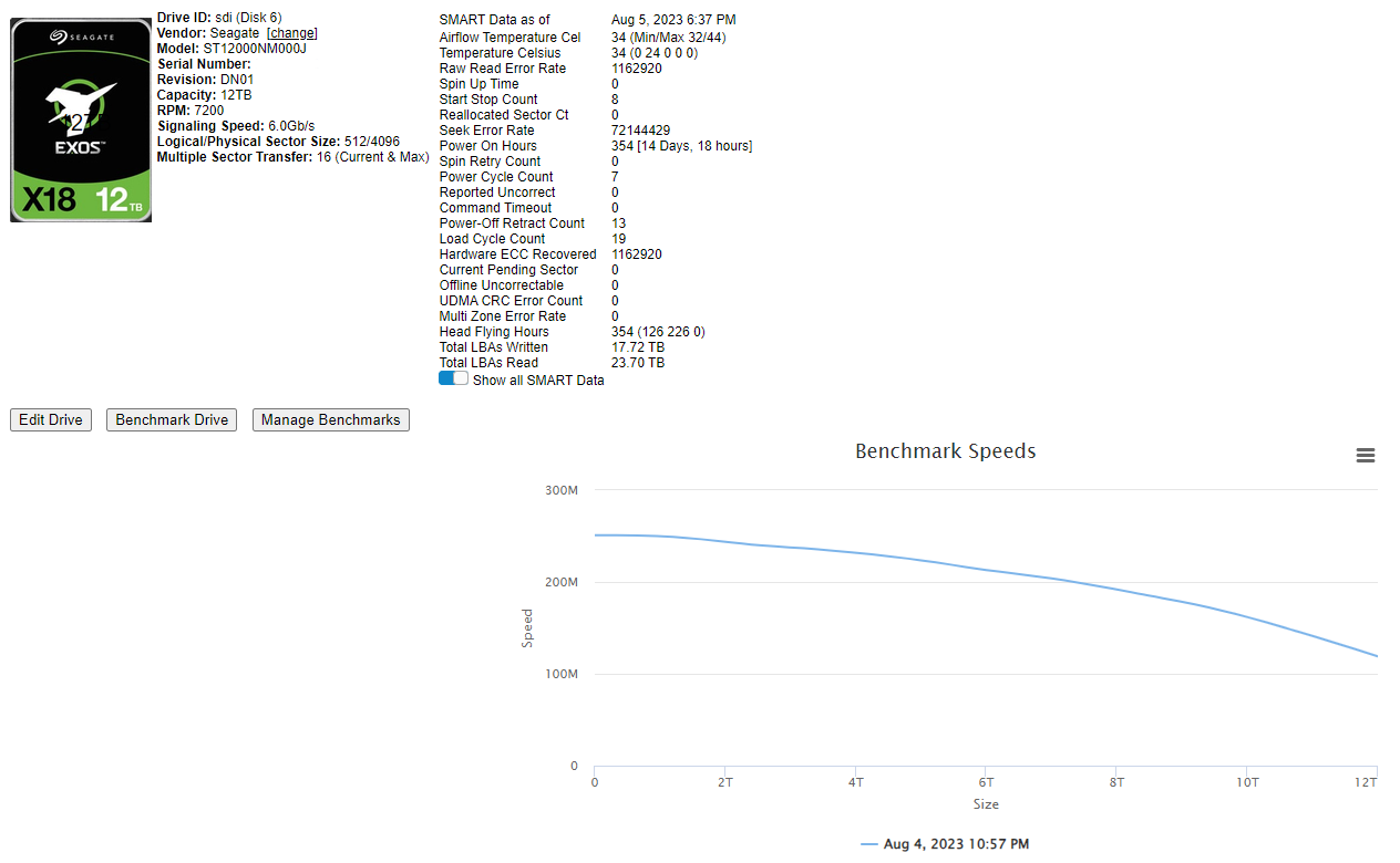

  10. My server use to be able to read and write at about 180-200. Only this few days I notice that when I am copying file from a share to my local workstation, the speed is very inconsistence. Most of the time is about 70-40 and occasionally it will drop to 0. The last hardware modification was to install an HBA card and 2 addition 12TB hard disk. I did some file transfer internally using unbalance to fill up the 2 new hard disk. I have did the following checks and tests but still not able to find out the reason why it is behaving like this. Really appreciate anyone can look into my diagnostics and figure out why this is happening. Run parity check with an avg speed of 183 Test it against 2 different workstation Swap hard disk between onboard SATA controller or SAS breakout iperf in both direction with both workstation and its perfect with 0 retry. SMART Test on all drive and report healthy Stop all docker and VMs Reboot and Shutdown the server Run disk speed and the graph start at 250 and end at 150 tower-diagnostics-20230805-0114.zip
