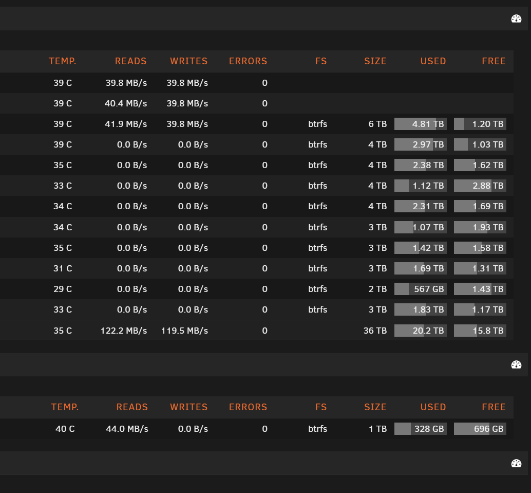

August 5, 20233 yr Author Attach is a screenshot that I transfer file between 2 disks using MC. The speed is at 30+
August 5, 20233 yr Community Expert 6 hours ago, larrytanjj said: Yup I am using the turbo write The diags you posted have turbo write disabled. 1 hour ago, larrytanjj said: Attach is a screenshot that I transfer file between 2 disks using MC Two array disks?
August 5, 20233 yr Author 1 minute ago, JorgeB said: The diags you posted have turbo write disabled. Apologize for the mismatch in the diags. Could be I have be troubleshooting everything I can and got confuse. However I do remember with or without the turbo write should be way fast than 30+ 3 minutes ago, JorgeB said: Two array disks? I did a copy from 1 user share to another user share. Both share is using different array disk. This is to prevent reading and writing to the same array disk
August 5, 20233 yr Community Expert 2 minutes ago, larrytanjj said: Both share is using different array disk. That will always be slow because of the write speed, since parity needs to be updated, try reading from one disk to a cache or unassigned device.
August 5, 20233 yr Community Expert 3 minutes ago, larrytanjj said: Apologize for the mismatch in the diags. Could be I have be troubleshooting everything I can and got confuse. However I do remember with or without the turbo write should be way fast than 30+ Not quite true. A speed of 30-40 MBs is not abnormal if you do not have Turbo Write enabled.
August 5, 20233 yr Author 4 minutes ago, JorgeB said: That will always be slow because of the write speed, since parity needs to be updated, try reading from one disk to a cache or unassigned device. This is the speed when I copy from user share from array disk to a user share which I store my VM which is on NVME.
August 5, 20233 yr Community Expert If those are both in the array then 30-40MB/s is normal, have to live with it. And any other concurrent access to the array will slow it down further.
