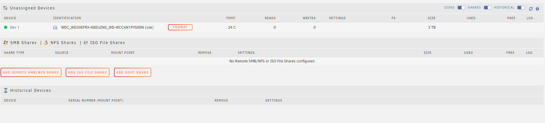

  7. I'm sorry, getting a little lost now. This is the only option I see:

  10. Disk /dev/sdc: 119.24 GiB, 128035676160 bytes, 250069680 sectors Disk model: KINGSTON SVP180S Units: sectors of 1 * 512 = 512 bytes Sector size (logical/physical): 512 bytes / 512 bytes I/O size (minimum/optimal): 512 bytes / 512 bytes Disklabel type: dos Disk identifier: 0x00000000 Device Boot Start End Sectors Size Id Type /dev/sdc1 64 250069679 250069616 119.2G 83 Linux This is the output from the same command on the drive that will not mount: fdisk -l /dev/sde Disk /dev/sde: 2.73 TiB, 3000591900160 bytes, 5860531055 sectors Disk model: WDC WD30EFRX-68E Units: sectors of 1 * 512 = 512 bytes Sector size (logical/physical): 512 bytes / 4096 bytes I/O size (minimum/optimal): 4096 bytes / 4096 bytes Disklabel type: dos Disk identifier: 0x00000000 Device Boot Start End Sectors Size Id Type /dev/sde1 1 4294967295 4294967295 2T ee GPT Partition 1 does not start on physical sector boundary.
