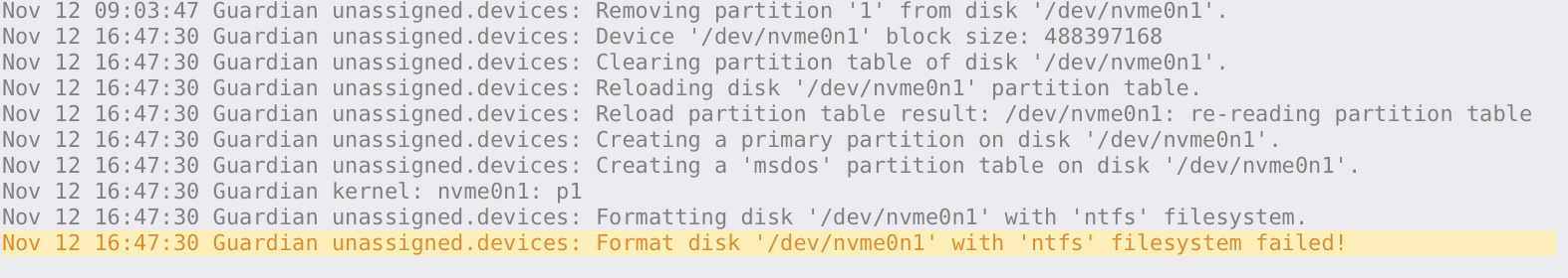

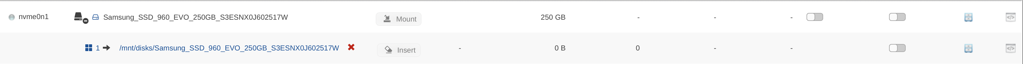

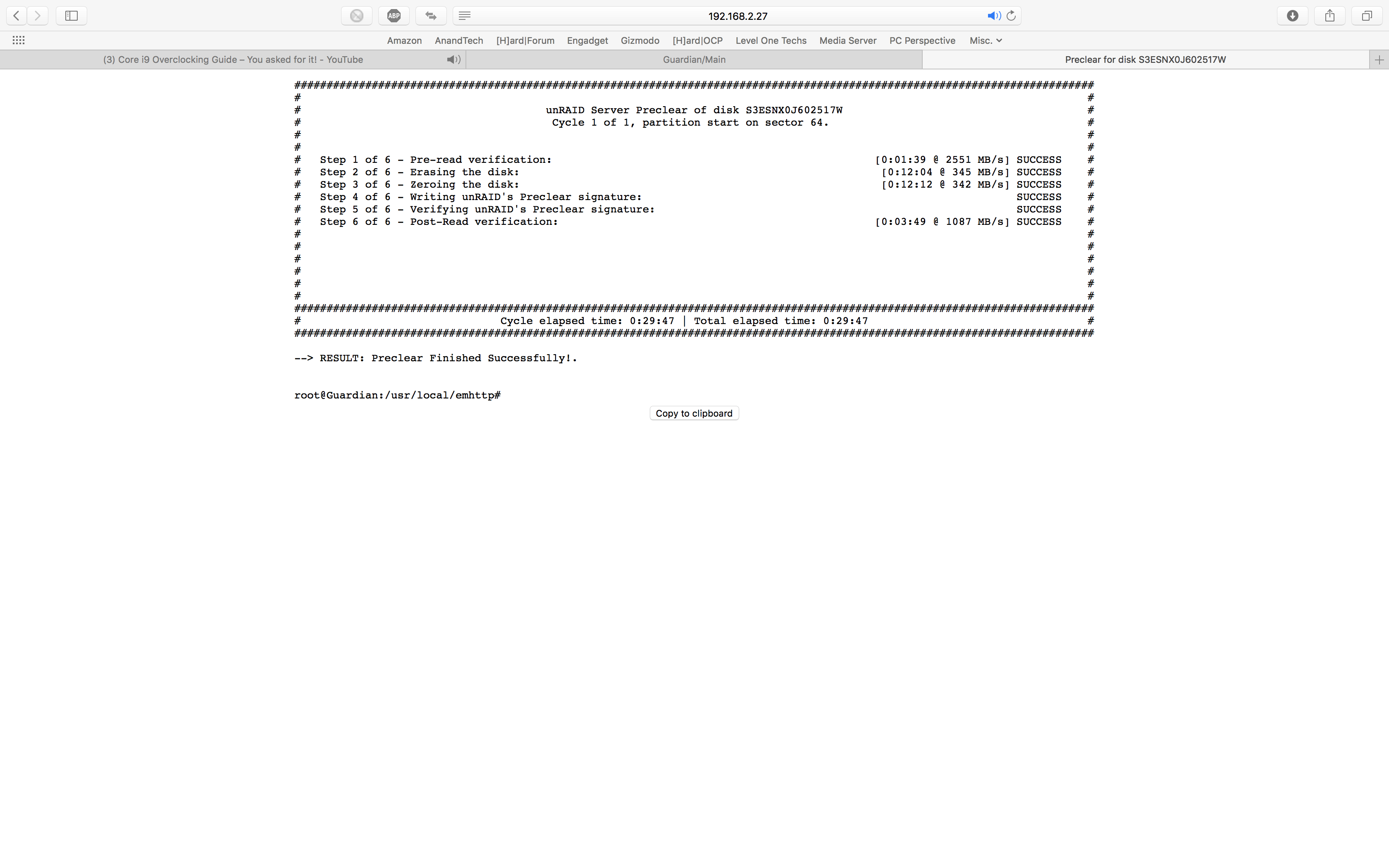

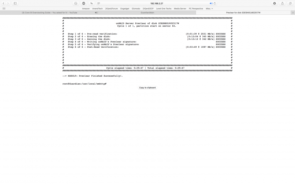

The disk preclears fine. I installed the disk in a windows machine and formatted it to NTFS. At that point I am allowed to click the mount button though it doesn't seem like that actually mounts the disk. I am unable to change the path of the disk or use it for anything. The disk isn't new, it was used for a previous windows install.
- Unassigned Devices - Managing Disk Drives and Remote Shares Outside of The Unraid Array
There ya go! guardian-diagnostics-20171112-0902.zip- Unassigned Devices - Managing Disk Drives and Remote Shares Outside of The Unraid Array
I’ve tried XFS and NTFS to no avail as well - so what do I do?- Unassigned Devices - Managing Disk Drives and Remote Shares Outside of The Unraid Array
Ok so I’m having some trouble formatting an NVME drive. When I try to do so I get a “Format Failed...” error and am unable to mount the drive. the log log just says this: Format disk '/dev/nvme0n1' with 'btrfs' filesystem failed! Any ideas? I’m on the latest version of unraid with a Ryzen system.- [Support] binhex - DelugeVPN
