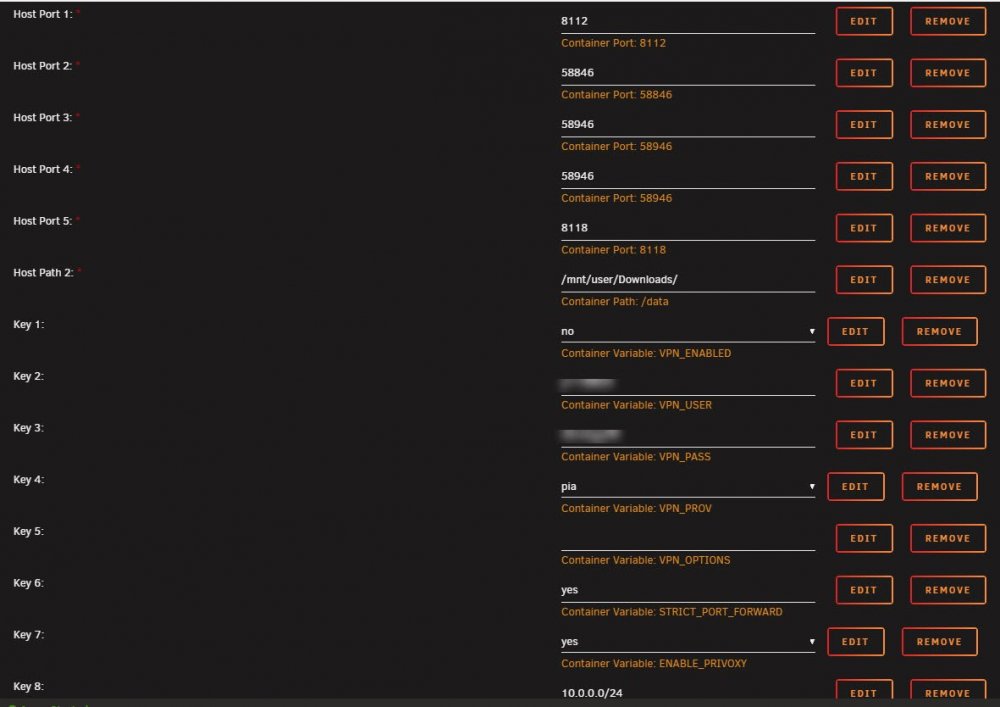

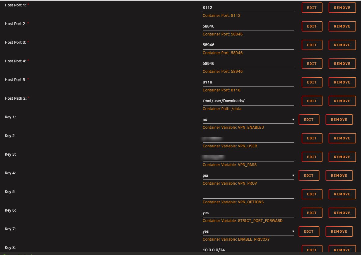

  3. I woke up this morning and Sonarr, Radarr, Lidarr lost connectivity to their indexers. Yesterday I upgraded my modem to Arris SB8200 and did not touch any router settings. Currently, my docker containers route through delugeVPN using PIA for NZB only (which all worked for many months until today). I was able to remedy the connection issue by setting VPN_ENABLED = no in the deluge settings. The only changes made to my setting or network is the new modem which uses docsis 3.1 Can't think of a reason why a new router would cause the VPN feature to stop working. I am running an old version of Unraid 6.6.7. Can't seem to upgrade successfully with my build. But, again this has been my setup for a very long time without issue. All dockers are up to date. I have attached my deluge settings and the sonarr log when trying to test the connection to an indexer. I'm not sure which logs would be most valuable. Any help is appreciated. Thanks! **** Just Read All the Posts **** sonarr.txt

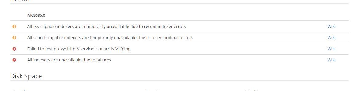

  5. Hey guys. I'm running Unraid 6.4.0. I use eweka.nl and have DOGnzb, Nzb.su, and NZBgeek for indexers. I recently changed from binhex-sabnzbd to the binhex-sabnzbdvpn docker and use PIA as my VPN provider. Everything worked at the onset, but after a day all of my indexers for sonarr, lidarr and radarr were disconnected. at any time I'm able to click on them and run a connection test and they all would validate and connect. But, eventually they all lose the connection again. It seems like after so many requests to the indexers, they're making me validate again. I disabled the vpn and everything works perfectly. It feels like the provider doesn't like getting requests from whatever IP the vpn is serving me. Maybe a security measure. The logs to sonarr, lidarr and radarr just state that the indexers are unavailable and sonarr gives "Failed to test proxy: http://services.sonarr.tv/v1ping". I didn't see the sabnzbdvpn logs while the error was happening and in my troubleshooting of turning off the vpn the logs have cycled through. I didn't see anything about this searching the web and forums, but I have to imagine it's happened before. Any help is appreciated. Thanks.

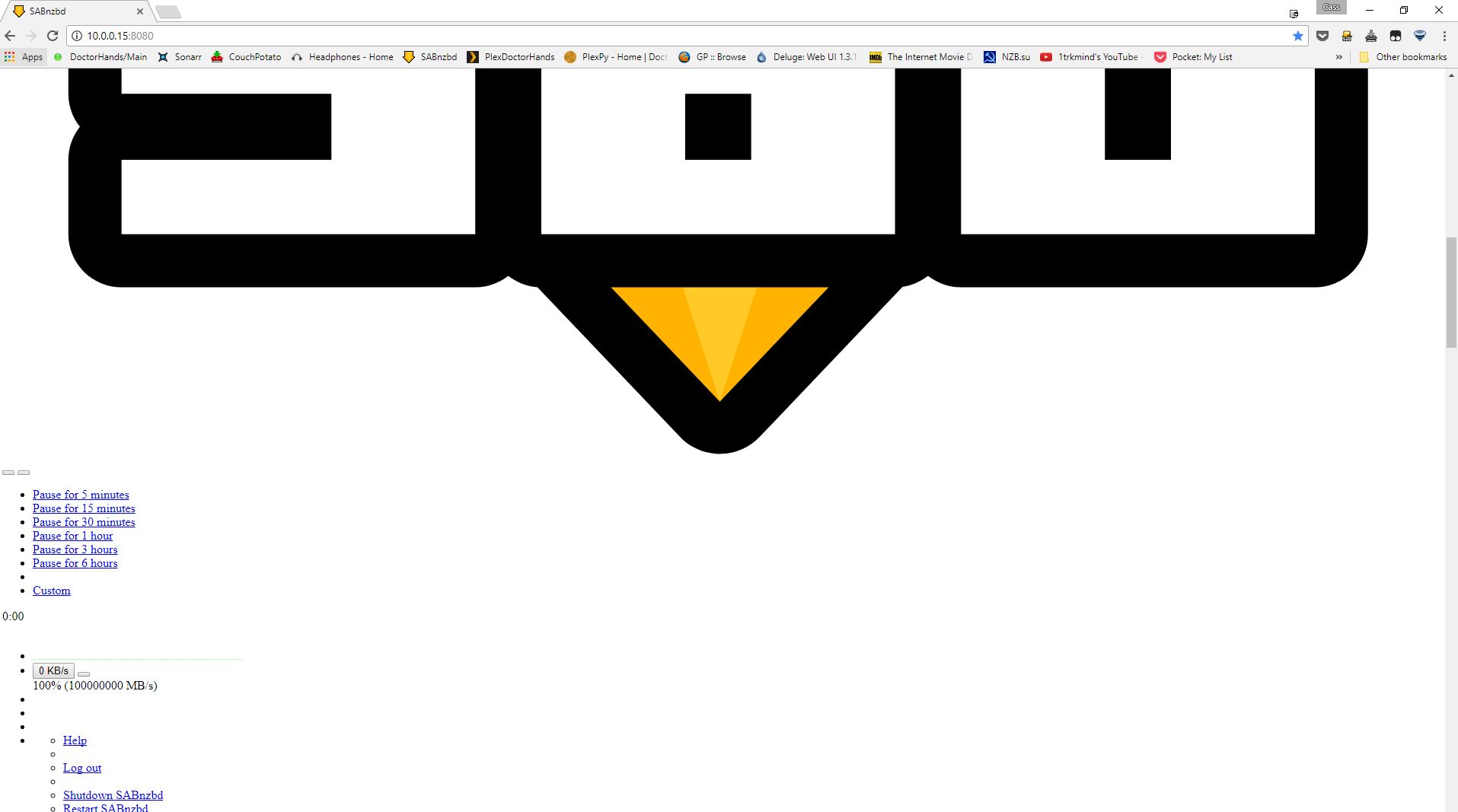

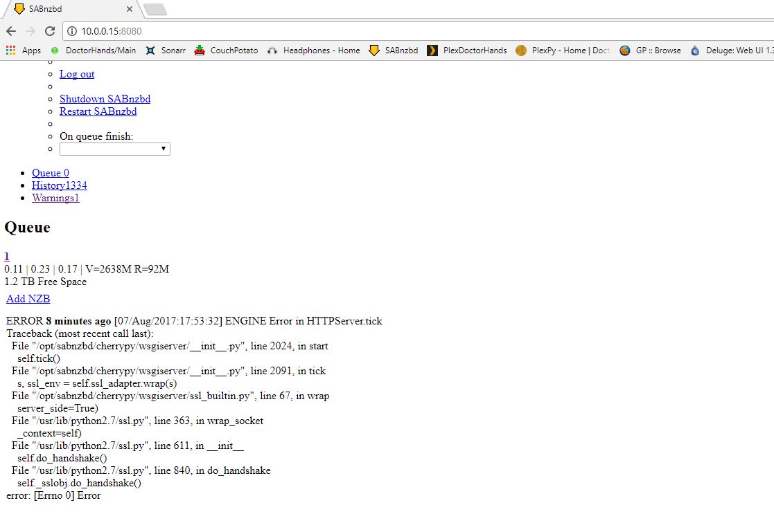

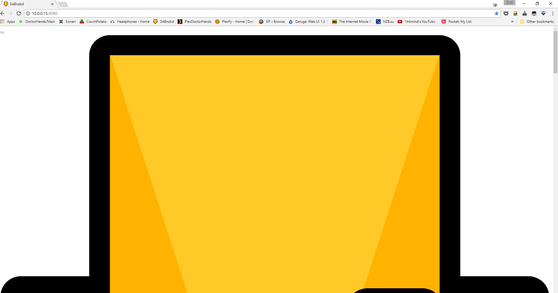

  6. @SoAvenger Thanks for getting the fix and detailed explanation up so quickly! I had the same issue, same fix.
