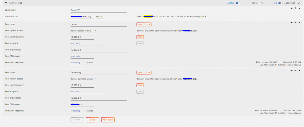

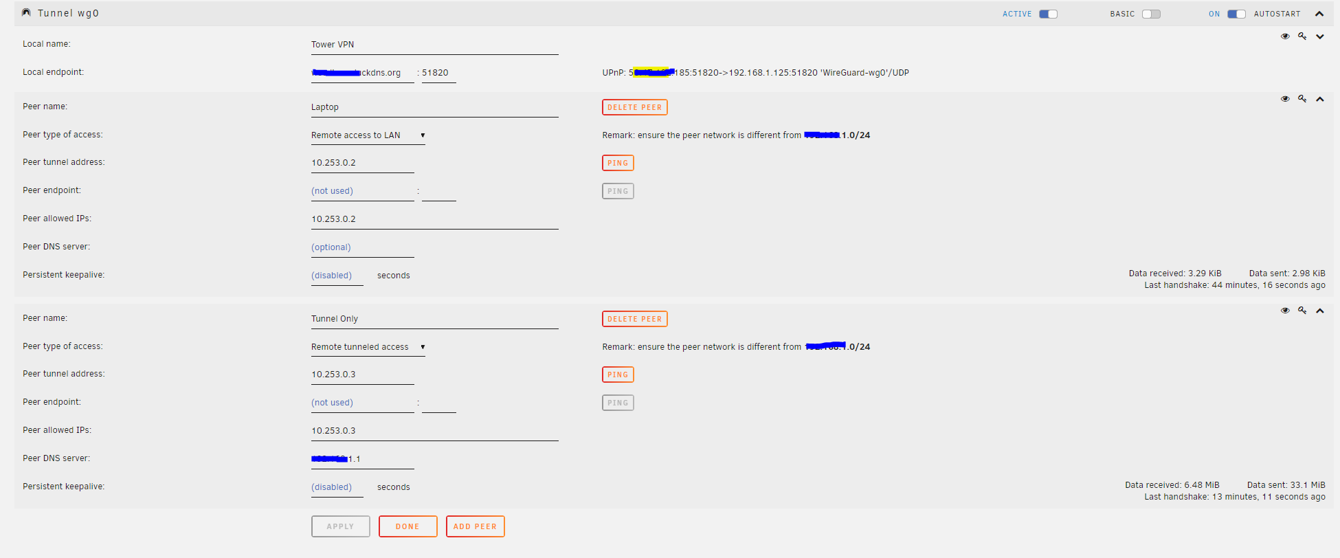

  1. As the post says I followed this guide to set up the Wireguard and it works as intended, when outside my home network when I activate the VPN my IP address is changed to my home IP address. As far as I am aware this means it works. However, if I try to access the server UI or any of the containers it just doesnt connect. This make sense as I have it set to remote tunneled access which means it cant assess the local network. I then tried to make a second peer this time set to remote access to LAN but now it does not connect. Not sure what setting to check or where to go. The whole reason I wanted this was so that I could manage my containers remotely. Here is my set up, the top one called Laptop is the that does not work and the Tunnel Only does. The only difference is that I can see is the working one has a peer DNS server set to host subnet but I don't think that is needed for the other to work. I have also tried following the guide posted here and the config looks the same so I don't know what is wrong.

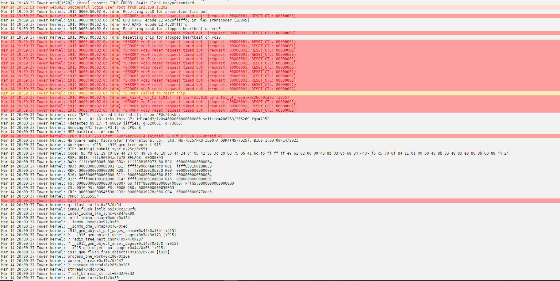

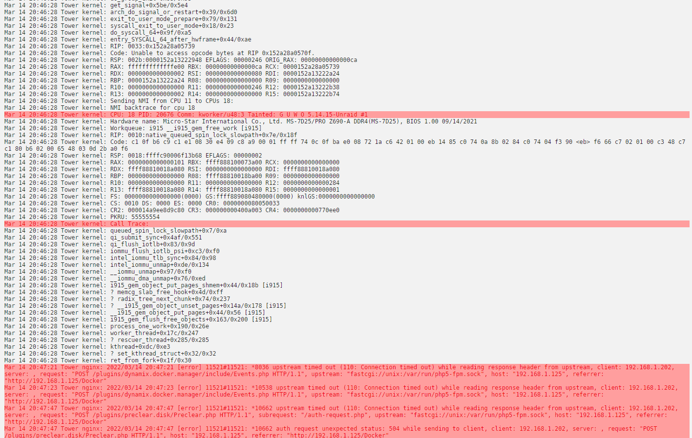

  3. Yeah, not sure if you got a chance too see my post with the error logs but what happens is it starts to transcode and works fine for a few minutes then the igpu dashboard shows it stuck at 100% and the whole server becomes unresponsive. The CPU also starts going to 100% core by core according to the dashboard widget.
  4. Is there something particular one should look at/for to know if iGPU support for UHD 770 transcode has been added. I understand it takes time and then even more time to be added to Unraid. For example if I look at a site for the release note of 15.15 I dont really understand what I am looking at, where would I look in the release notes of 15.16 or any Linux kernel release notes to know if support has been added. https://www.linuxcompatible.org/story/linux-kernel-51527-released/ https://git.kernel.org/pub/scm/linux/kernel/git/stable/linux.git/diff/?id=v5.15.27&id2=v5.15.26&dt=2 Right now I am just waiting for support which is fine but would like to know how to check if support has been added. I do see under the 15.15 ther are number of drivers/gpu/drm/i915 would that be what I would look for in a 15.16 more of them? Thanks
  5. Here is a current diagnostic file tower-diagnostics-20220318-1330.zip

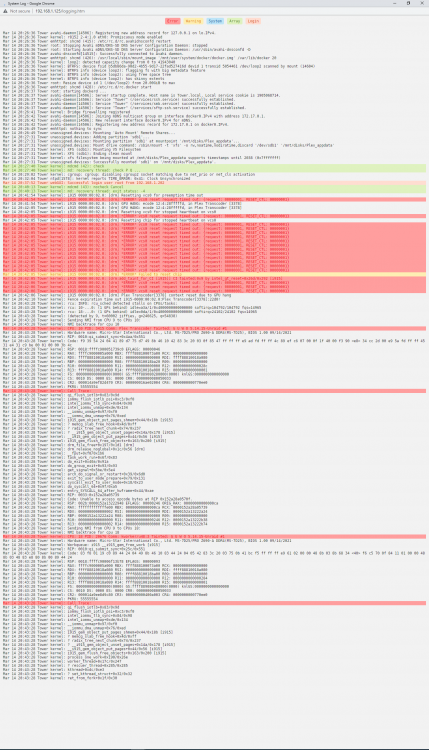

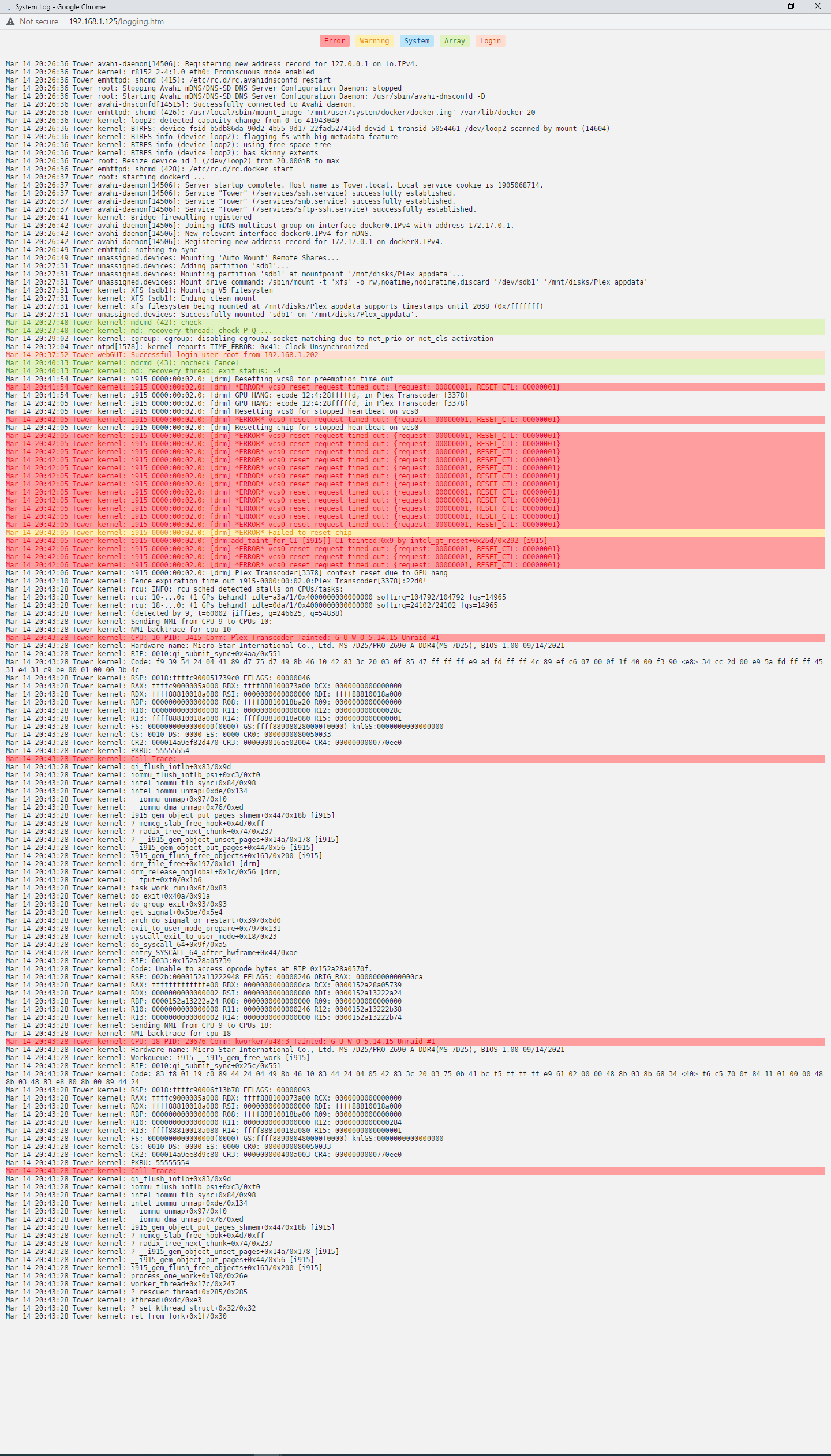

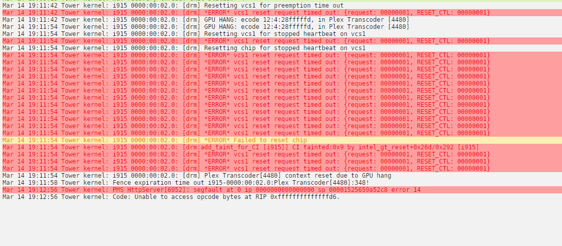

  7. So I tried these steps and got hw transcoding working for about 10 min then it crashed and hung the entire server. Can someone help make sense of the crash logs. I have google to no luck at least with anything that makes sense to me. tower-diagnostics-20220314-2015.zip syslog
