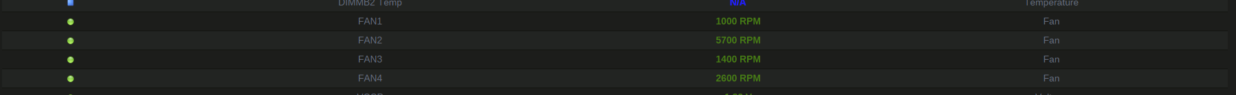

  1. I cannot see a FANA section, only FAN1234. My FAN4 sensor is showing up as FAN4 and not FANA, even though the motherboard manual says it should. On my old board, I know FAN4 did show up as FANA and I did see the section under the Fan Control tab. Though I haven't used the fan control functionality of your plugin at the time. Is there any way for me to override this and have FAN4 be treated as FANA? Here is what shows up at the sensor readings. As you can see, it clearly says 'FAN4'. At that point I have manually changed the duty cycle of the peripheral zone to 24 (<50%). Here is what happens once I set it to 64 (100%): All the fans attached to FAN4 are spinning twice as fast while the other fans speeds are unchanged. I think it's just the sensor name "FAN4" that is preventing it from being recognized as being part of a separate cooling zone.
  2. Hi, I have a shiny new SuperMicro X10SDV-TLN4F board. The PCB is revision 2.00 so it has fan header FAN4. According the motherboard manuel this one is supposed to show up as FANA in IPMI but this is not the case. The previous board I'm replacing is the SuperMicro X10SDV-4C-TLN4F board. Also revision 2.00 and there FAN4 did show up as FANA in IPMI. Updating the BIOS and BMC to the latest version did not magically fix this problem. I've confirmed with IPMI raw commands that FAN4 is indeed on a separate cooling zone. Changing the duty of cycle of the peripheral zone slowed down only the fans attached to FAN4. Yet this plugin still lumps it together with the other fans under FAN1234, probably because of the sensor name. Is there any way I can get the plugin to configure FAN4 on a separate cooling zone? Or do I just have a faulty board? Thanks
