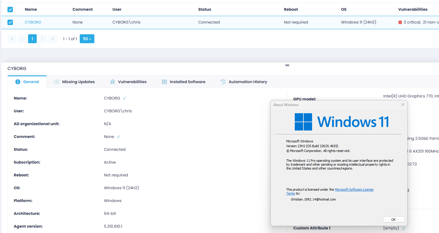

  1. The answer was SMB signing thank you! Check this out, my RMM software shows my device on Windows 11 24H2 When using "Winver" command it shows Version 23H2. No idea why Action1 shows my device as Win 11 24H2 and Winver shows different but I did reboot and ran commands again with same results.

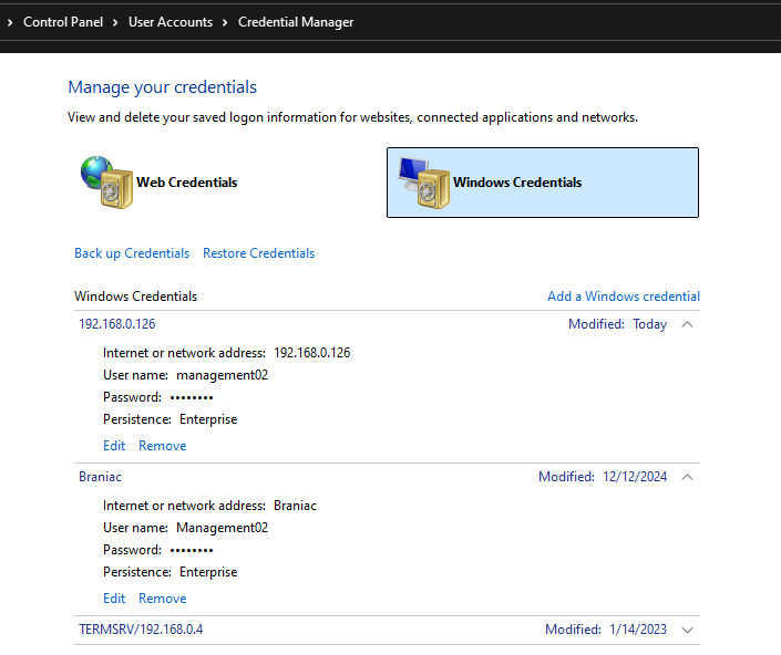

  2. Hello, Windows 11 23H2 OS Build 22635.4655 Logged in using Microsoft account. I just cant seem to connect from explorer to my unraid server. I can ping it, but port 445 is not open. I am so frustrated that I am hoping someone can help me narrow and organize this troubleshooting process. I am unable to connect using a laptop or my desktop. So two different computers. PS C:\Users\chris>whoami cyborg\chris PS C:\Users\chris> Get-NetConnectionProfile Name : Superman InterfaceAlias : Ethernet InterfaceIndex : 7 NetworkCategory : Private DomainAuthenticationKind : None IPv4Connectivity : Internet IPv6Connectivity : NoTraffic PS C:\Users\chris> ping 192.168.0.126 Pinging 192.168.0.126 with 32 bytes of data: Reply from 192.168.0.126: bytes=32 time<1ms TTL=64 Reply from 192.168.0.126: bytes=32 time<1ms TTL=64 Reply from 192.168.0.126: bytes=32 time<1ms TTL=64 Reply from 192.168.0.126: bytes=32 time<1ms TTL=64 PS C:\Users\chris> ping braniac Pinging braniac [192.168.0.126] with 32 bytes of data: Reply from 192.168.0.126: bytes=32 time<1ms TTL=64 Reply from 192.168.0.126: bytes=32 time<1ms TTL=64 Reply from 192.168.0.126: bytes=32 time<1ms TTL=64 Reply from 192.168.0.126: bytes=32 time<1ms TTL=64 PS C:\Users\chris> Test-NetConnection 192.168.0.126 -Port 445 WARNING: TCP connect to (192.168.0.126 : 445) failed ComputerName : 192.168.0.126 RemoteAddress : 192.168.0.126 RemotePort : 445 InterfaceAlias : Ethernet SourceAddress : 192.168.0.40 PingSucceeded : True PingReplyDetails (RTT) : 0 ms TcpTestSucceeded : False
